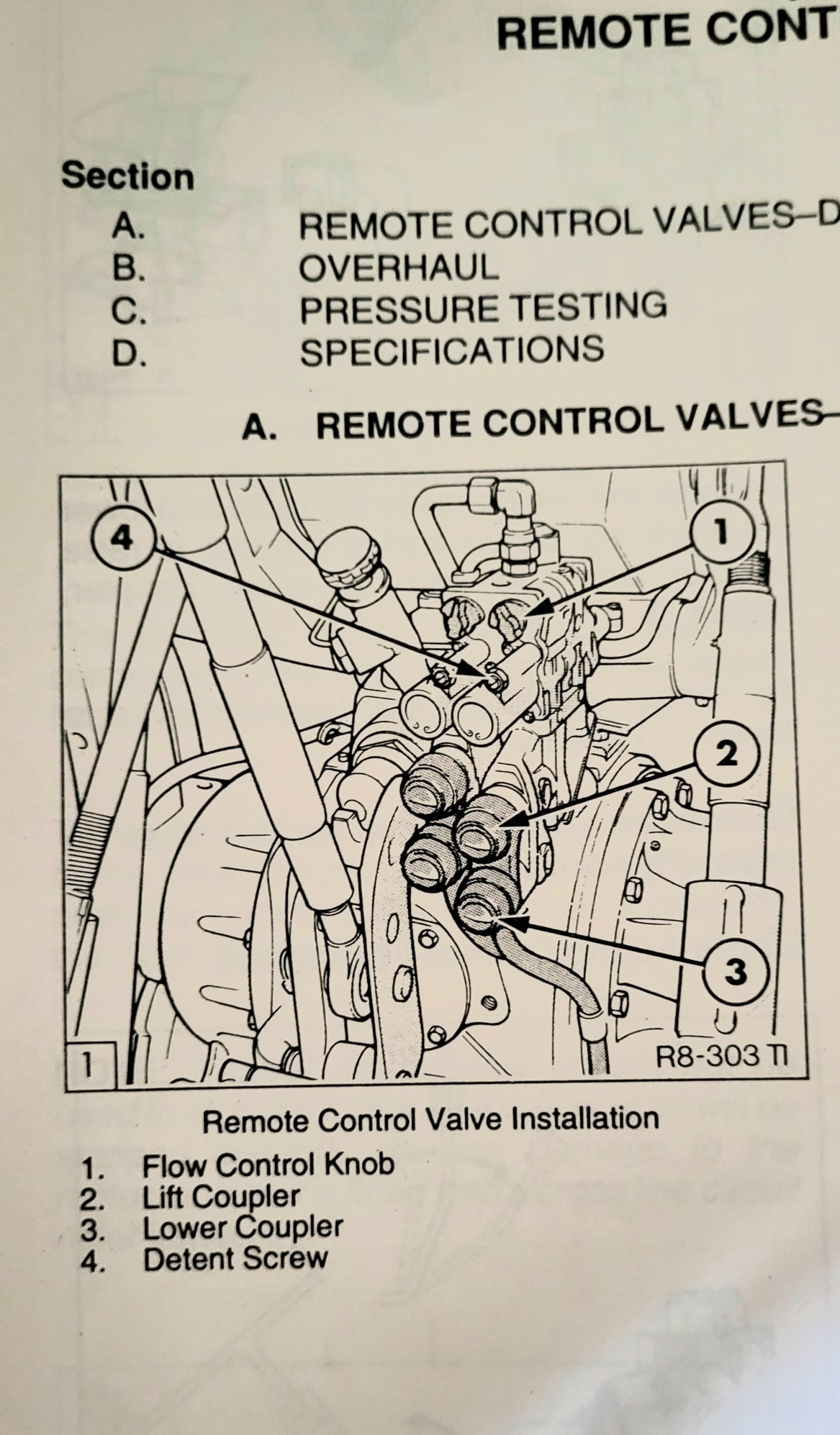

Those screws with jam nuts are for the detent adjustment on the remote valves.

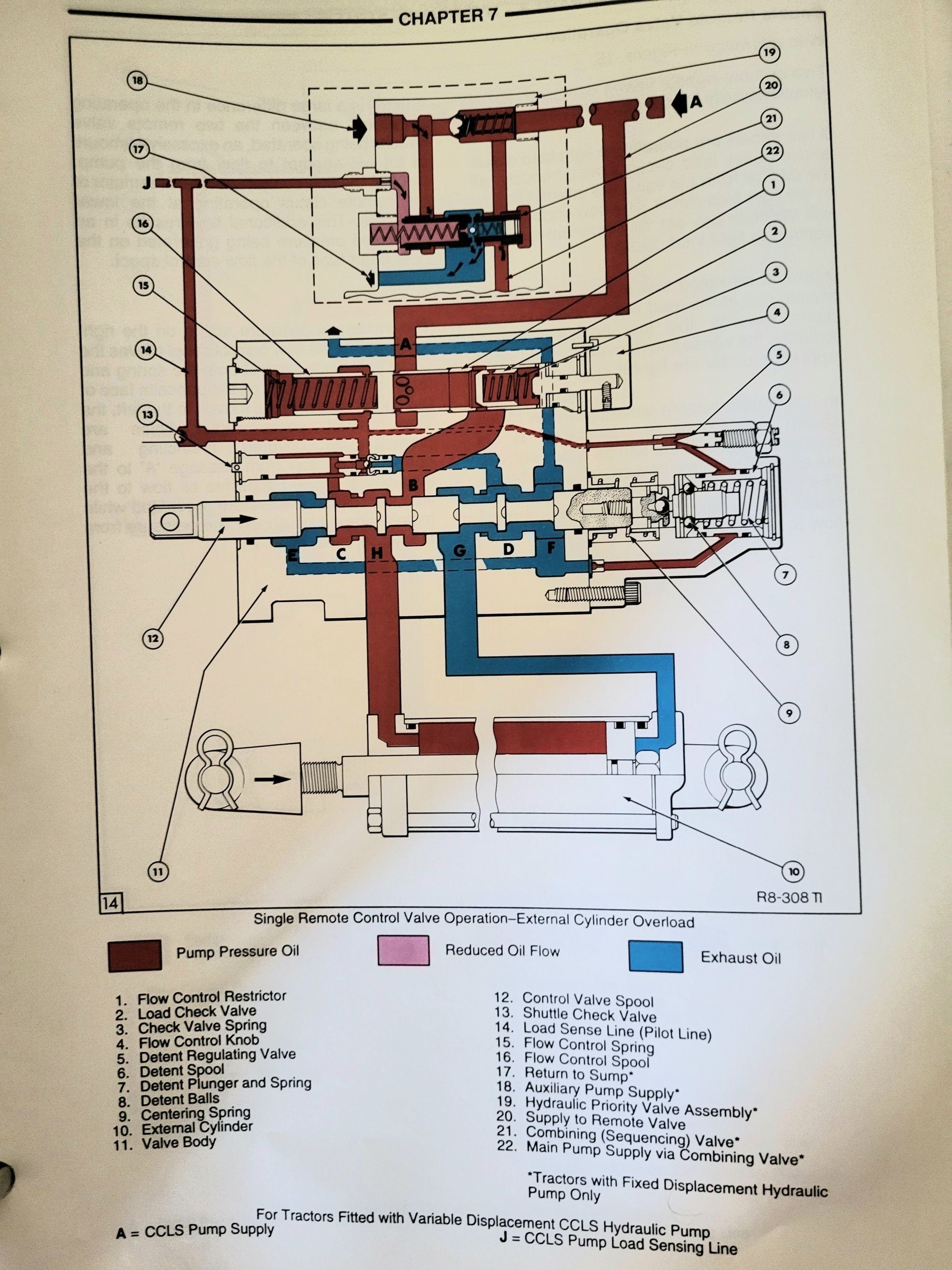

In your first post the adjusters shown (pic #6) are your flow adjusters. At least the number one control is set to the absolute minimum flow rate. Until you can get those freed up and adjusting you will not get increased flow rates from your valves.
To check your flow rates attach an open hose to one remote connection and direct it into a 5 gallon bucket, securely hold onto the hose and have someone actuate the control to get flow from that port it may splash quite a bit. Switch the hose to the other port for that valve and repeat while moving the control handle the other way.
You have more then adequate flow available your restrictors are set to minimum flow open them up and it will be fine.

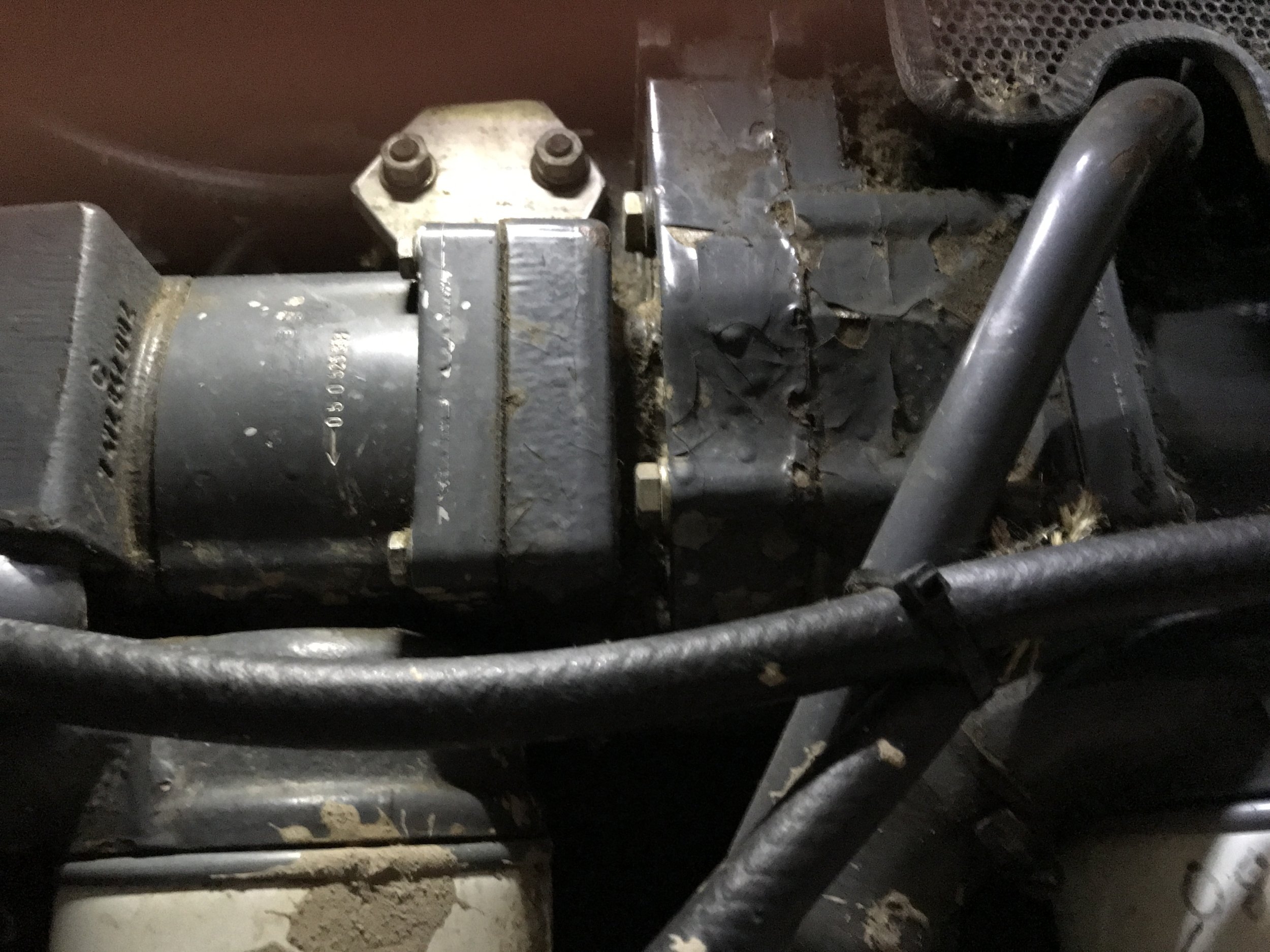

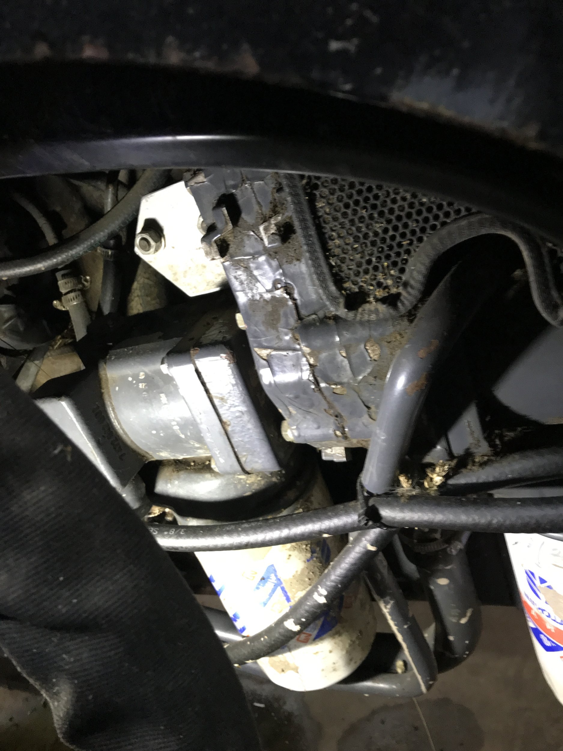

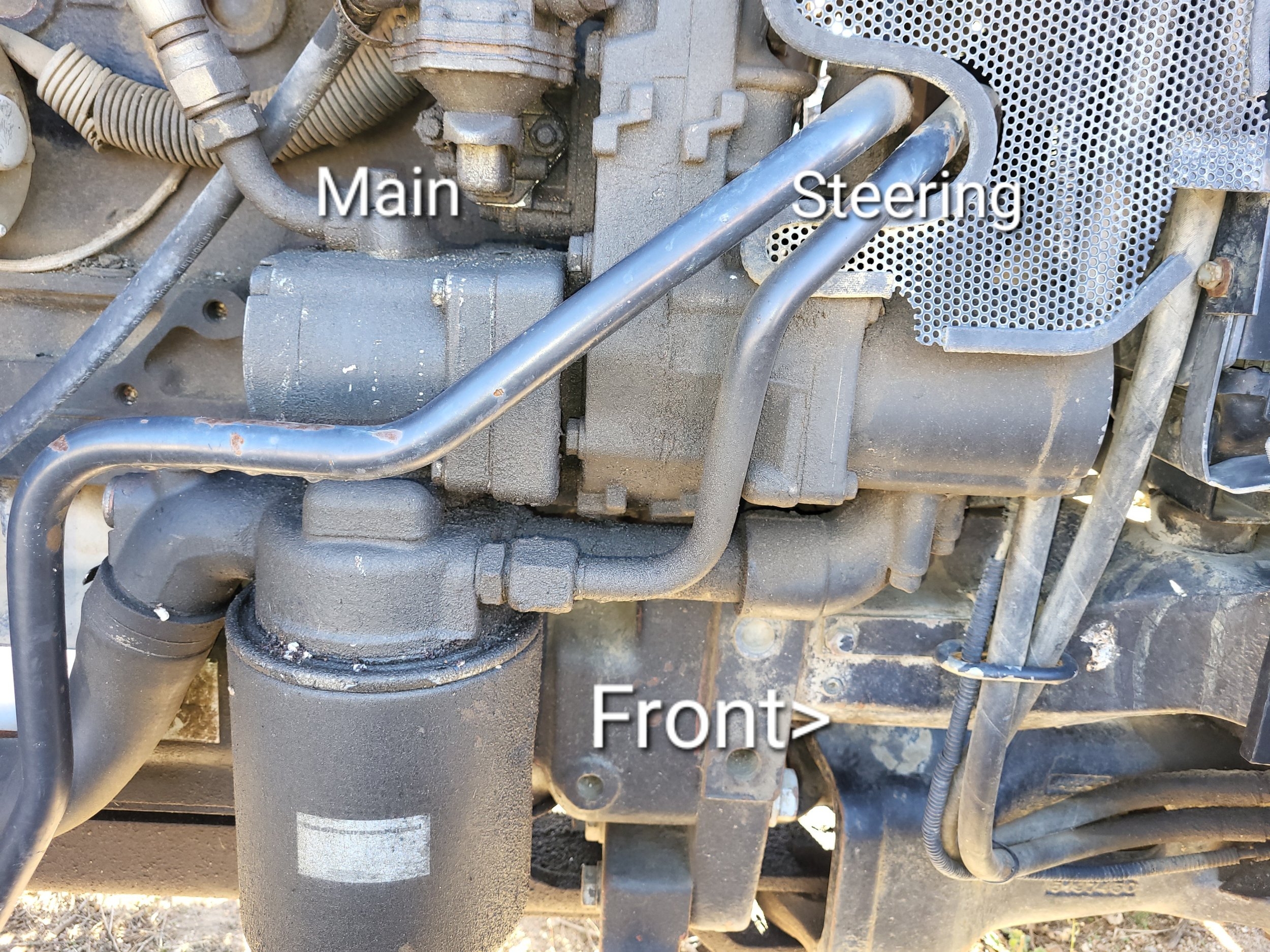

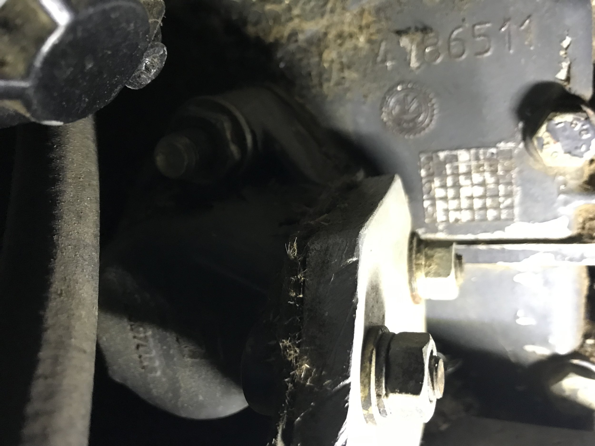

I took some pics of the pumps. I tried to find them in parts list but no luck. The one closest to the front looks like the biger pump based on apperance and line size. But every line heads to rear of tractor. I know they have to somehow connect to power steering. Some numbers visible but can't match to any part online. This TL70 is suppose to be a Delux and could have a bigger pump. It came with a factory loader. The frame on it blocks acess to a lot of parts. The loader and 3-point works fine and fast.
Thanks to all for your help.

I remember now I purchased the service manual. Howerver it appears this tractor can only operate a single acting cylinder. I only found one part made refrence to a double acting valve, but still does not show high pressure fluid going in both directions to cylinder. Almost looks like you connect high pressure from two different remote valves. Not sure it that's even safe to do. Has 4 pages (single acting)and drawings showing all four positions of control handle. I attached three pages from manual instructions

The following are pages from the 40 Series Fords that show the remotes mounted at the rear. This is what you have on the TL, but your valve body is mounted under the cab. The instructions and diagrams are clearer in the 40 Series manual than those on the TL.
Last picture shows the pumps off of a TN. Yours are the same with the exception of the hydraulic filter. Yours has a filter on each pump.
