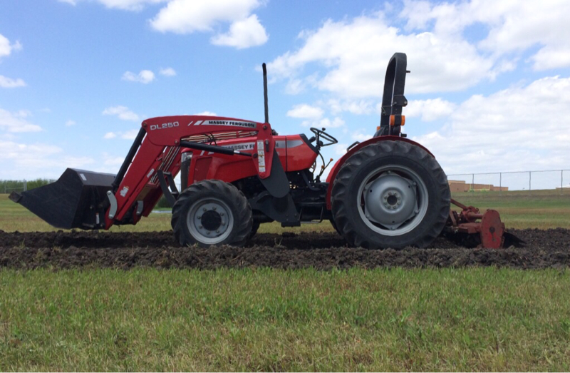

I'm considering upgrading to a larger tractor. And really like the simple ruggedness of the 2605
But I can't believe it doesn't have a differential lock on that size! I am getting 4x4 but I really believe I need the diff lock, I've used mine many times.
Can someone recommend an alternative to the 2605 that has the lock?

The 2615 has that option + a few more horses. I have a 2605 4x4 with loader and not sure that the diff lock would be of much help. The tractor weighs enough to have good traction.

The spec sheet says the approximate shipping weight of the 4x4 2605 is just over 4500lbs, so 3 tons seems a reasonable estimate after adding the loader and fluid.
/ Considering a Massey 2605 #5
I've put quite a few hours on my Dad's 2605 4x4 with FEL, it's an impressive tractor. Does excellent job of getting all of its power to the ground. Though it would be nice to have, I haven't really missed having a diff lock on it in 4 wheel drive, traction is very good.
IMO there's a few annoyances with it: I wish it didn't have the fuel filler in the center of the hood, the ignition switch is hard to use due to its design, and it could use a little lower 1st gear for running his 5' tiller but other than that it's been a perfect machine no mechanical issues at all.
