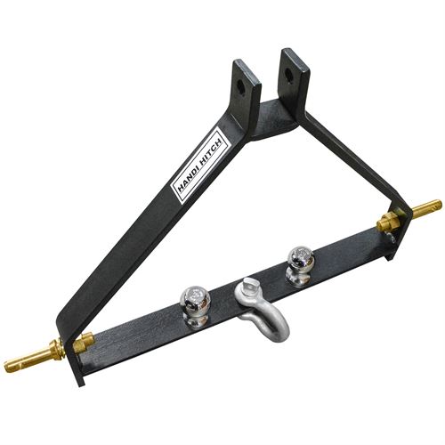

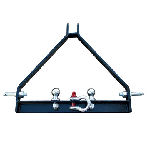

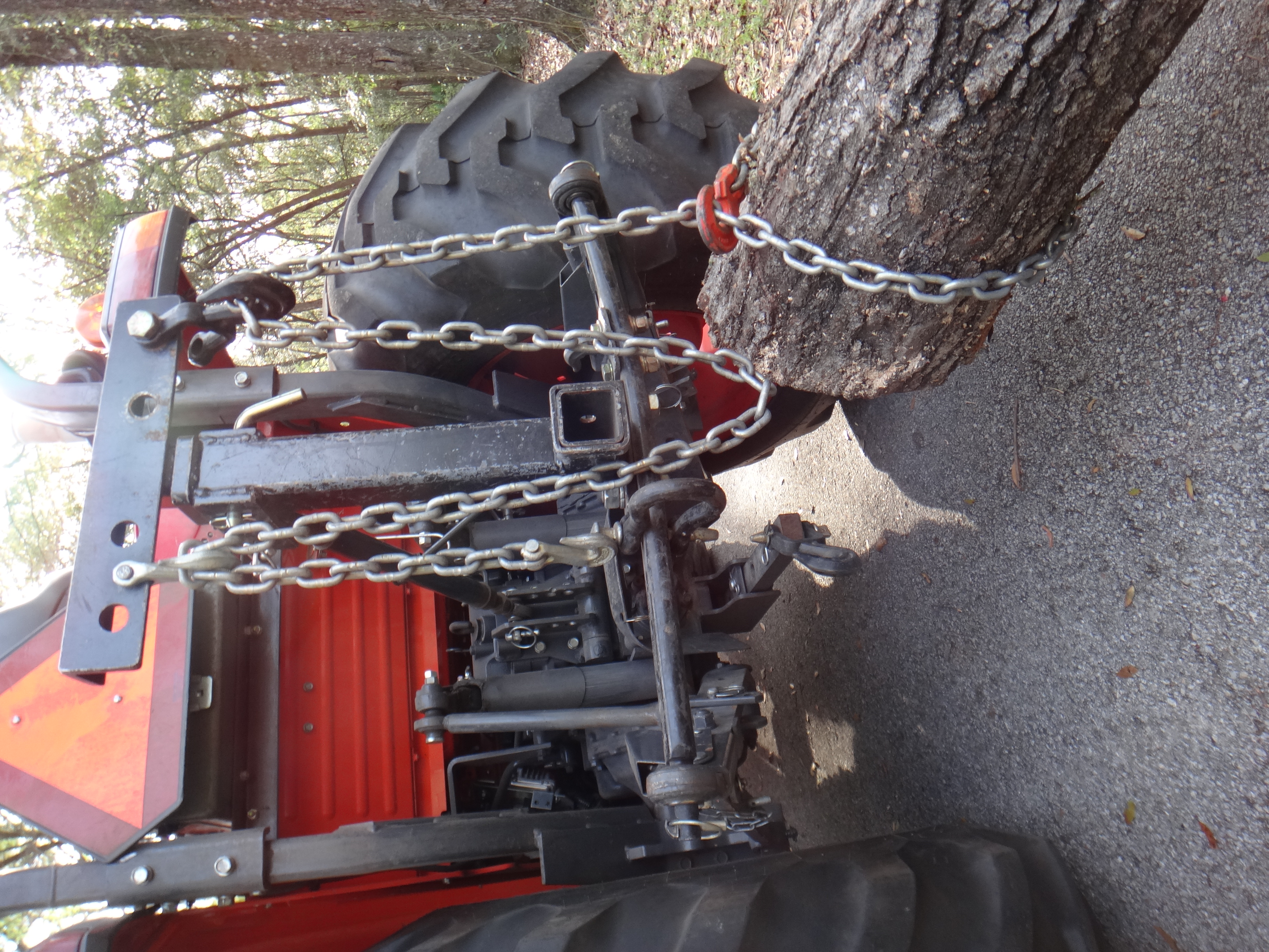

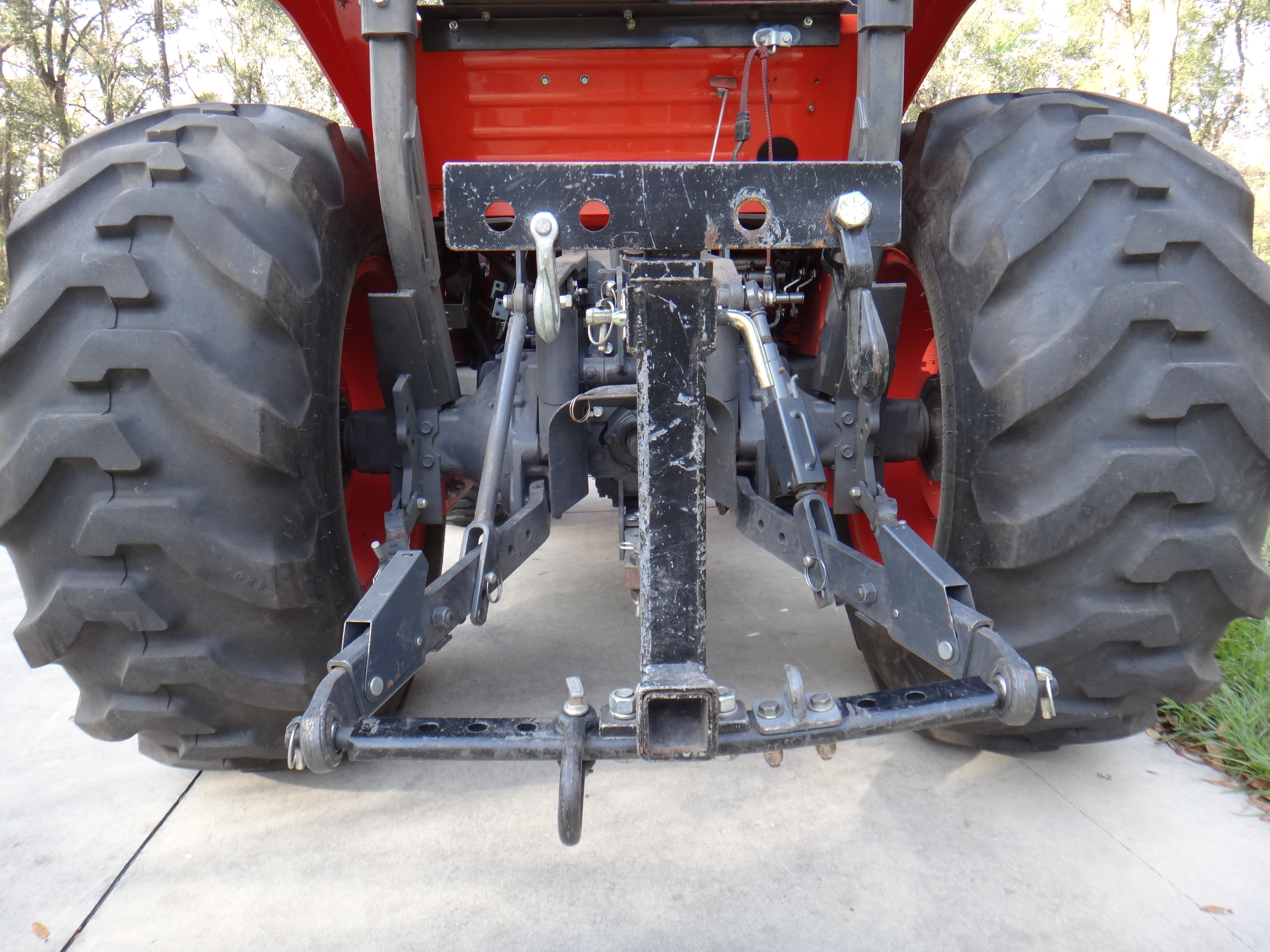

1) For removing rocks and other ground contact work, tractor weight is more important than tractor horsepower. You may wish to consider a Bucket Spade attachment. Photo #1, #2
Consider Dunstan Chestnuts for forest restoration. Mature Chestnuts are large trees.
ChestnutHillTreeFarm
2) Tractors are pulling machines. Tractors are geared low and those large rear wheels are further gearing down.
Even a 1,700 pound tractor can tow 8" diameter timbers. If you will tow timbers on hard surfaces roads, you will need a cross-drawbar to elevate timbers a few inches to prevent abrasion of your tow chain and decrease timber friction against the road. Photos #3 - #6
1) & 3) SCUTS have 7" to 9" ground clearance due to small front wheels.
Heavier tractors are built on larger frames with larger wheels/tires. Heavier tractors with large diameter tires have more tractive power pulling ground contact implements, pushing a loader bucket into dirt and pushing snow. Larger wheels and tires mean more ground clearance, enabling a heavier tractor to bridge holes, ruts and downed tree limbs with less bucking, yielding a less disturbing passage over rough pastures and woodlands.
4) http://www.lsuagcenter.com/~/media/...aa214276e14dacb/pub2917tractorimplements1.pdf
