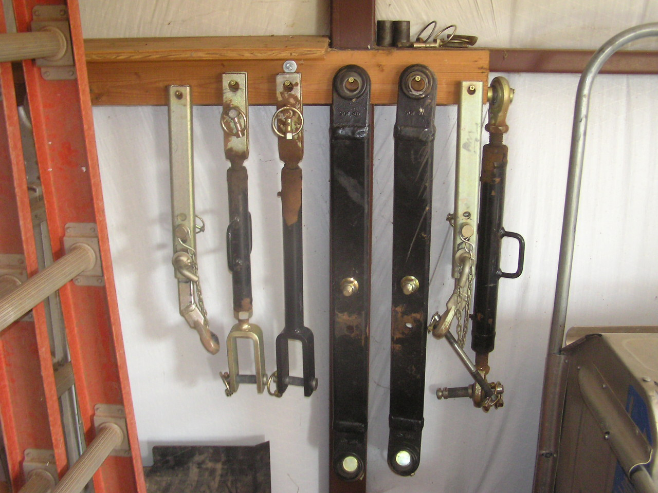

1) I’m leaning towards a 5600, but wanted to see how useful the pto and three point were on the 5610.
The PTO is powered by a hydraulic motor and rated for 25 hp.
I used mine on one project with a borrowed post hole digger. It worked great.
I prefer out front attachments.
Here is my three point:
Removed without tools, so will be easy to put it back on if needed.

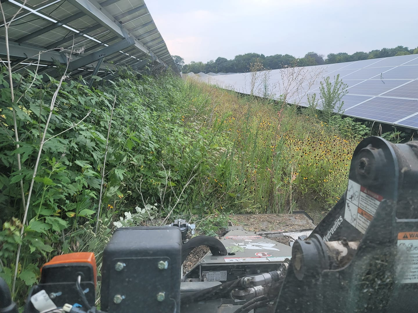

I will agree the 3-point has limited use on the 5610. It is nice for those one off attachments you don't use often because 3-point attachments are so much cheaper. Up front grading or "float" on the toolcat is a little challenging. The steep angle upward on the boom arm means that in float any resistance tends to push the arm down instead of up. Add in the suspension that will flex and you can go from just skimming the top to taking a big chunk out in a hurry. Once you get a feel for it it's easier to just make adjustment manually and feather it up and down as needed.
For me the biggest selling point that tipped me over the edge for the 5610 is I mow the 30 acres of solar panels and the debris, dust, and junk that mowing can kick up would plug up the radiator under the bed of the 5600 needing cleaned out 1-2 times a day to keep from overheating. On the 5610 the radiator is mounted up high right behind the cab and stays much cleaner and easier to clean when it is needed when I am mowing the tall weeds
