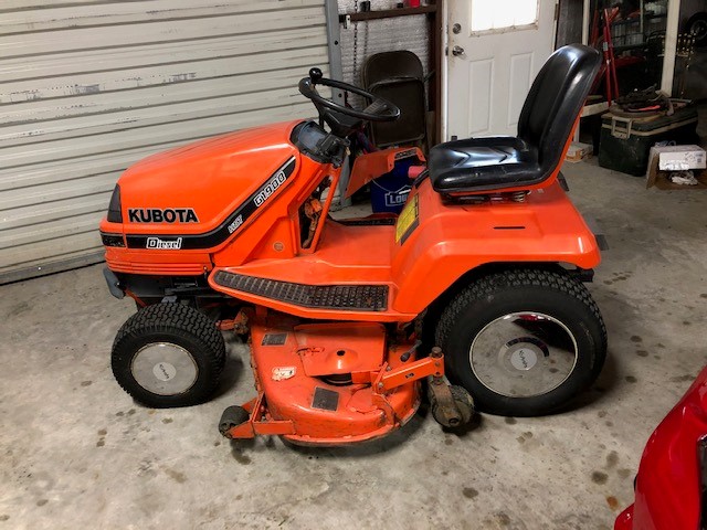

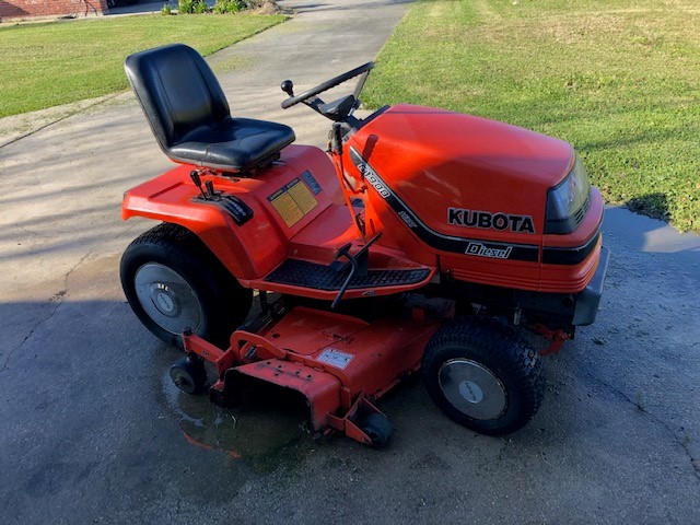

Here is a post from a different forum.
Re: Kubota G2000 in reply to glmpa, 12-11-2018 17:57:58
That series of Kubota are as good a tractor as they ever built, they dont die from worn out, they die from being neglected. I have the diesel version G1900, year 1998, 1500 hours and runs as new. There isn't a new model I would trade it for. I know of several gassers around and other than fuel usage, no complaints. As TRK said previous maintenance practices would be more of a concern for me than 1200 hours. "been maintained" is thrown out loosely by dealers and people selling such. A lot can be told by just looking at it. Seldom will an owner take good care of a unit cosmetically and neglect the rest of the tractor. In the same notion when I see a unit that is beat to heck and looks like it has never been inside and they say "been maintained" I think, Ya right!. At 1200 hours I would expect many years out of it with no more than tune ups and regular maintenance. The weaknesses are few. Grass gets into the screen in front of the radiator and if the operator is diligent about removing and cleaning it (takes 10 seconds) the engine will runs hot and shorten life. Complicating this is the temp gauges are known to stick and not read correctly. The drive shafts for the deck are VERY spendy and wear out quickly when not greased.
4ws means 4 wheel steer - the rear wheels turn also for tighter turns. It would be quite an upgrade for you.
   / considering purchase of a Kubota G2000 Garden Tractor, 5 foot mower deck, rearbagger
thank you so much airbiscuit, that is great information. I thought exactly that, that the 4WS was 4 wheel steering. the video is excellent to, that unit would be newer than the one that my friend is selling. I think the one that I am looking at is a gas model, and that's okay, but I will be asking him. thanks again for the great reply.

I just got this G1900 and have been going through it. I replaced the driveshaft universals and yokes. Have deck off now and sprucing it up. Very well built machine if it is what you need.
Will be used as a yard work trailer hauler and a backup for my ZTR. Though the gas engine may not be a desirable as the diesel being it is a Kubota gas I would not be turned off by that.
