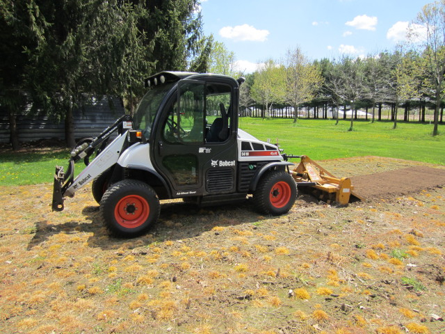

I traded my New Holland TC33D tractor w/FEL and MMM for the 5610 Toolcat. Most of my work was mowing and 3pt work with the tractor so it was nice not having the FEL on, so I would take the loader off. With the TC, I can just keep the lift arm empty when I'm not using it. The visibility and strength of the lift arm is way better than the tractor and it stays planted better. The TC can NOT lift as high though. I use a snow blower, tiller, rotary cutter, and rear blade on the 3pt of my TC. I use a bucket, grapple, snow plow, mower, and carry-all on the front.
They are not the perfect replacement for a tractor but I'm sure glad I purchased mine.
