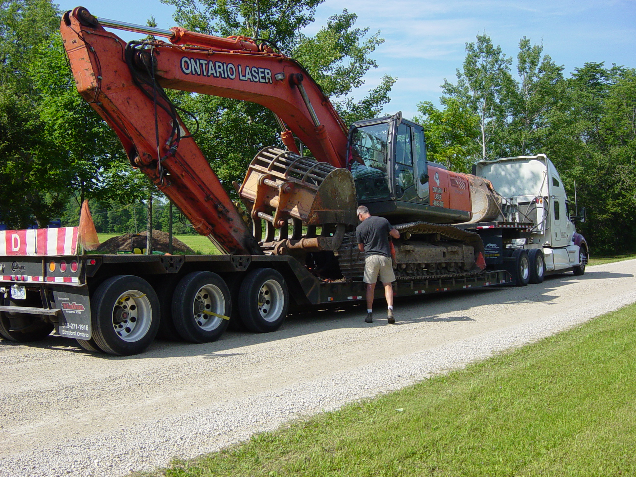

This is the last guy I hired to deal with a very stony, boney and stumpy area destined for cut lawn. Note the massive claw and skeleton bucket! And a regular one up front. All kind of comes at no extra charge!
I have a lot of industrial equipment, not construction equipment and am not going to beat the heck out of it.

If that's on a job you contracted and it bills back, then all is good.
For my personal use I'd shy away from a machine that large as it would draw a lot of attention!:eek: (unfortunately, more attention drawn isn't like at some entertainment event whereby the person drawing the attention gets money- with this kind of attention it's usually the "entertainer" then had to shell out more and more money [permits etc.]) Might be another thing for the OP to consider, and that's the possibility of undertaking a job that isn't permitted.
/ Considering side work with a grapple #9
It was just a personal job. But I consider the outlay in money to be money well spent. Better than a vacation for instance, have something to show for it. And the job is well done, quickly and saving my equipment. There were no permits required in a situation like this. Plus, it is a lot of fun to work with stuff like that.
