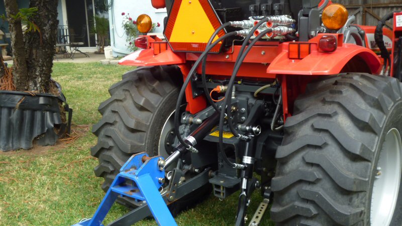

Just my :2cents: from a fellow Californian. The R4s are a bit more stabil than the R1s. You have said that you don't work in mud, so that should be a non issue. Fill them with fluid of some kind and you will think that you were on a different tractor. On my 3215, I filled all 4 of the tires, not just the rears. Made for a different machine as far as handling and capabilities.
As far as a quick hitch, these are the best IMO, but waaaay to costly. Get an Imatch and A top & tilt system and you can pick up pretty much anything at about any angle.
Good luck with your choices. ;)

Hey, thanks for the reply. The JD 3320 has already been delivered. I swapped out the R4's for the R1's. I messed around with the box scraper and already know I'm going to want the rear tires filled. I don't work in deep mud, I shoulda said. There are times the only right soils texture is a bit damp, and I guess you could call it mud: it's not mucky but it's slick. Even in 4WD, I had a few moments of slipping.
The eHydro feels like cheating, but in the end, I appreciated the simplicity close to my pasture fencing. I was totally unprepared for how much fuel it uses. I could drive my lil Kubota for hours and weeks before I needed to refuel. This fuel hog burns up the diesel like there's no tomorrow. I guess that goes with the territory of actually having a few horses to work with.
I'm holding off on a quick hitch. After the flail mower arrives, I'm gonna line up my motley crew of 3rd party attachments and take some measurements before I make a decision.
