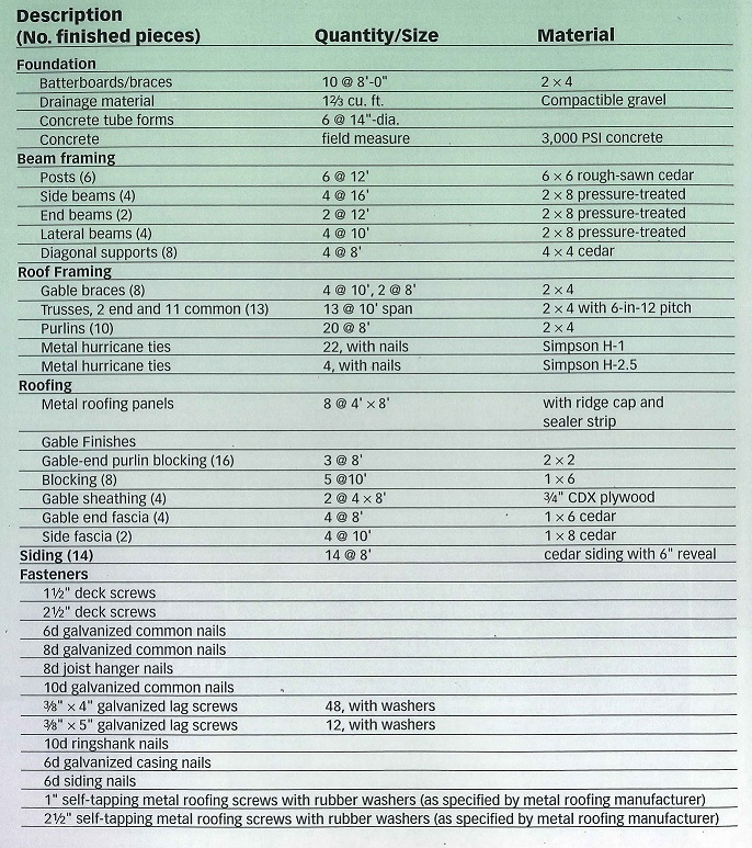

Being an amateur but continually seeking professional quality, wondering if there is anyone who can share advice on construction nails, screws, etc.? Brands, coatings, value, etc.
Several brands are available at our local big box store but are they really what I should be buying? The project I am working on now is a double carport with a 4/12 pitch shingled roof setting on 6 x 6 treated posts. Trusses are due end of next week so it's time to start buying the fasteners I'll need.

Check your local codes.
If thinking about screws there will only be a few that qualify for load bearing construction. You may have to ask for them at your local store.
   / Construction Fasteners #3
Nails and screws are designed to hold lumber in place, not support it or any load of any kind. If you need to support a load, you need to use either brackets with appropriate fasteners, bolts or lag screws. In some areas, bolts and lag screws are no longer code and not allowed to support a load.
For any outdoor structure that does not have protective walls, I don't use nails. With movement and exposure to the elements, wood moves, shrinks and swells. Nails fail quickly under those conditions. Star drive 3 inch exterior deck screws are what I use most of the time.

What method are you going to use to put it together?
Is it going to be a crew of 10 guys or are you by yourself? Only 1 or 2 people it seems like an air nailer would help, but a good one can cost over $200 and you need a compressor. If you have a crew of 10 friends all with their own $200 battery powered impact driver screws may be the way to go.
Also is it going to be inspected and if so what does the inspector want? If code calls for nils you could be screwed if you use nails :)
I tend to do everything by myself so I rely on power tools to assist my construction. I've bought a pneumatic framing nailer for building a shed and plan on using ring shanked nails for most of it. The when I put my deck together it was up for about 23 years with ring shank nails and only about 4 nails had come loose over the entire time.
To me ring shank nails offer the holding power of a screw (or better) with the ease of a nailer driving them. So with the nailer I can rapidly put in a bunch of nails without my wrist giving out.

A "carport" is a very basic structure. The area of concerns would be the post's to beam connection along with the post to ground connection or situation, esp. if there will not be any walls to "rack" the structure. The trusses & sheathing/roofing "fastening" is basic (local codes) usually "toenail" trusses to the beam or header and possibly metal "hurricane" clips or ties. Sheathing will allways benefit from using "ring shank" nails (usually 8d). If you get into diagonal bracing the posts, GRK makes some really nice screw fasteners with big heads and are available in long legnths.
