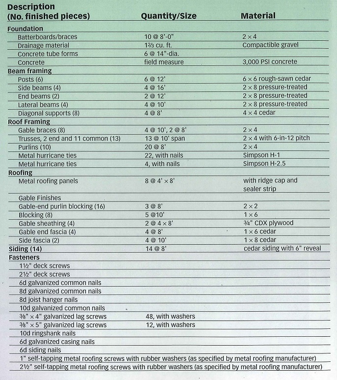

Do you have plans for the carport, or are you making it up as you go along?
If you have plans, either purchased as a package, or individually drawn, read them carefully. If you read every word on every page, and look at the definition of the symbols that are used to describe various walls, you will usually find that professionally drawn plans specify the type of fasteners to be used.
I have plans but have modified them slightly to accommodate the size we are building. The biggest change was the trusses being on 24" centers rather than 16" but the trusses we ordered are designed to be at 24" too. The material list states which type of fasteners to purchase but obviously don't suggest or promote any type of brand. The list also does not give me as much knowledge as all you folks have. The other significant change to the plans is we are using a shingled roof rather than the metal roof.
Appreciate your suggestion to read and read again. I love to read and yep, I read the entire plans multiple times before even considering building this project.
Helped Dad build a small barn many moons ago and lots of "light" remodeling projects over the years but this is for sure the largest project I've done on my own. So far it's going very well, maybe a bit slower than I'd like but there are many other things in this household to juggle, including four year old twins and a more than full time job five days a week. Once the trusses arrive I may opt for some vacation time to get a good long run of work done on it rather than piece meal week after week.
The greatest part of the project so far is how much I have learned by reading what you all are sharing from your knowledge and experiences. If I wasn't able to do the work or wasn't enjoying it I definitely know who could be hired to do it. And in the future when I need contractors I can watch what they do and make sure it's right.
The plans also include photos of construction steps for less than professionals, like me.
