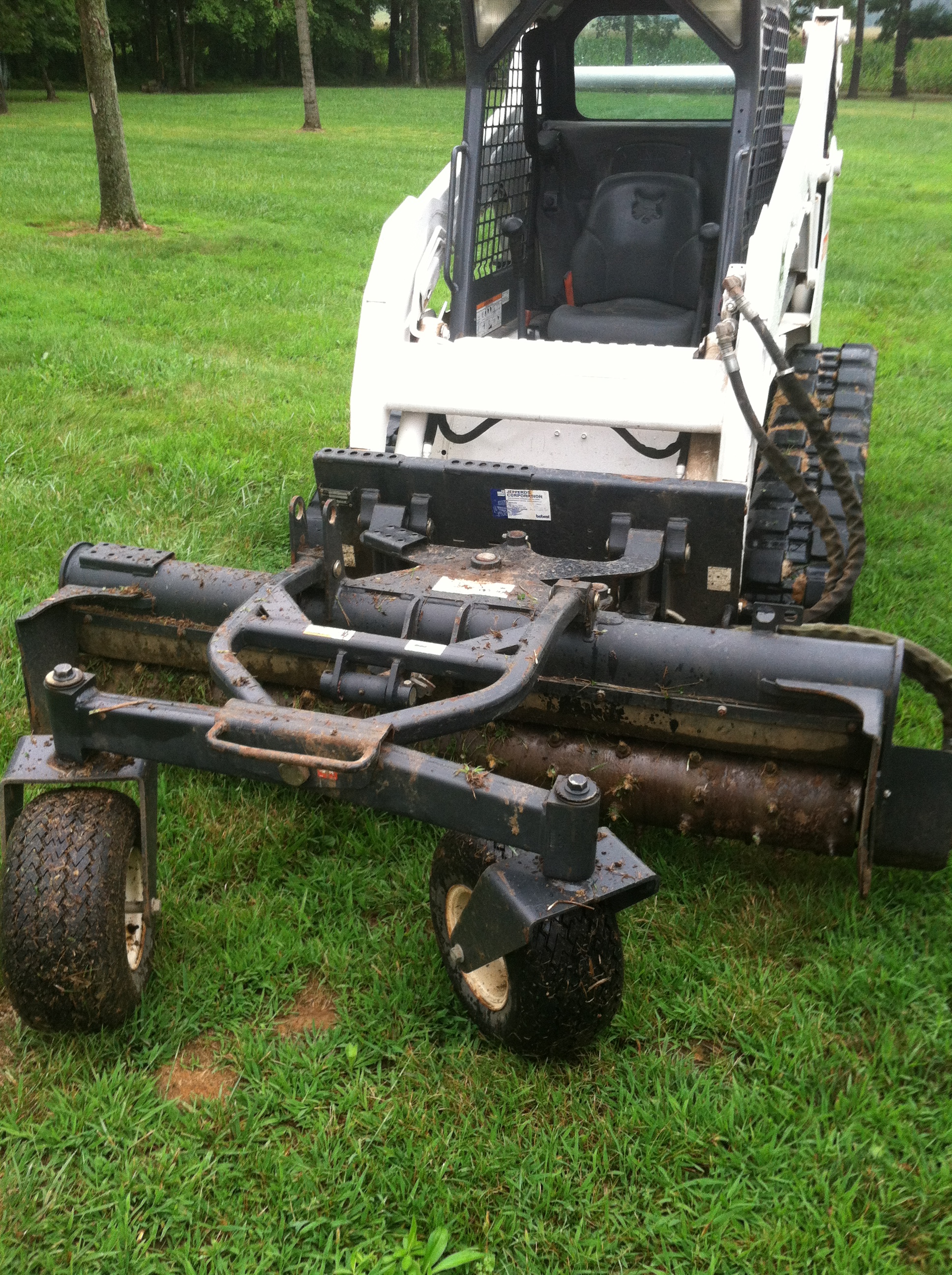

If I were to rent a harley rake and tractor or bobcat could I get this done in a couple of days, remembering that I don't have experience ever using a harley rake?
I'm sorry....I guess I didn't catch that you do not already own a tractor or bobcat......

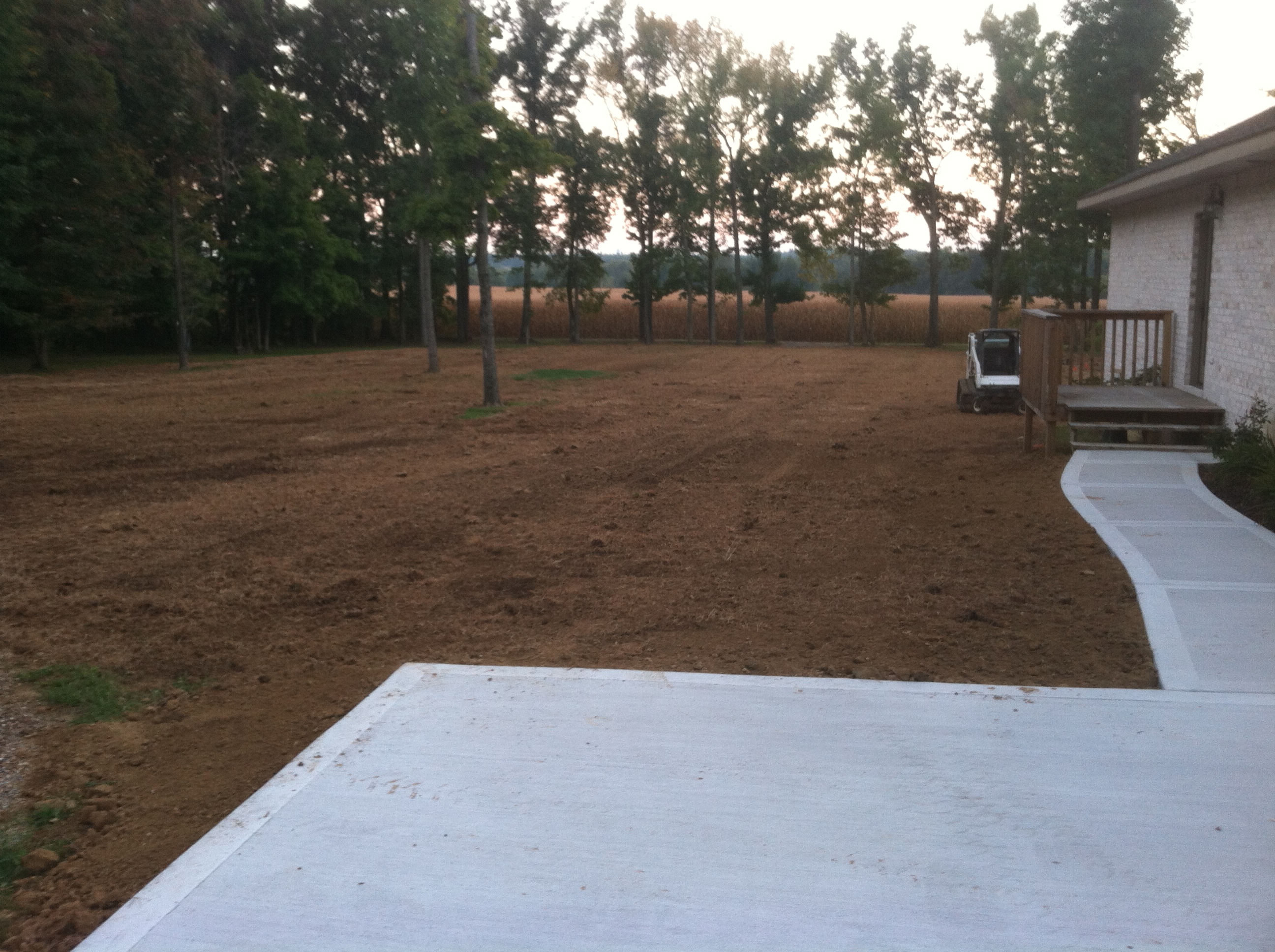

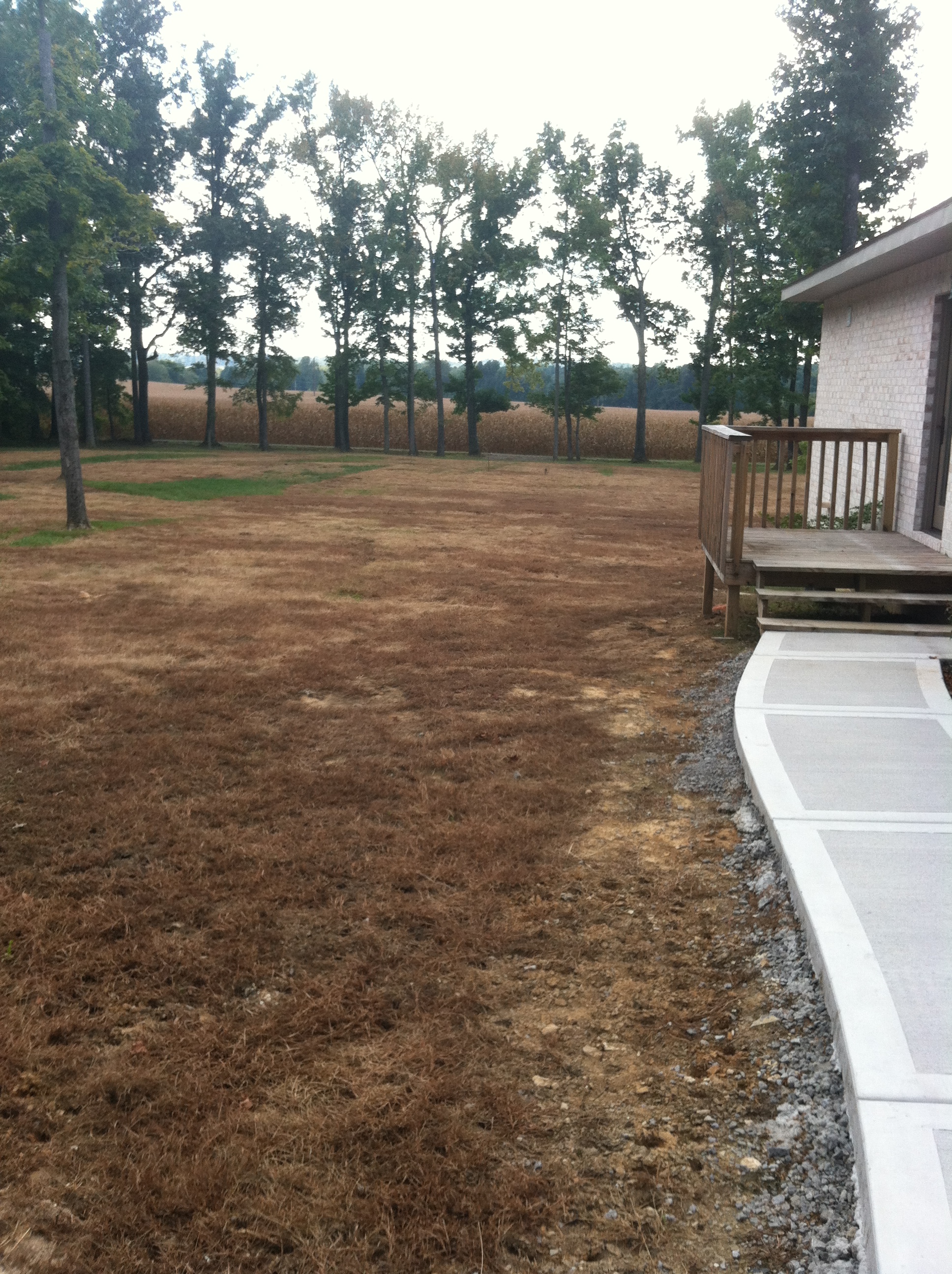

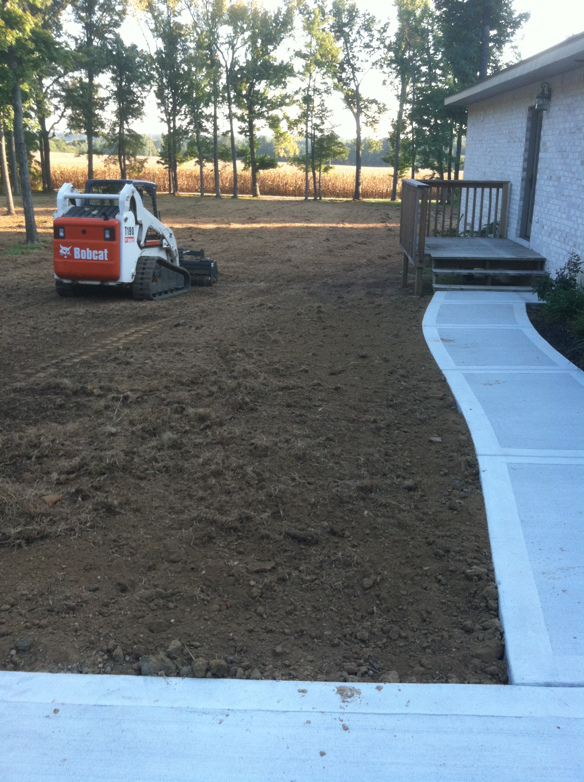

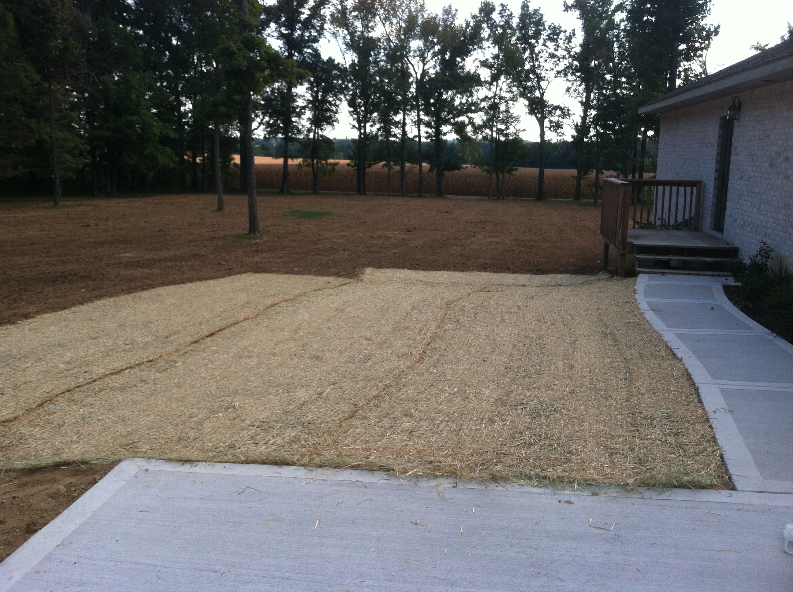

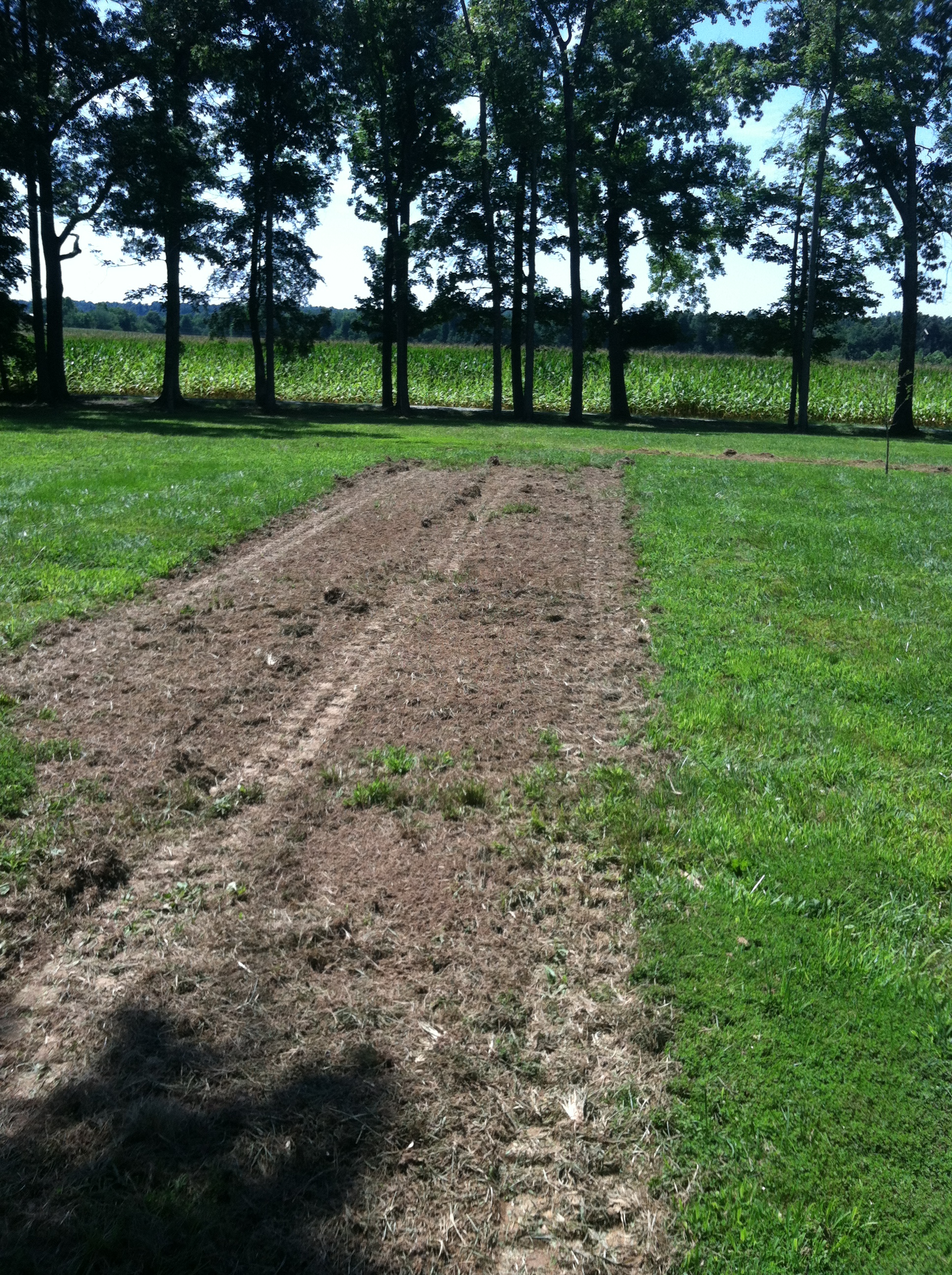

But yes, for 1.5-2.0 acres....if you went to Sunbelt Rentals and rented a Bobcat along with their power rake and trailer (they will also deliver) on a Friday evening....woke up saturday morning and got to work until Monday morning pick up or drop back off you should have ample time to get that job completed very easily. And you will have smooth as glass lawn to mow at full speed on whatever lawn mower you end up mowing with. Just make sure all vegetation has been "roundup'd"....."burned down" so that you can have maximum efficiency when you get started with the power rake. If you do not already own a tractor, renting the bobcat would be much quicker than using the tractor. Here are some phots of my process.

Red did you have to grade your lawn after killing your grass or did the Harley rake also do the filling in of holes etc. I have a very rough side yard that I'm thinking of ripping and replacing part of.
   / Construction of house is done... need lawn.... now what? #16
The beauty of the Harley rake is that it acts as a s tiller and box blade all in one device. It fills in low spots and cuts down high spots....including filling in holes.
I used the bobcat brand soil conditioner...several youtube videos on it.
