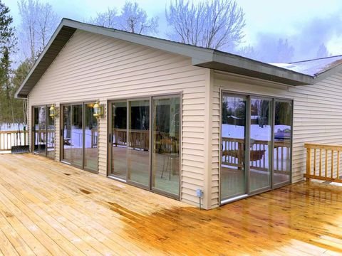

See anything wrong in this picture? 943cecff70b7608551e2ffe56dd19801l-m14xd-w480_h480_q80.jpeg
/ Construction #2
No gutters?
Bruce
/ Construction #3
Right side roof pitch longer?
/ Construction #4
Also - deck appears to still be untreated. That "no gutter" situation will soon have negative effects on an untreated deck.
/ Construction
How about deck being level with doors, water intrusion from freeze thaw?
/ Construction #6
I kinda thought that was a work in progress judging by the back right side.
/ Construction #7
There’s no snow in TN in August?
/ Construction #9
Pirate sees the same thing I see.. NO SILL.. the building is level w/ the deck.. Theres gotta be a "step-up"..
/ Construction #10
Yar! All the sliders are level with the deck. Hello water. No gutters. And who uses gold porch lights? What's with the siding over the side doors? Is that just out of focus, or different siding?
/ Construction #11
There's snow on the ground which means it's in a cold climate. The two roofs pitch together and dump all that water onto the deck where it will freeze and the first person to go out that slider will end up on their a**.
/ Construction #12
Deck and doors that are the same height.
Why is the water pooling next to the house? Even though the right side of the addition will have mucho water from the roof there seems to be too much water there and it is not draining away from the house. There is no water on the rest of the deck.
If we get the right answer(s), do we get a prize? :confused3::laughing::laughing::laughing:

No prize. It was a house I was looking at. I put that picture on the HVAC forum asking about heat. Instead I got 3 guys commenting about how the deck should not be right at door level given the geographical location (northern MI). It was just another nail in the coffin. My realtor did not like my concerns so contacted the local building inspector who said so what, looks fine. I'm like, well, I already have 3 guys saying something wrong, and I google deck building and see recommendations to lower deck down in snow areas to prevent water issues so that's enough for me. Something about the addition there with 4 massive sliding glass doors gave me the heebie-jeebies. Homes are too expensive to mess with problems you could have avoided in the first place.

A deck tight to the house is five year property here in VT.
There is no amount of "weather proofing" than can stop the rot of closed up wood.
Designs like that is what keeps carpenters in work!
