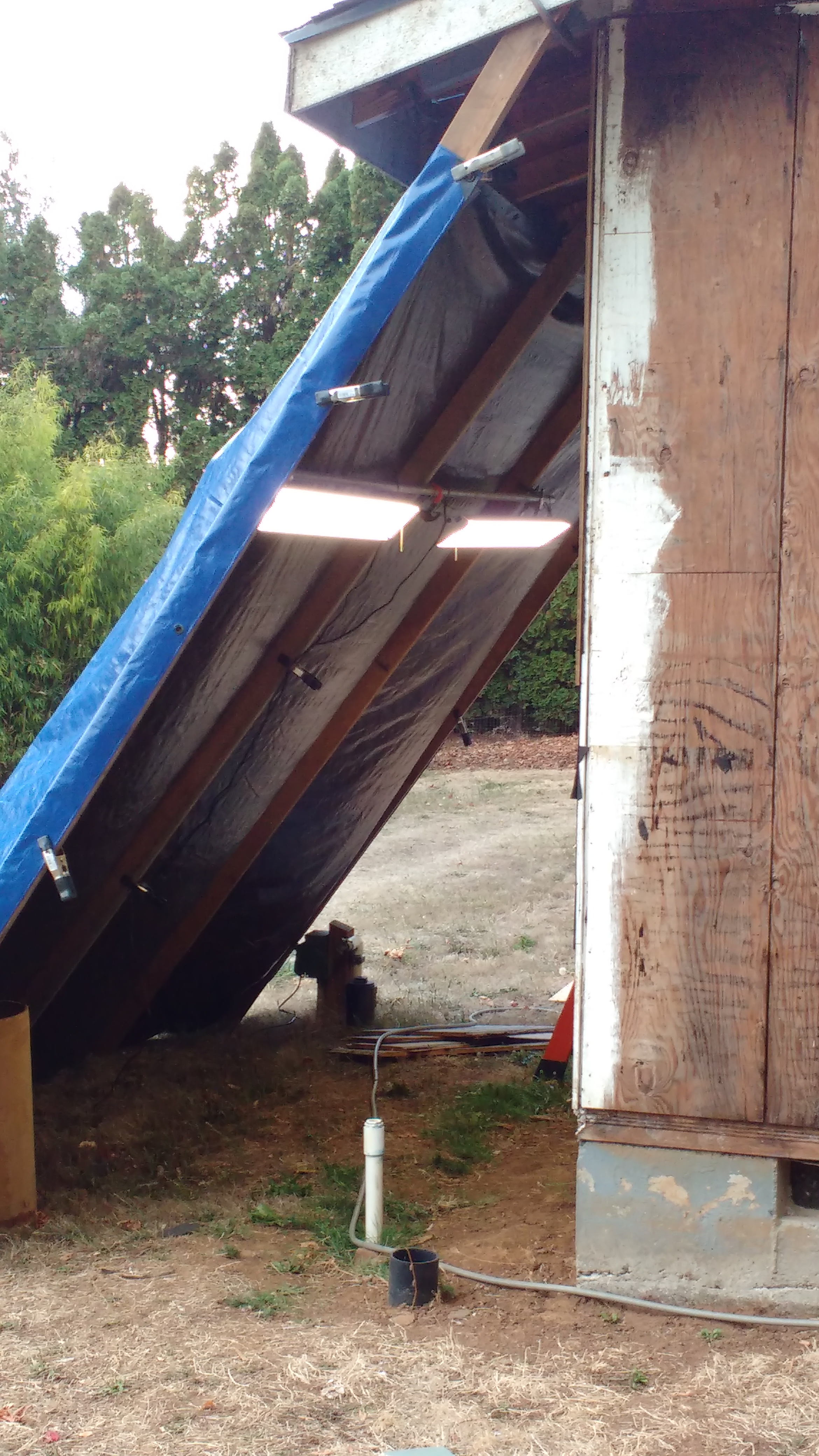

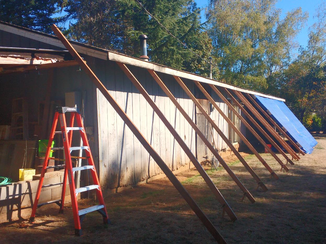

Nope, guess it's true when they say "The older I get, the faster I USTA BE..." everything I open up looks worse than I hoped it would be, so I figured out a way to survive this job, which is DEFINITELY gonna take me well into the "horizontal rain" season - we typically get anywhere from 20 to 80 mph winds on this hill most of the winter months, and LOTS of rain - and I HATE seeing buildings worked on in the rain, it's just BEGGING for dry rot, etc... which is just what I've been finding; it's now lookin' like I will need to replace ALL 62 feet of the south side sheathing, at least up to 4' up from the foundation, BEFORE I can put the new siding on - so here's my survival plan

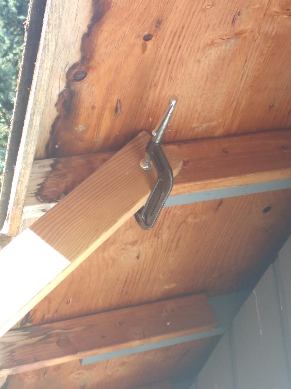

That's one 12'x16' Costco tarp, today I got a second one up (not shown in that pic) - each one's held out from the house by 5 12' 2x4's, clamped to every other rafter tail (up UNDER the roof) and to a second STAKE driven into the ground at the outer end. That gives me just over 9 feet from house to bottom of the tarps - I'll extend that "lean-to tent" clear to the other end of the house, so EVERYTHING I do will stay bone dry til the paint's dry. (Including ME...)
I also have enough of the led lights to run them full length, then they can get used elsewhere when it's done. Not clear in the pics, each pair of lights hangs on a 10' stick of 1" conduit, which is clamped to the 2x4 "tarp rafters" and angled out toward the house - Those give me enough light I can work til bedtime if I'm feelin' frisky (Ever seen a frisky 73 year old? Me neither :confused:
I'm gonna use one of the tall containers as a "paint booth", pre-prime EVERYTHING including the replacement sheathing (already in hand), then when it's ALL nailed up I'll spray the final color. This time it's gonna be a medium gray (few shades lighter than the mil-spec "lego blocks", with a slightly darker than sky blue trim.
By leaning 4x8 sheets up on both walls of a 40' container, I can spray up to 18 sheets at a time without worrying about rain before they dry... (as long as I remember the respirator, and my "tenny-runners" :rolleyes:
BTW, this ain't gonna go FAST, but it's gonna be a dang sight closer to RIGHT than it useta wuz - so far I've found wrong nails, not ENOUGH nails, ZERO flashing around windows, big odd-shaped gaps in sheathing (mud daubers LOVE these, so does dry rot), some siding hung too low (about 8" of "bug tunnel" below the sill plates for 62 feet) and there's a fair possibility (haven't looked yet) of dry rot in some of the sill area framing...
Did I mention that the NEW title of this thread's gonna be "Steve's everything BUT a container weld shop build" ??!?
But hey, at least we got all the firewood we need for the next couple years, so yay :laughing: ... Steve

"On that second picture what's wrong with that sheathing"
Nuthin' wrong on the gable end; it only gets maybe 20% of the "horizontal rain", had a few voids I patched and caulked and THAT part's ready to wrap and side.
It's the LONG side that gets most of the action - as I mentioned, NONE of the windows or sliding door were flashed AT ALL, the tar paper was done kind of a "lick and a promise" - as a result, EVERY opening has dry rot from near the bottoms of windows down to the foundation.
I'm hopin' to make it another decade or two, and this is NOT beer, *** or pizza so I NEVER wanna do it AGAIN :mad:
So it's gonna get done the best way I know how...
The GOOD news - it rained all day today (still is a little) and my "mil-spec lean-to tent" is completely dry and 99% breeze-less for the whole 30+ feet :thumbsup: so a few more 2x4's, couple more tarps, and I'll be able to get things closed up ENTIRELY before I prime and paint the entire (half) of the house. That'll mean that I'll need less than one 5 gallon bucket of primer to do the end and long side, same with final coat.

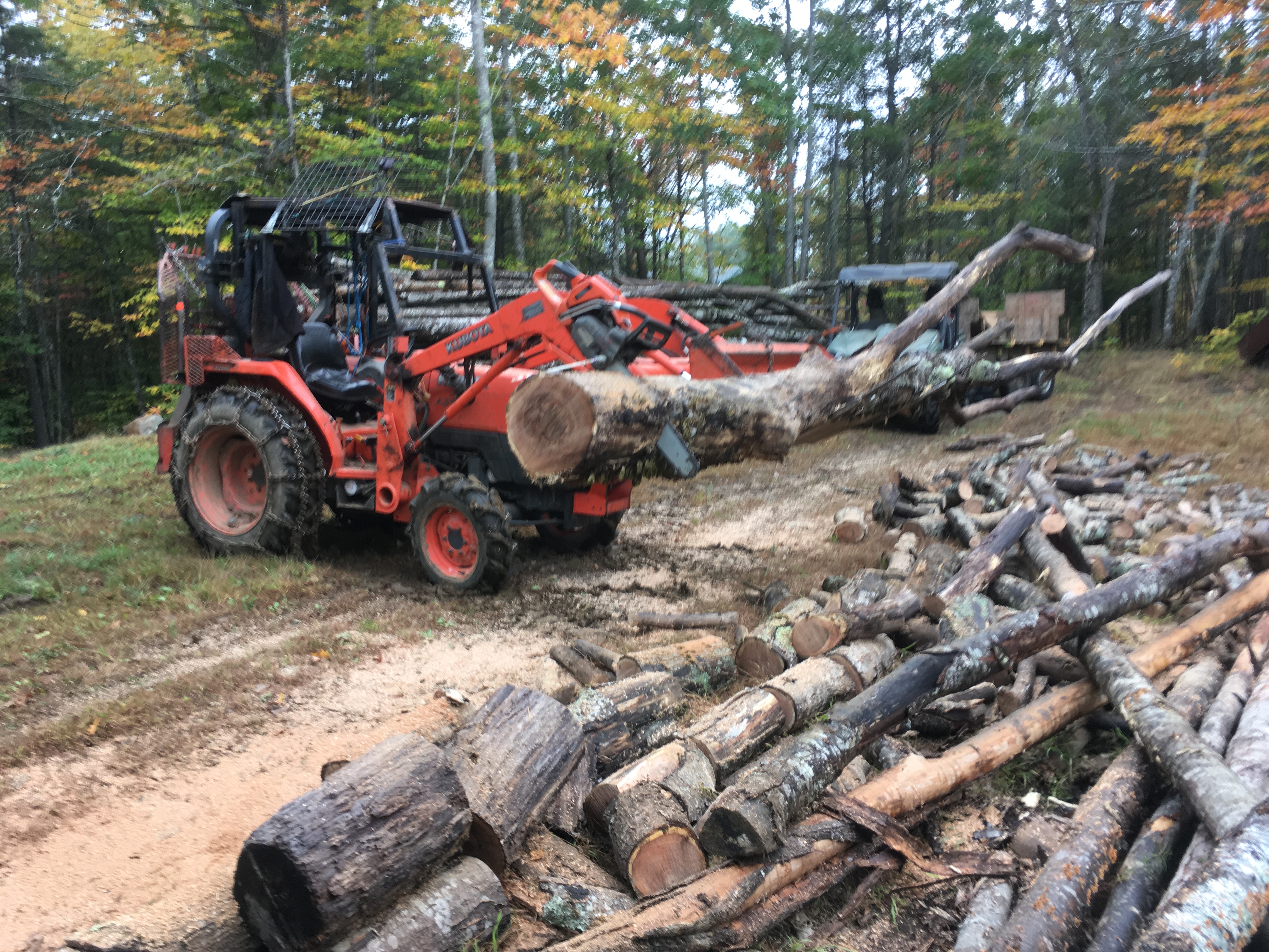

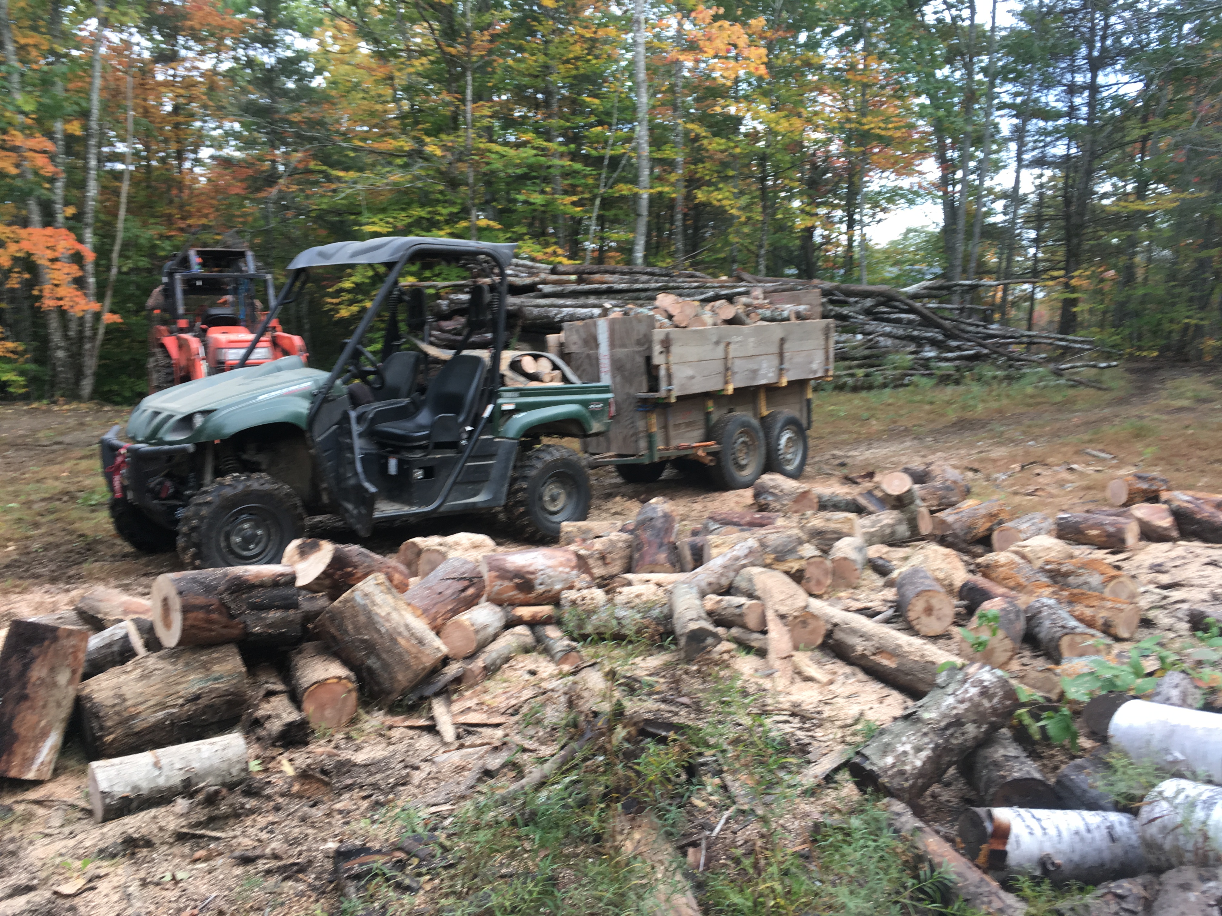

Right now I'm trying to get my firewood in before it snows, already a week behind schedule, forgot about all the pre-work that has to happen first, luckily my wood spliter started with just 6 pulls, so far I only got 4 loads in with 11 more to go then I'll be all set, nothing more satisfying in life then that all set feeling. I better take Friday off so I can get caught up and get that all set feeling.

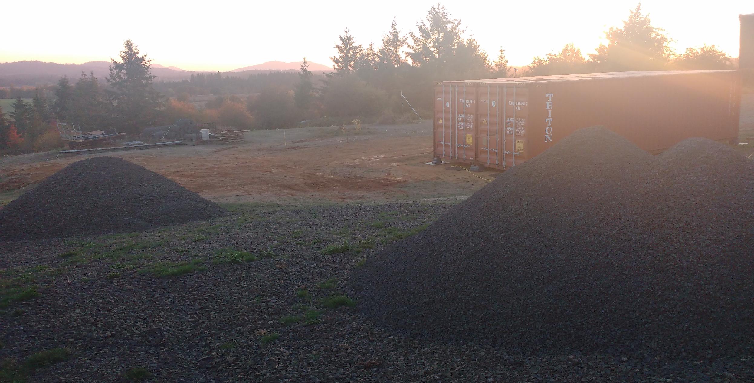

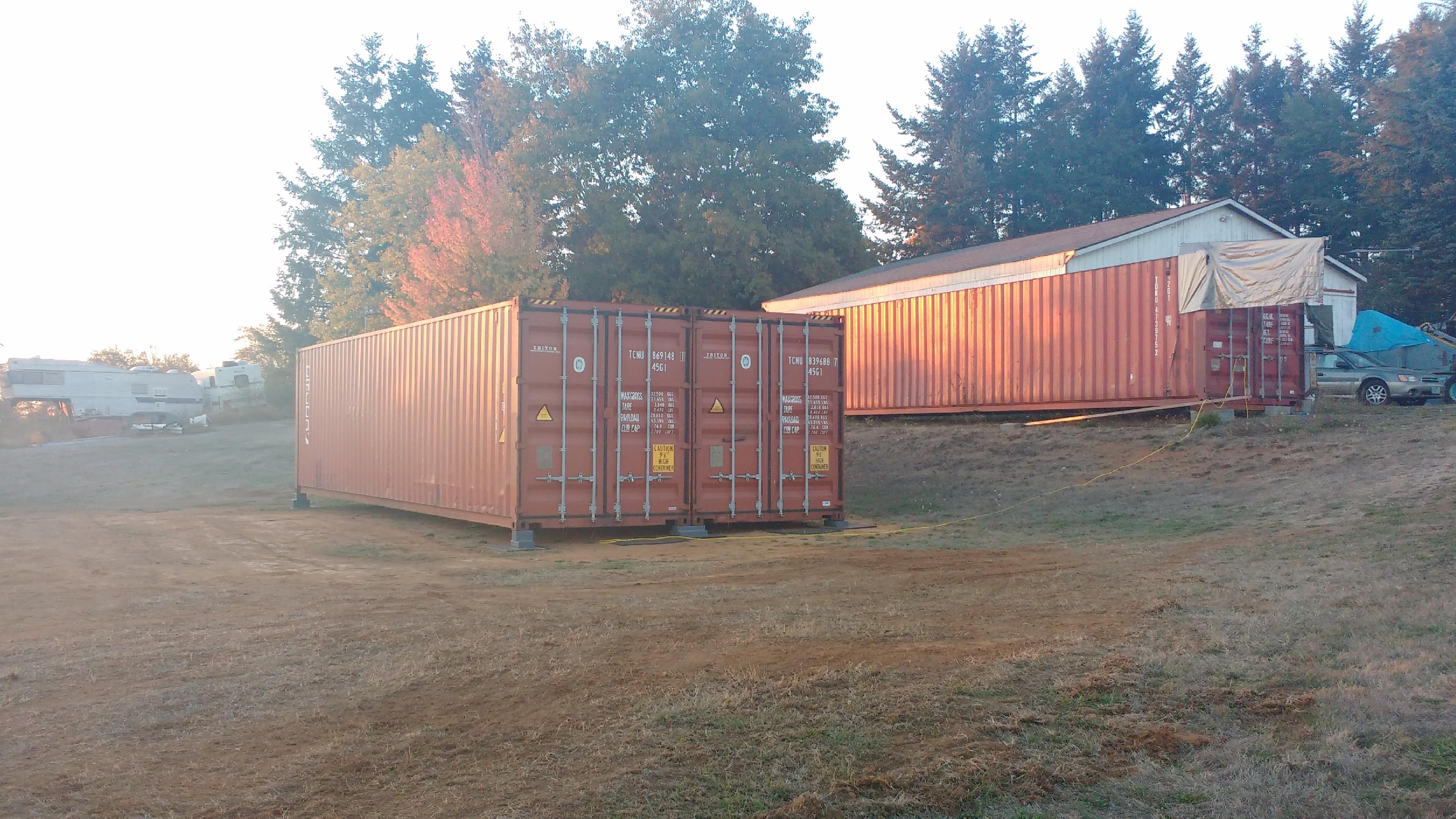

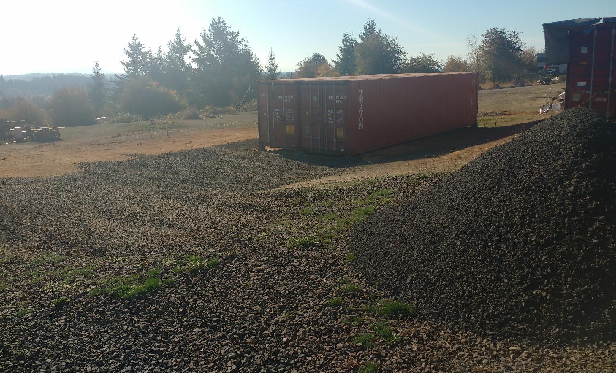

The "browner" areas in front of the 2 containers are where I scraped some humps off with the Gannon box; third pic is after the 1-1/2" minus rock.
It's 'sposed to rain about an inch starting Tuesday/Wednesday/Thursday, so about Saturday I'll "drive it in" a bit more with the 580B and smooth it a little more. Then it'll get a couple inches of 3/4"minus (the OTHER pile), so I can get around the containers WITHOUT pontoons :rolleyes:... Steve
