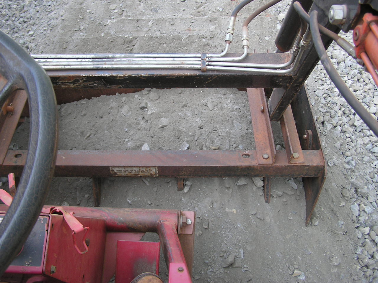

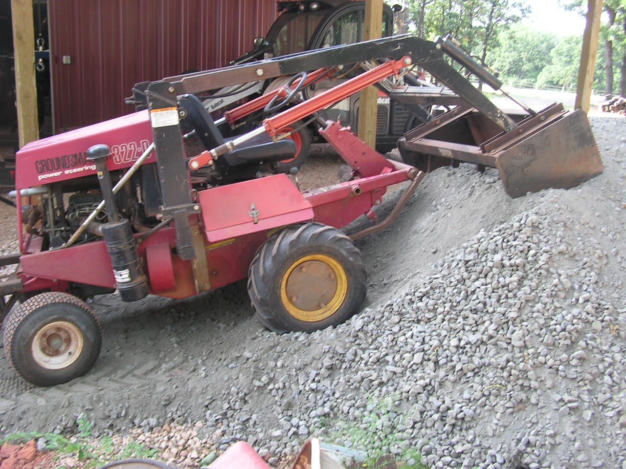

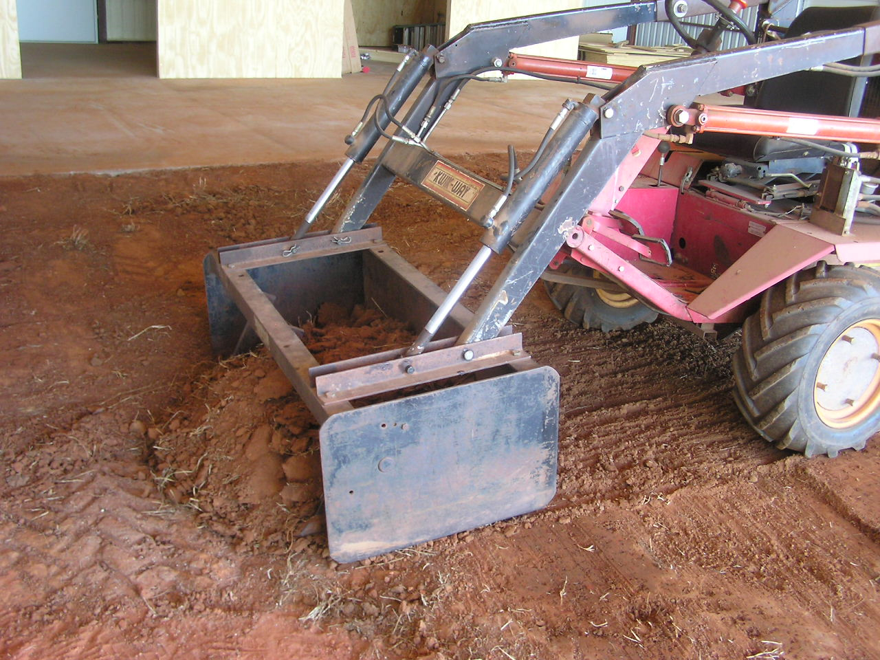

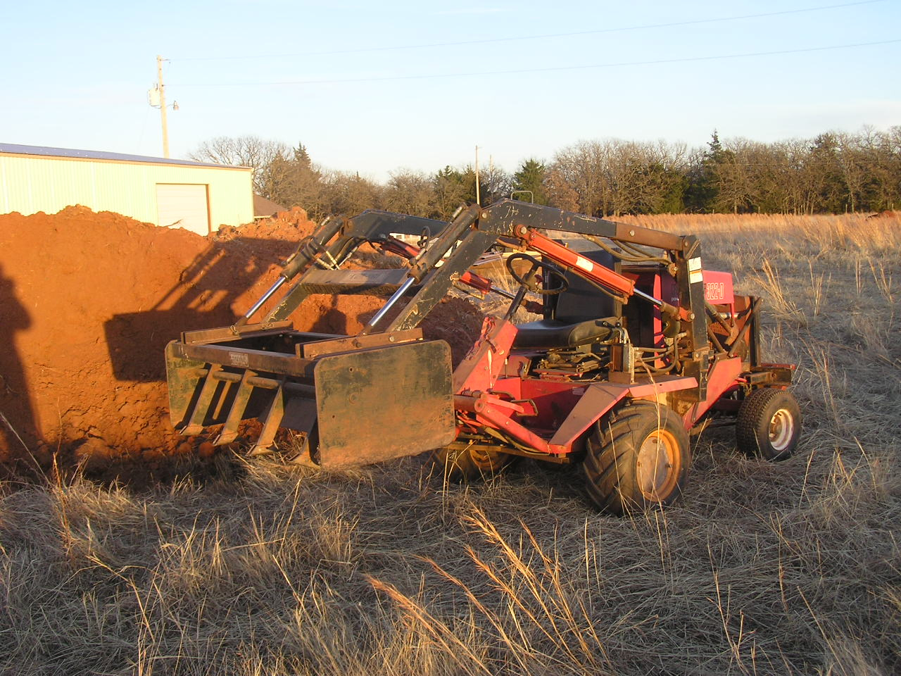

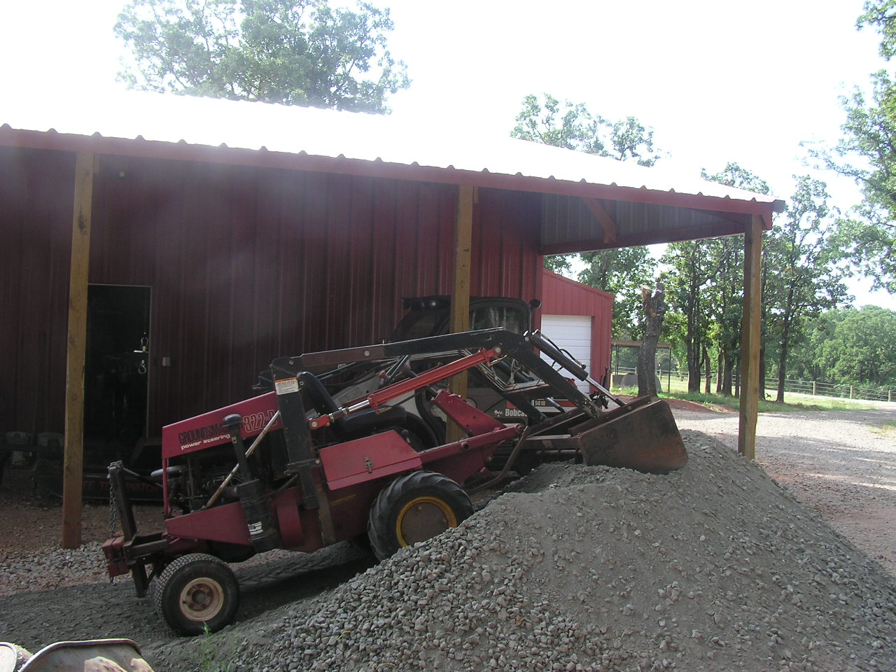

I have discovered the power of tilting the 4' box blade on the front where it is easier to see it:
And mounted turned around for float mode in reverse:
View from the seat:
The pile is smaller now:

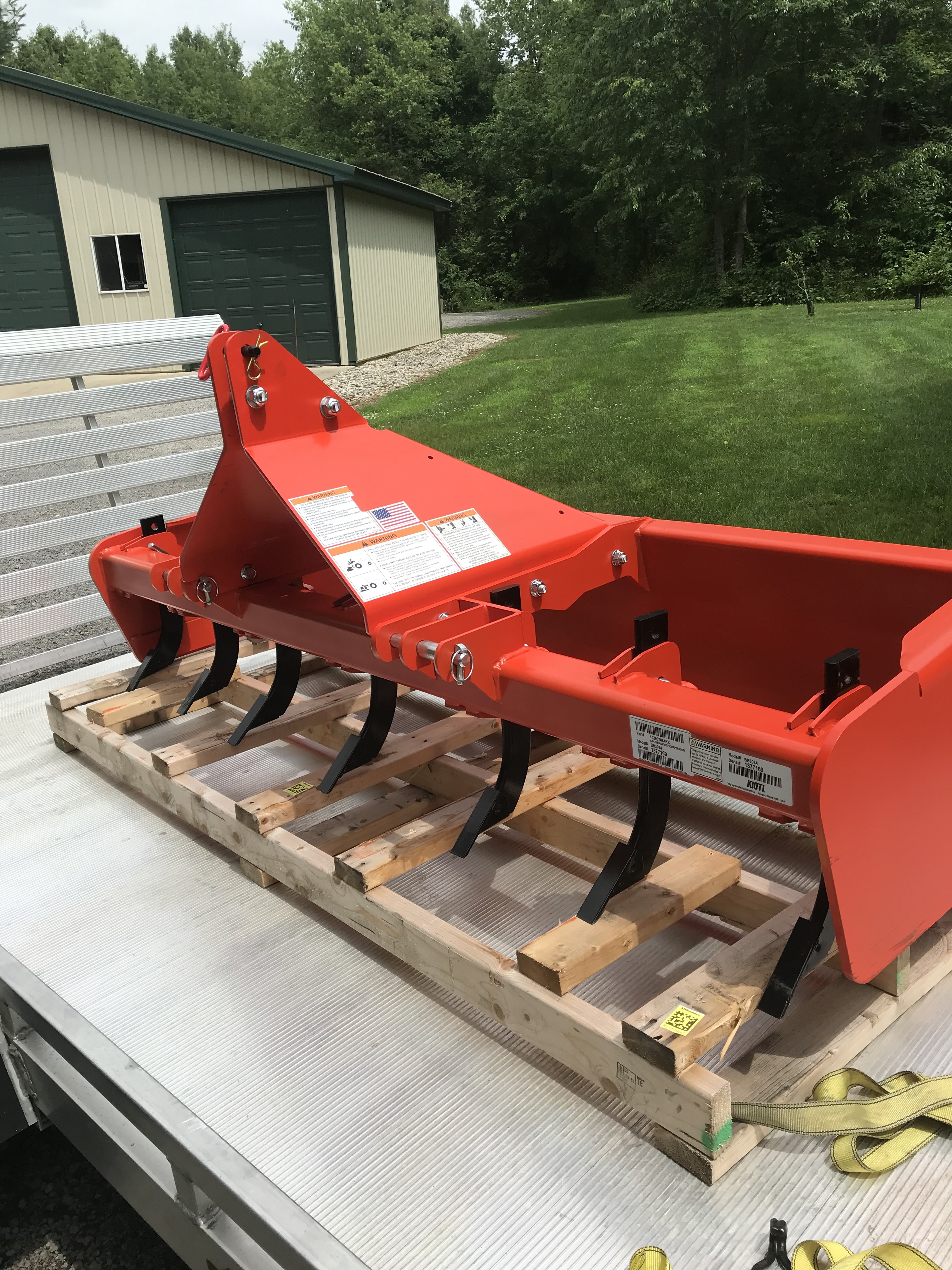

I purchased a heavy duty Kioti made by woods 7ft. more than happy with it.
