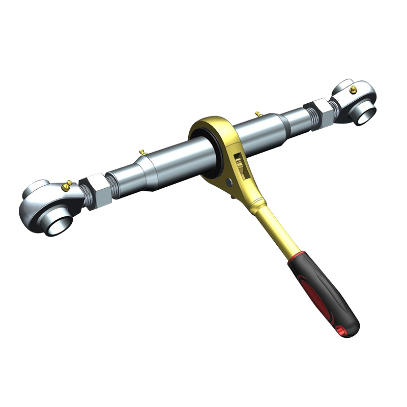

True utility/capability of a box blade only happens if you can easily adjust the top link on the fly. On a smaller tractor you may be able to reach it from the seat, but it will still be tedious. On a bigger tractor, you'll need a hydraulic top link. If you don't have the ability to easily adjust the top link on the fly, then you have a very limited range of capability. Many people never discover the power of the box blade because of that.
I agree, it makes it much easier. I recently added a powered top link to my little b6100 and one of the things that i find useful about it that i have not seen anyone else mention is when you can change the angle so much, you can leave the rippers at the height where they don't engage when the box is level, but still engage when the box is tilted forward. So you can have rippers alone, front blade doing its normal job when the box is level and the rippers only breaking up high spots, or just rear blade spreading/smoothing. So a power top link also mostly removes the need to get off the tractor and change ripper settings which is even more annoying than a manual top link!
One thing i haven't done yet is if you want to push a pile backwards with it, tilt the box forward a little to lift the rear blade edge. You won't scrape all the way down to the ground, but you also wont snag anything and bend your 3pt stuff, and you'll still move 95% of the material.

A hydraulic top link would be a good addition, but there are work arounds. When I leveled my driveway I set the top link to scrape the high spots, fill and drag, then I would lift the box about 3/4s of an inch to empty and spread in the low area. I set a stop so I could lift the box just enough. When it was empty, go back drop the box and do it again. However, the length of your top link is the critical element in successful operation.

Best investment (Hydraulic mid-link) for any tractor that has three-point hitch. Makes hooking up equipment so easy and box blades become so much more useful. Complete your hitch with “Pats” brand quick hitch. 3 point hitch that can’t be beat. “Pats” quick hitch is the only thing that is tough enough to handle a 8 ft. box blade when pushing backwards.

Now is the time to purchase a hydraulic top link. If your tractor is set up with rear hydraulic controls. I have a Fit Rite hydraulic top link. It is a REAL game changer when dealing with 3-point land engagement implements.
