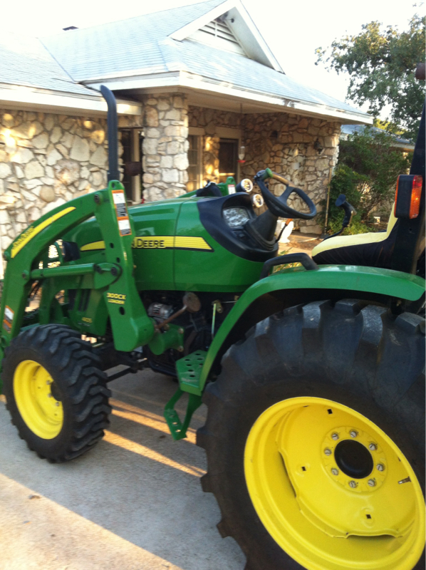

I bought mine in a package it has been real good tractor. My frontier shredder doesn't really throw dust on me.
The only trouble I have had is with neutral safety switch . The best thing I have done to it was to put vertical exhaust on it.

I put they stack on for the fumes it really does help be cause before the engine fan would blow them back at you.
As far HP for your jobs this tractor will surprise you. I shred in high range,pull up trees,carried big fallen oak
Pulled some buddy's out of mud. So far it has done every job I throw at it.
