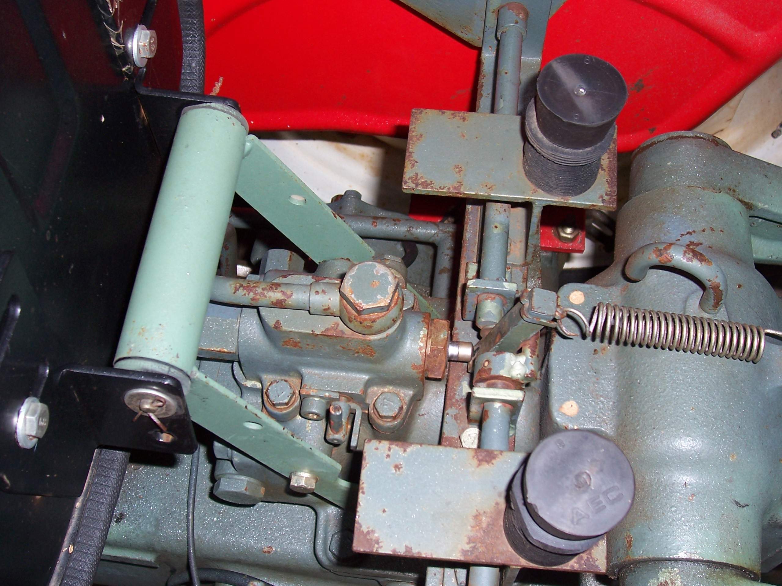

DND Pretty much raining and crapy out . The Wifey already asking to do her a favor:eek::eek: Oh no house work not again today. So I made a run for it. And I'll try to get back on topic.
California not sure of your set up is or if it's the same but this is what I did. My lift was still slow going up. I know still a little Ghetto rigged but it woks great now. If you look at the piston on the back valve Inn is up. So if you look close at the spring you can see were I shortend it and that made it fit snug on the Pin causing it to push in farther on raising. You might be able to do something to were yours is further away so it does not push in as much. Alright now no laughing but yes it does work much better.:cool:
