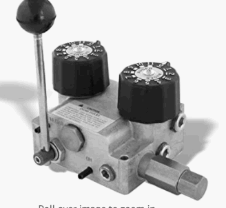

Yup although ours are road speed using either an extra pickup off the transmission or tapping into the actual truck circuit. The setup we use, uses a feed back circuit so the gate opening is calculated to get the correct spread rate and the spreader chain speed is adjusted appropriately.
Looks like there would be some salt savings.
Definitely is when you consider we used to use the ole manual hydraulic clock valve:
Problem with that valve is when the truck stops, the spreader keeps going unless the operator stops it, which didn't happen. Also meant you had hydraulic plumbing in the cab which was a real pia to run as there were 2 #12 and 2 #10 lines. Not to mention when you burst a hose it flooded the floor of the truck which was good for preventing rust but not so much for the poor SOB that had to run a new line......Mike
