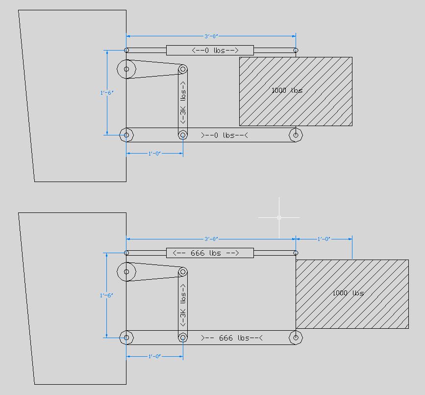

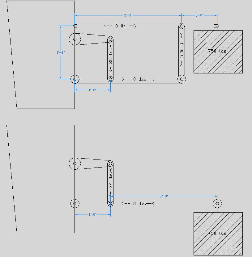

Anyway, while I was run off I did some sketches of the problem - and I stand corrected - a perfect //gram does not change the lift force as the load is extended past the ball ends. BUT this is not a practical answer. I have attached four sketches; note I have not included all of the forces (i.e. in the tractor frame) and I did not calculate a Mohrç—´ circle for each component
#1 is a "at ball ends" load
#2 is what SPYDER and LD1 are trying to explain (note that there is no change in the lift force but the top link and drag link are put in tension, compression).
#3 and #4 are what I think is a more practical application.

I don't know what manufactures use to calculate extended loads (this is what the OP was asking for) and your theory does not come close to answering the question. Maybe the extended load is limited by the tension in the top link? This would not help someone trying to calculate a lift capacity of a boom pole though.
My intention was to give the OP an answer that made sense and that could be used in a practical application.
Do you have any constructive comments on this?

Well I'm glad you came around and now their are 3 of us that understand how a perfect //ogram work. In previous post too I also mentioned that it would increase the tension and compression of the top and lower arms. I also mentioned that it would be harder on all the pins as well. So now we agree on all that.
As I have mentioned in several posts before, to calculate the load at a given distance away, there is no set number or percentage. It varies with every tractor, and it can even vary on the same tractor by mounting the top link into a different hole. The further you deviate from a //ogram, the more capacity you loose. The best way is to measure the travel distances of the pins, and a know point however far back you want, and then you have your percentage.
On my tractor I have 3 mounting locations for the toplink. The top hole is the closest to parallel. Hooking their and extending the toplink about the same length as the lower arms, I may only loose 5% capacity @ 24".
But on the same implement, If I shorten all the way and mount toplink to lower hole, this causes the implement to raise much faster in proportion to the ball ends, thus reducing my capacity @ 24" by more than the first setup.
