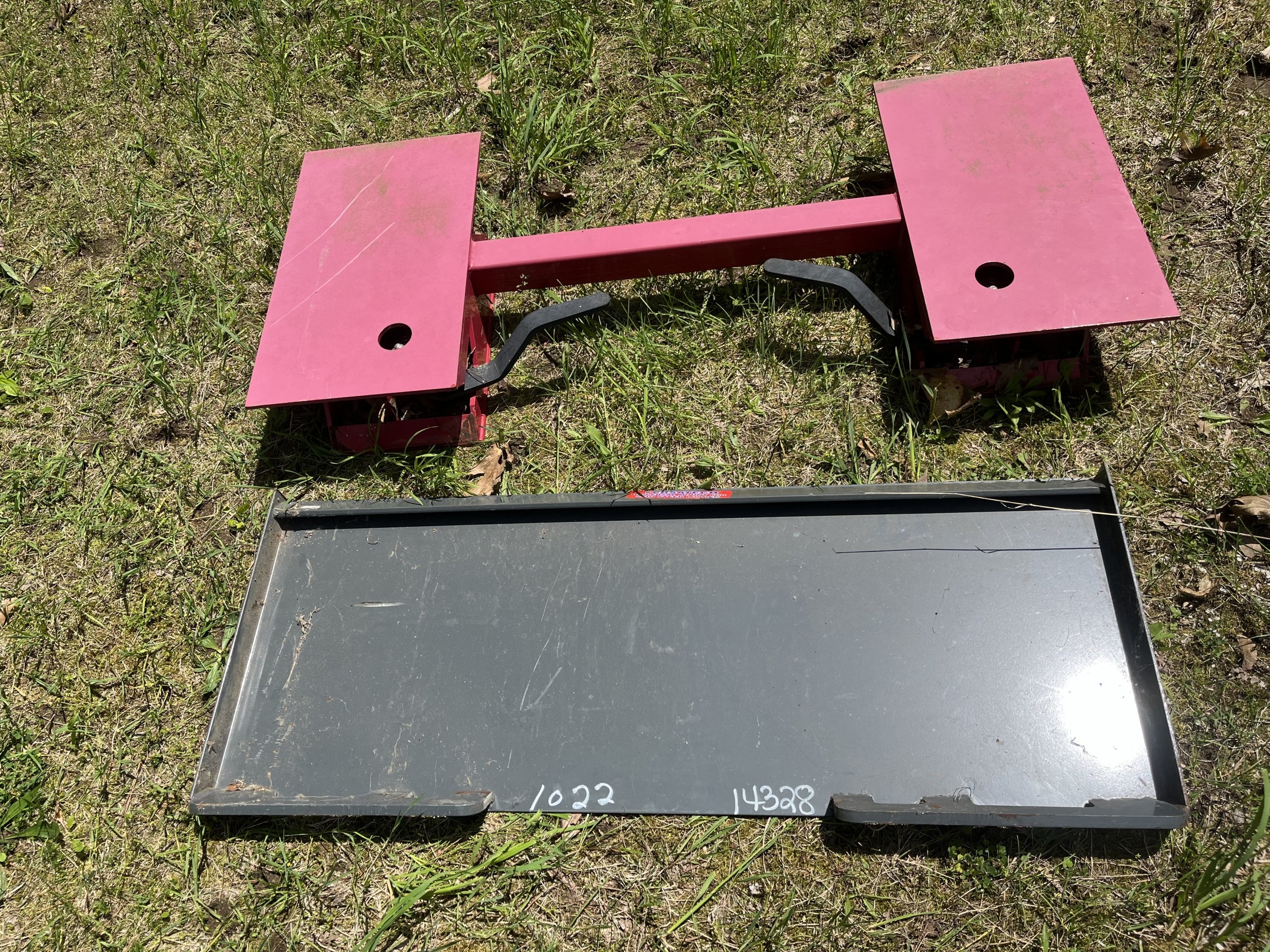

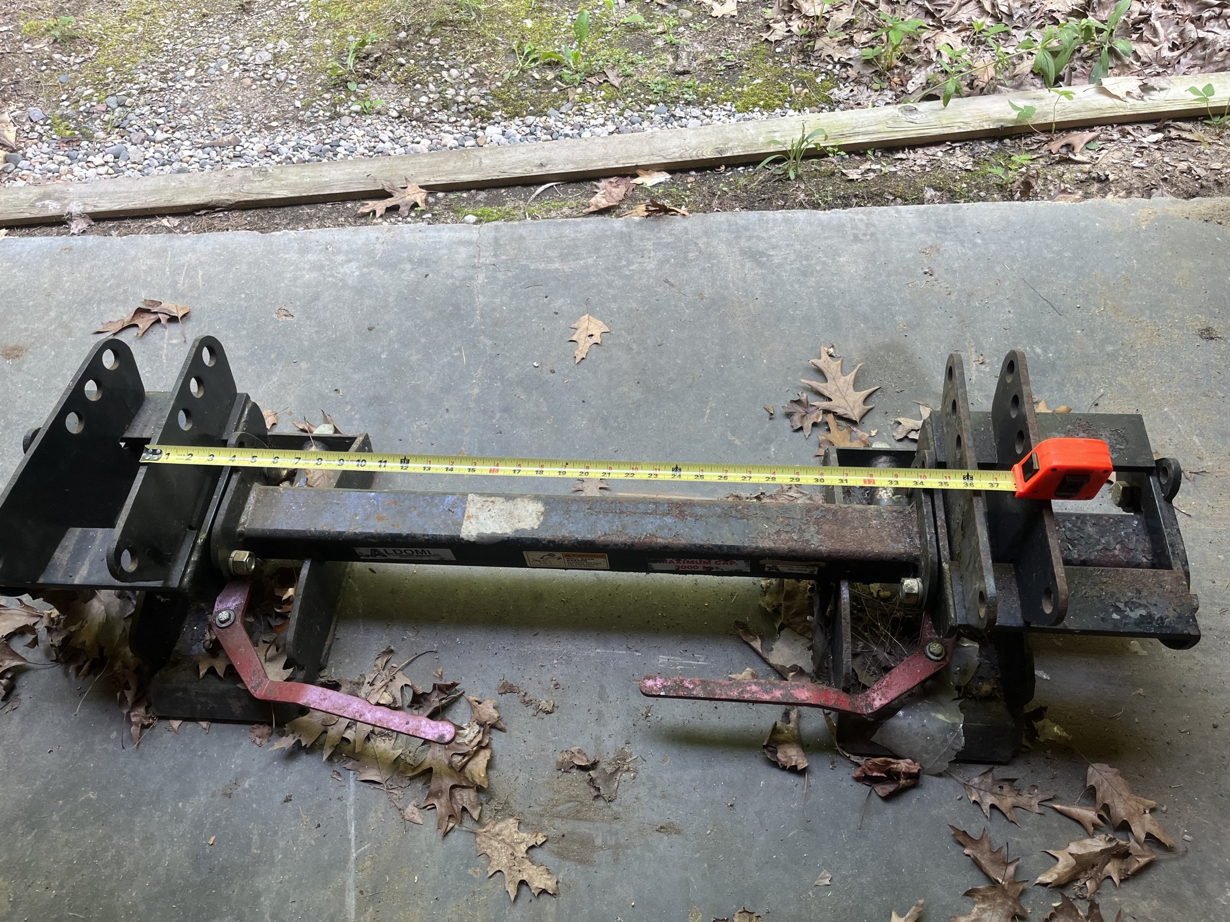

Turns out that my 'universal' is way wide for a tractor that isn't older yet, say 8" or more too wide for OP's. Shortening the main bar would make the QA pins out of position.
The red guy would need brackets welded on to pin to the arms and cylinders. You can see that it's not much wider than a std implement plate, .. which is 3/16" metal and would need backing plates to put something on it. I bought red for my TC33DA's 14LA and went another route with a pin-on kit that I could at least find.
Sorry that I don't have something easier after all. And $50 would almost pay for a bottle of Woodford Reserve 'Double Oaked'. Tryin' my best.

I replaced the bucket on a JD 750 just a couple of weeks ago. I opted not to put the QA mounts on the tractor, but the photos I posted may help. If I decide to add QA mounts in the future, I can cut the bucket mounts off the QA plate and make a frame for the QA mounts.
