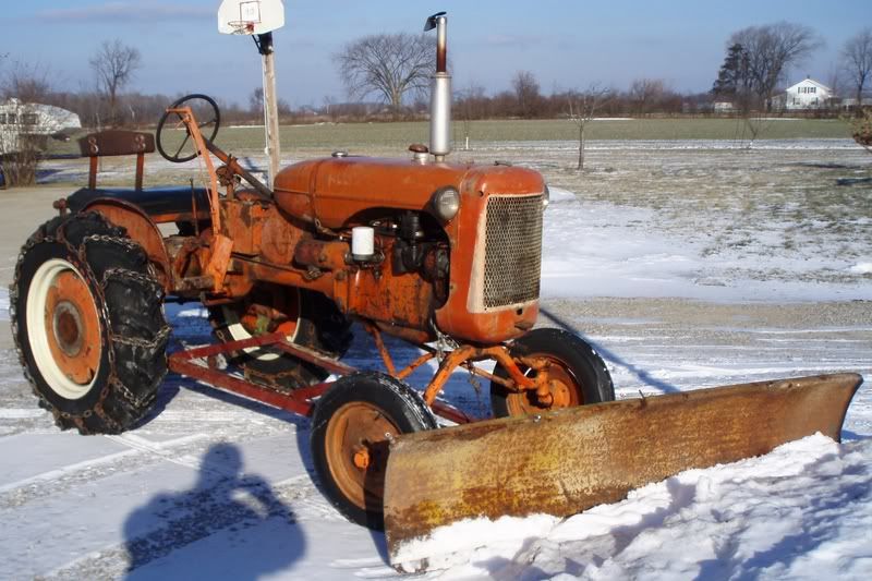

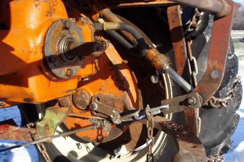

My old allis "B" uses a cable from the lift, thru two pulleys, then connected to front.
REAR LIFT
REAR PULLEY
FRONT ATTACHMENT
This tractor had a dozer type blade on it when I bought it and the front anchor was attached to the axle pivot. The blade is an old Monarch Road Mach Prod unit from the 50's that has been welded on & on & on...
I also have the generator mounted hydraulic pump with a single spool. I hope to put this on sometime.
