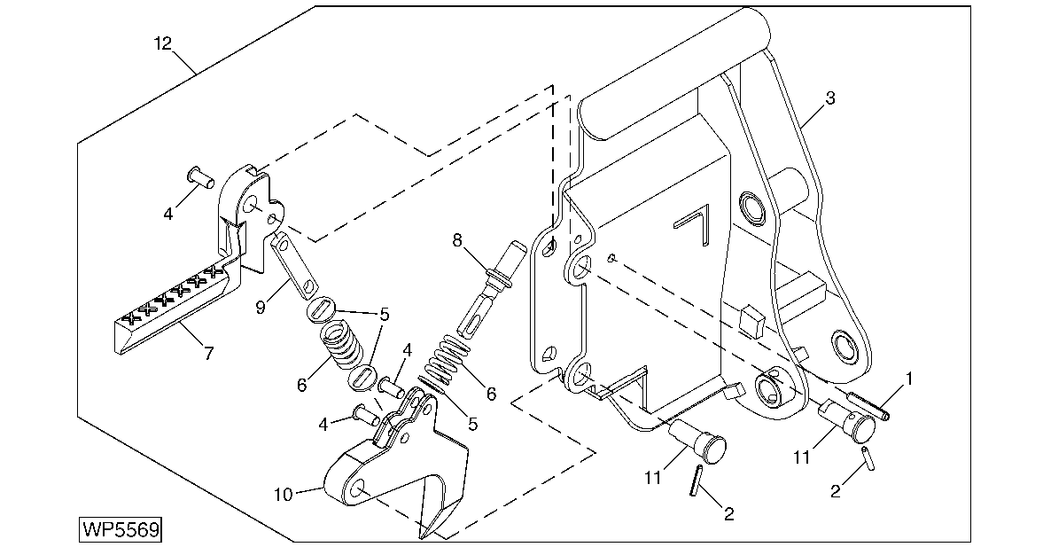

Looking for opinions on the best way to convert my 400cx JD loader with the JD quick-attach system over to a SSQA. I know there are adapter plates, but I've seen wild price variations and not sure how strong the cheaper ones are.
Anyone done this, and what was the best bang/buck approach?

The best way is to go to JD and get the parts, but what is not available in the JDQA system that you want to use?
http://www.greenfarmparts.com/John-Deere-SKID-STEER-ATTACHMNT-CARRIE-BW15244-p/bw15244.htm
John Deere Holder BW15244
SKID STEER CARRIER
Cart key PART NO. PART NAME QTY SERIAL NO. 400X 400CX REMARKS
1 34M7251 Spring Pin 1 X X 10 X 55 mm
2 34M7216 Spring Pin 2 X X 6 X 35 mm
3 AW32725 Holder 1 X X RH
AW32723 Holder 1 X X LH
4 W50737 Weld Pin 3 X X
5 KV14518 Washer 3 X X
6 KV15409 Compression Spring 2 X X
7 KV15906 Handle 1 X X RH
KV15907 Handle 1 X X LH
8 KV15968 Guide 1 X X
9 KV18477 Strap 1 X X
10 KV18988 Pawl 1 X X RH
KV18987 Pawl 1 X X LH
11 W50194 Pin 2 X X
12 BW15244 Skid Steer Loader 1 X X COMPLETE GOODS/SHIP BUNDLE

Just kind of want SSQA as I'm buying a grapple, pallet forks, 4 in 1 bucket, and such.
I'll check out the JD option. I'd prefer that honestly!

KennyD - If I understand the parts diagram correctly, #12 the BW15244 bundle includes everything I need (#1-11), right?
Is that all that is needed to convert? other than labor LOL
I'd rather spend the comparable $ to convert rather than adding on an adapter b/c I'll never use the JD and don't want to lose lift capacity for nothing.
Thanks!
Is that all that is needed to convert? other than labor AND MONEY LOL
I believe that to be correct JFon. See my edit in RED
