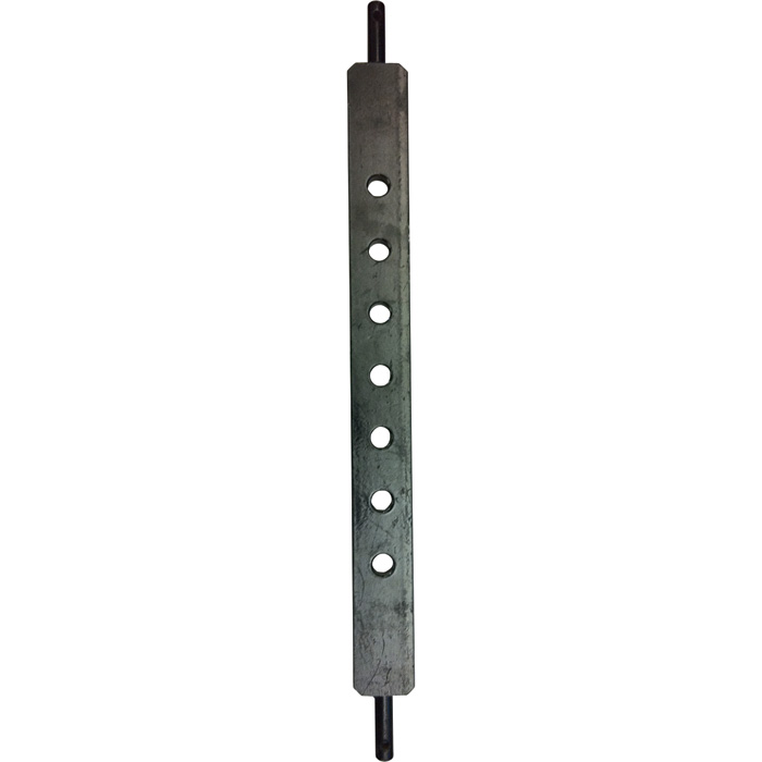

I wouldn't change anything on the planter. Don't change history. :)
For use on a 3 point, here is what I would do first. If it didn't work, I would make a light 3-point frame that would bolt to the planter.
Bolt one of these under the planter frame about where the front of the handles attach.
Attach the front tow point of the planter to your fixed drawbar with a connection that allows vertical swinging pivot motion so it can lift and pull. Don't use the top link at all.
