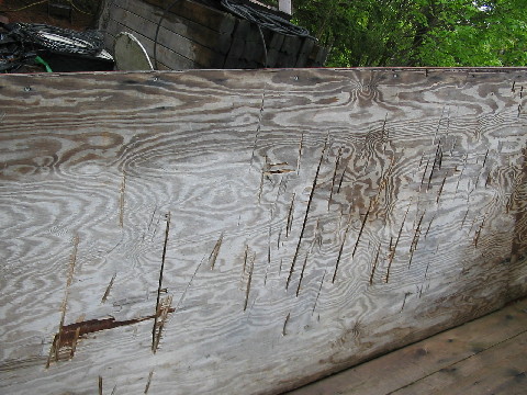

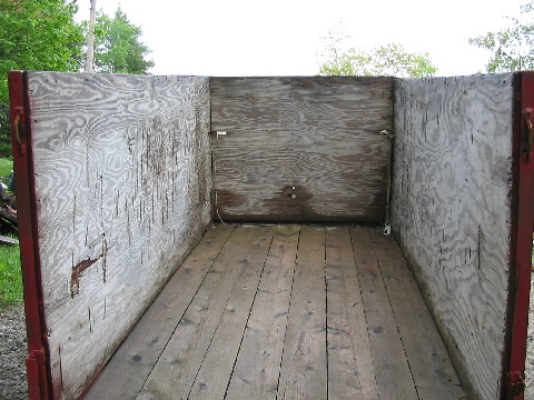

another pic of the utility trailer with a close up of the csaw marks on the walls /forums/images/graemlins/grin.gif this trailer also doubles as a summer fall horse trailer.. /forums/images/graemlins/grin.gif /forums/images/graemlins/grin.gif(yes i have a real enclosed horse trailer too...BUT... on hot summer days the boys love stickin their heads round the sides of the trailer and my truck ( i can see them in the mirrors)and feelin the breeze of the rushin air on their faces and is quite agood laff when ji loadem up and ijts real hot out ...jist like a dog !!! they know they're goin for a ride and are so anxious to jump right in...hence the holes in the walls on the sides(for 2 horses ) and the hole in the middle (for one horse.. u oughta see the kids at the beach comea runnin to pet the horses in the open trailer and i'm always sure to bring a big bag of carrots so the kids can feede'm!!!! /forums/images/graemlins/grin.gif /forums/images/graemlins/grin.gif /forums/images/graemlins/grin.gif

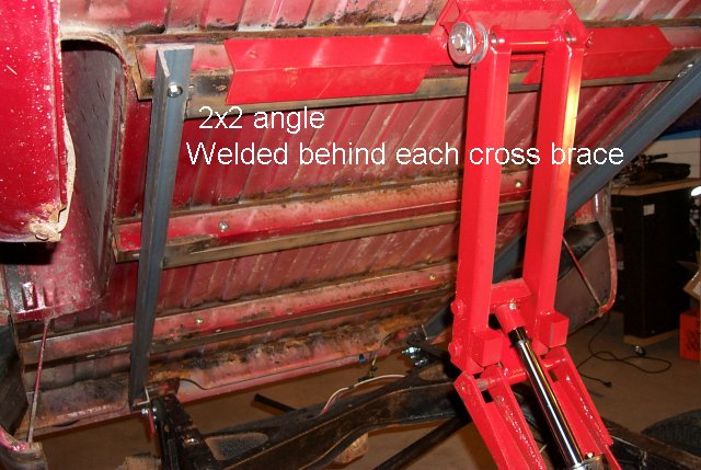

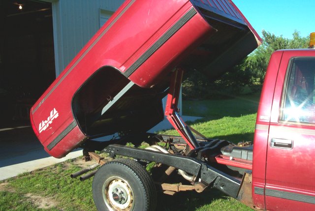

Pics of installing my dump bed.
This was the stock hinge mount! The way they had it made, it would come down and hit the frame so the bed wouldn't sit flat or level. It was very weak, the bed would rock around a lot.

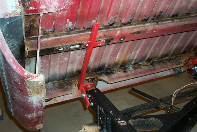

   / Convert old pickup or buy dump trailer? (long) #16
The new hinge and bracing.

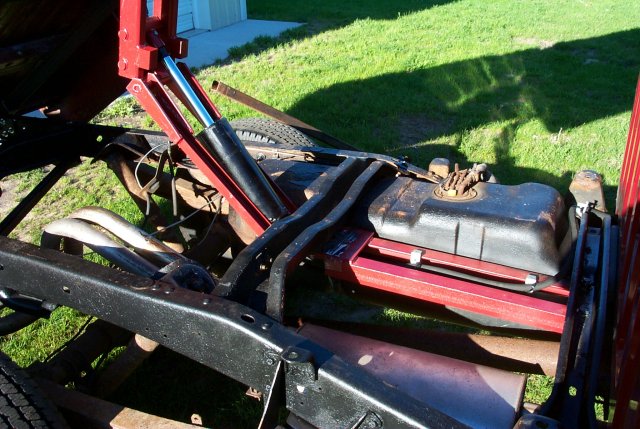

   / Convert old pickup or buy dump trailer? (long) #17

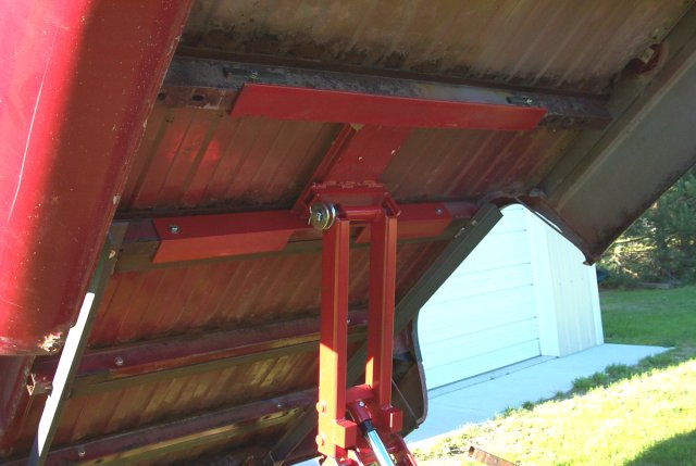

View of upper mount.
   / Convert old pickup or buy dump trailer? (long) #18
View of lower mount

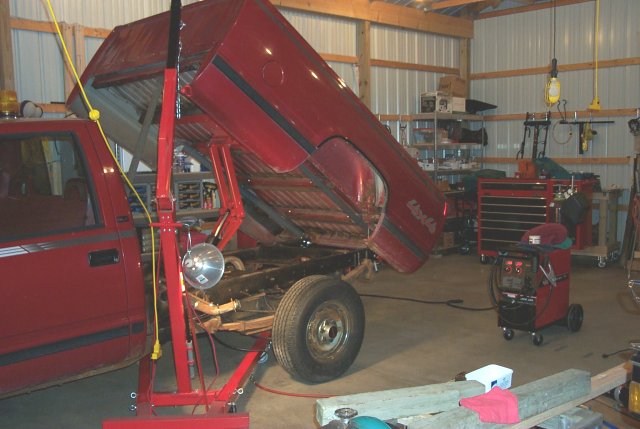

   / Convert old pickup or buy dump trailer? (long) #19
With bed raised

Last one...
View while building.
