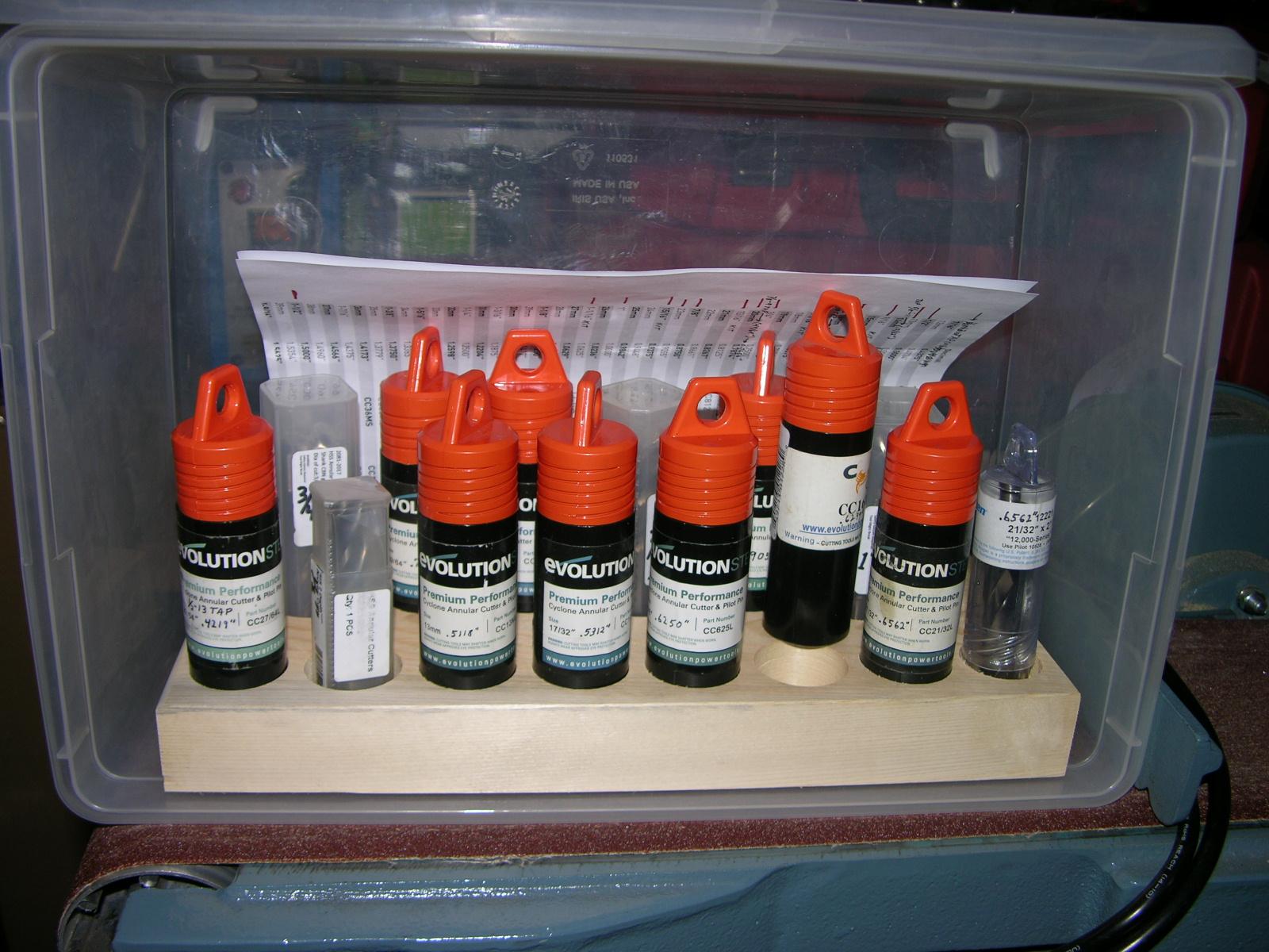

Another trick that works for me - I've bought several METRIC cutters, always just a few thou bigger than SAE sizes I use a lot - this gives me a hole with just enough slop not to need a hammer to drive a bolt in. I have Evolution's catalog, edited to show the cutters I have - if it's not too big I'll attach the pdf here - if that works, you can see that ALL the metric cutters I've marked are really just SAE with "built-in clearance" :rolleyes:
Looks like it might've worked. I like Evolution's cutters AND their containers, plus they don't make you buy a pilot SEPARATELY like some others - nice thing about their containers is MOST are the same diameter, up til the cutter is too big to fit it - DSCN1964.JPG - One of those "oversize shoe box" totes, a piece of 2x6 and a forstner bit and "voila" :D (couple more cutters and I'll be re-thinking that one :rolleyes:)

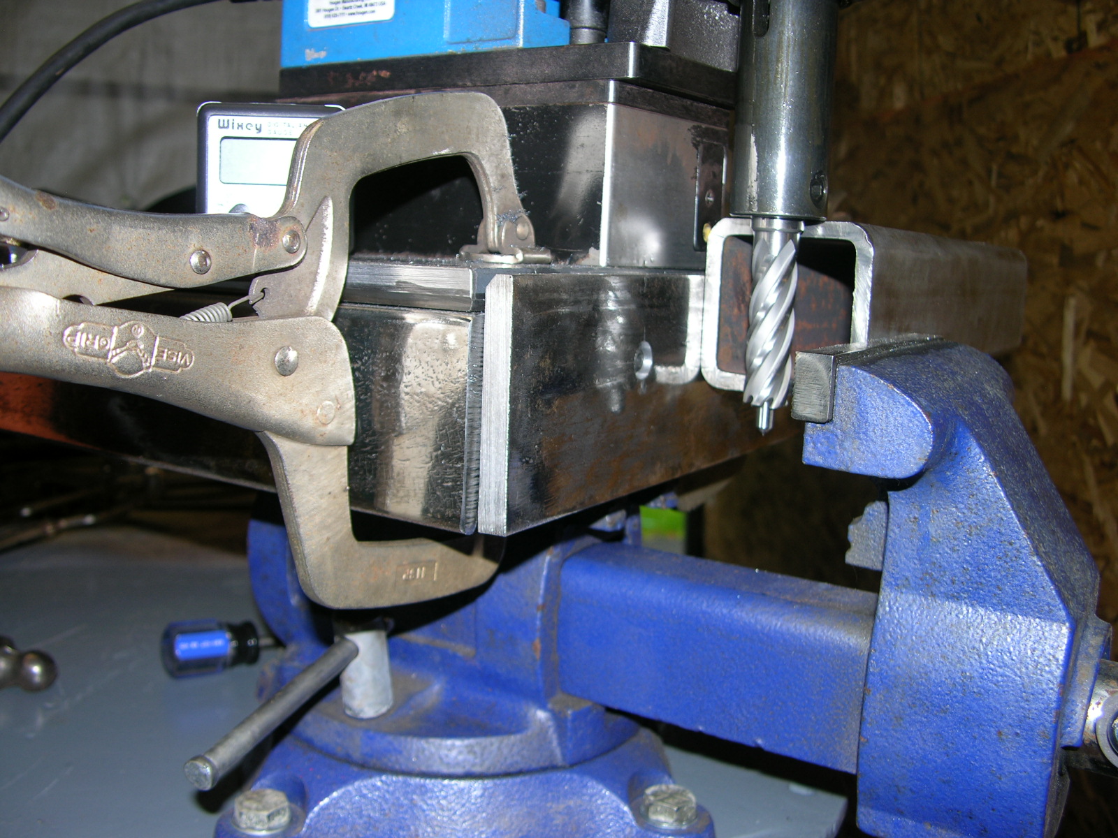

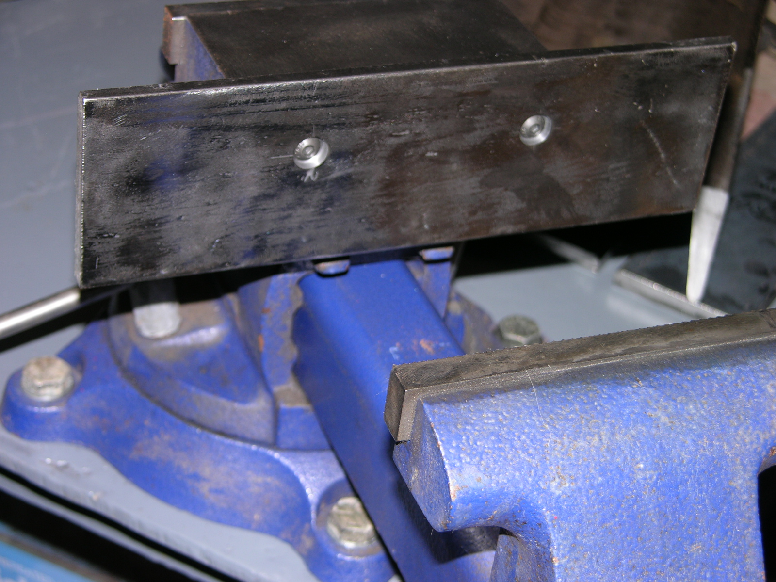

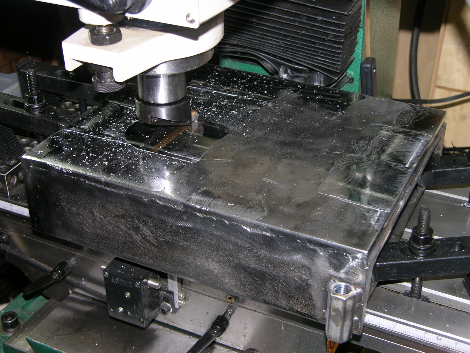

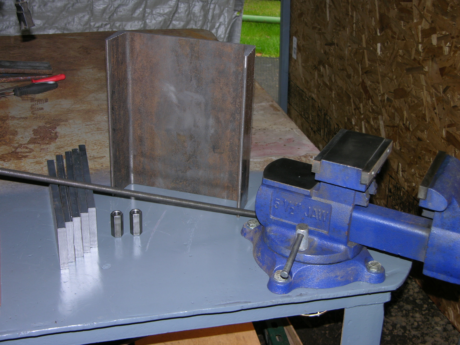

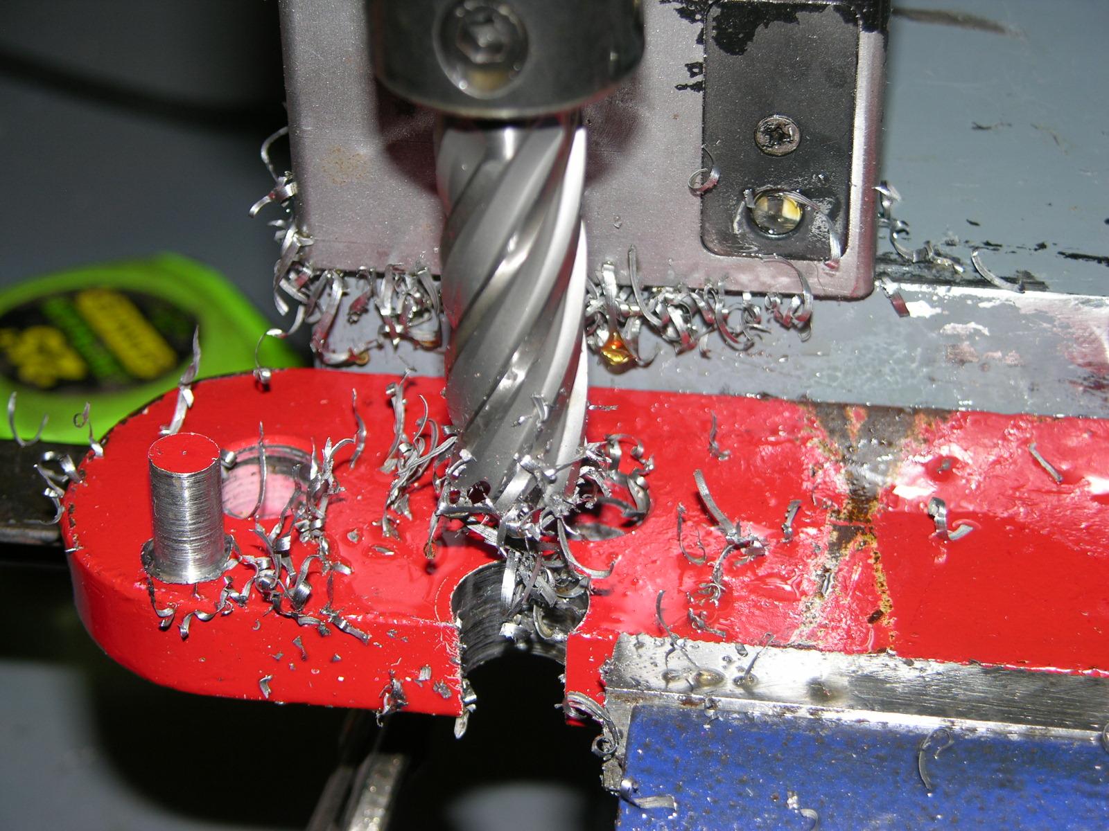

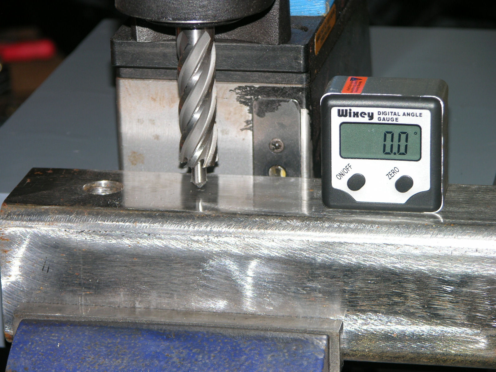

Found a little time, here's pics of the basic "MDVT" build - I didn't have any 1/2" PLATE at the time, so it's all 1/2x3 FB and 10" channel. Pics are named and (kinda) in build order. in order to make sure the mounting plate (replacement jaw) is perpendicular to the top I double-checked the channel end cut for true, then hard-clamped the jaw face to the channel and did multiple tacks before welding.
Then I knocked off excess weld on the top surface with a flap disk so it wouldn't tear up the fly cutter. Doing these steps makes it MUCH easier to get true holes in things that're clamped in the vise for drilling. There'll be a second post for the rest of the pics... Steve

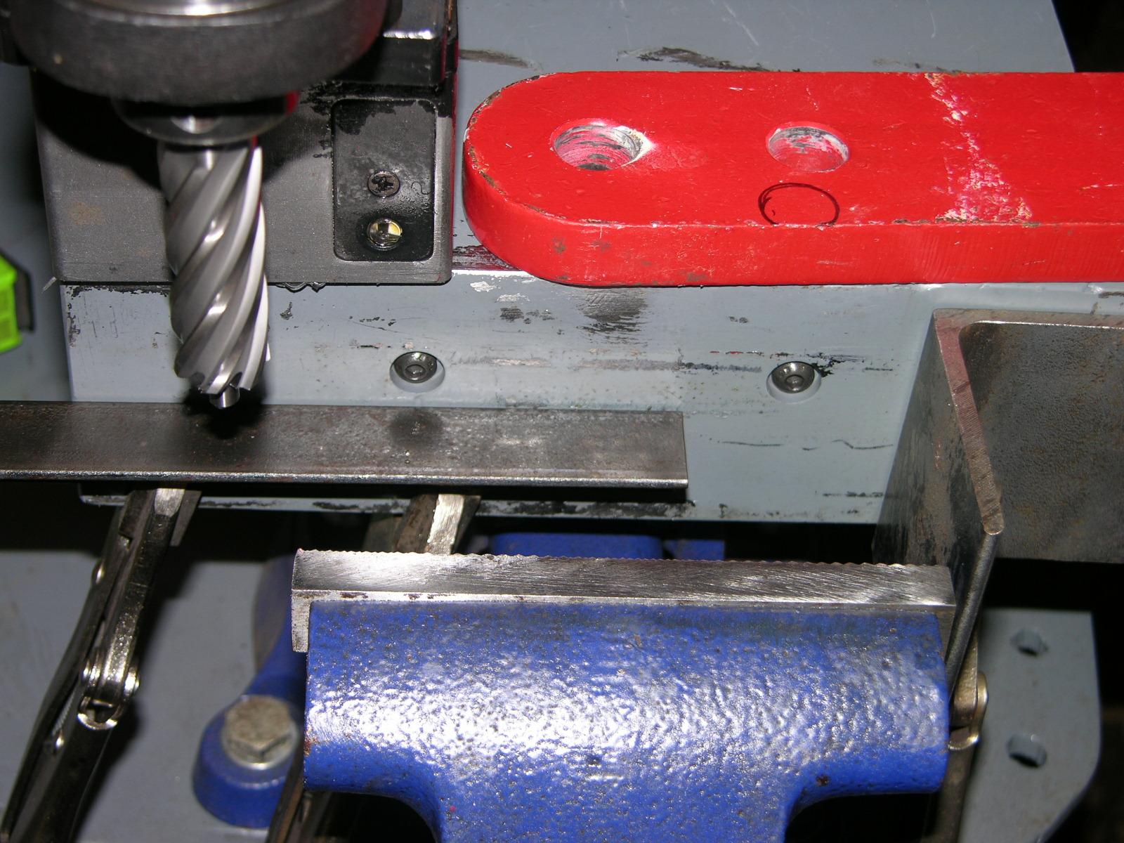

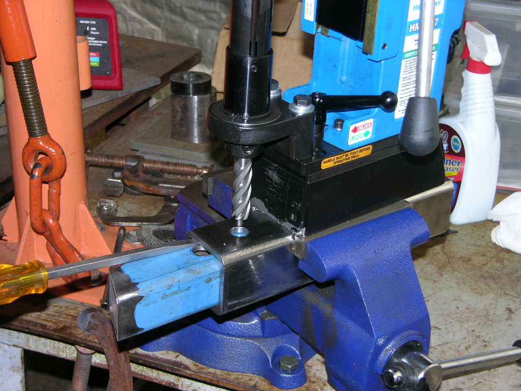

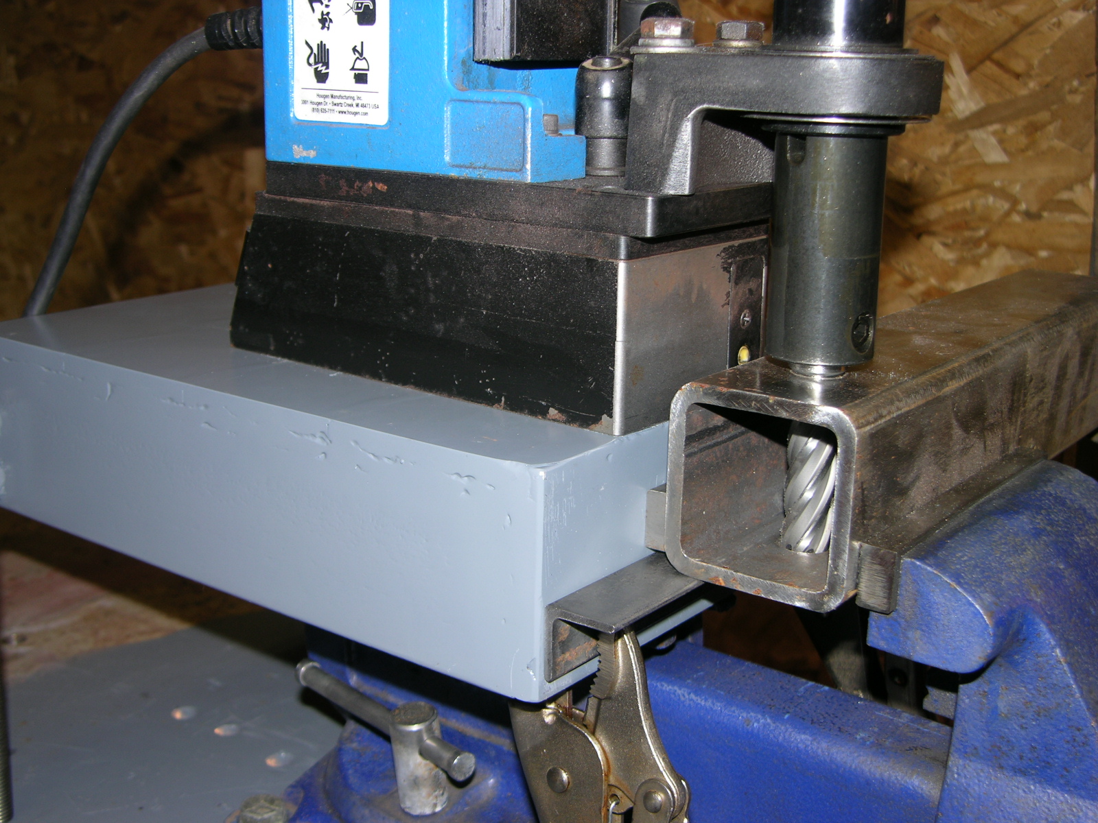

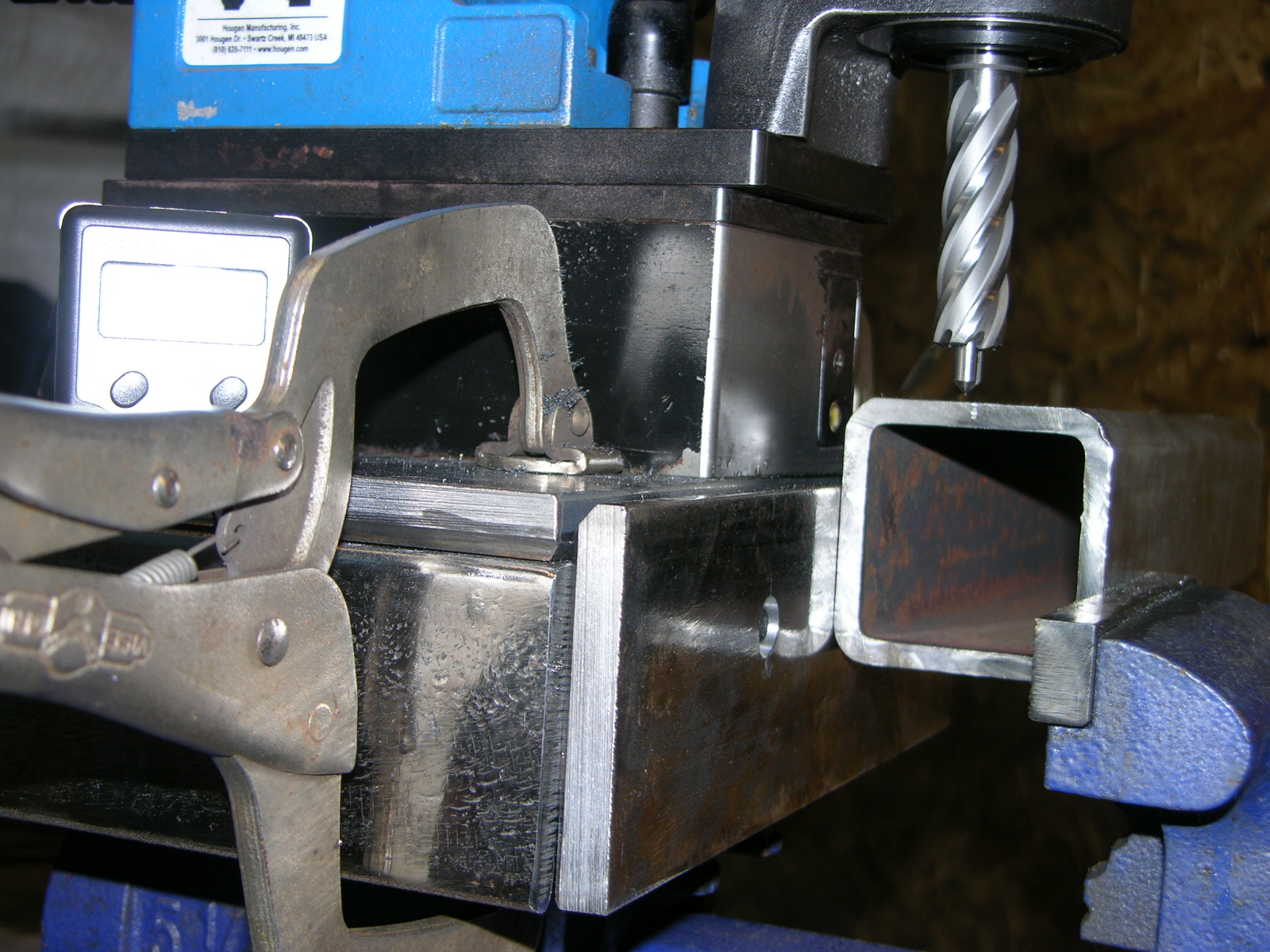

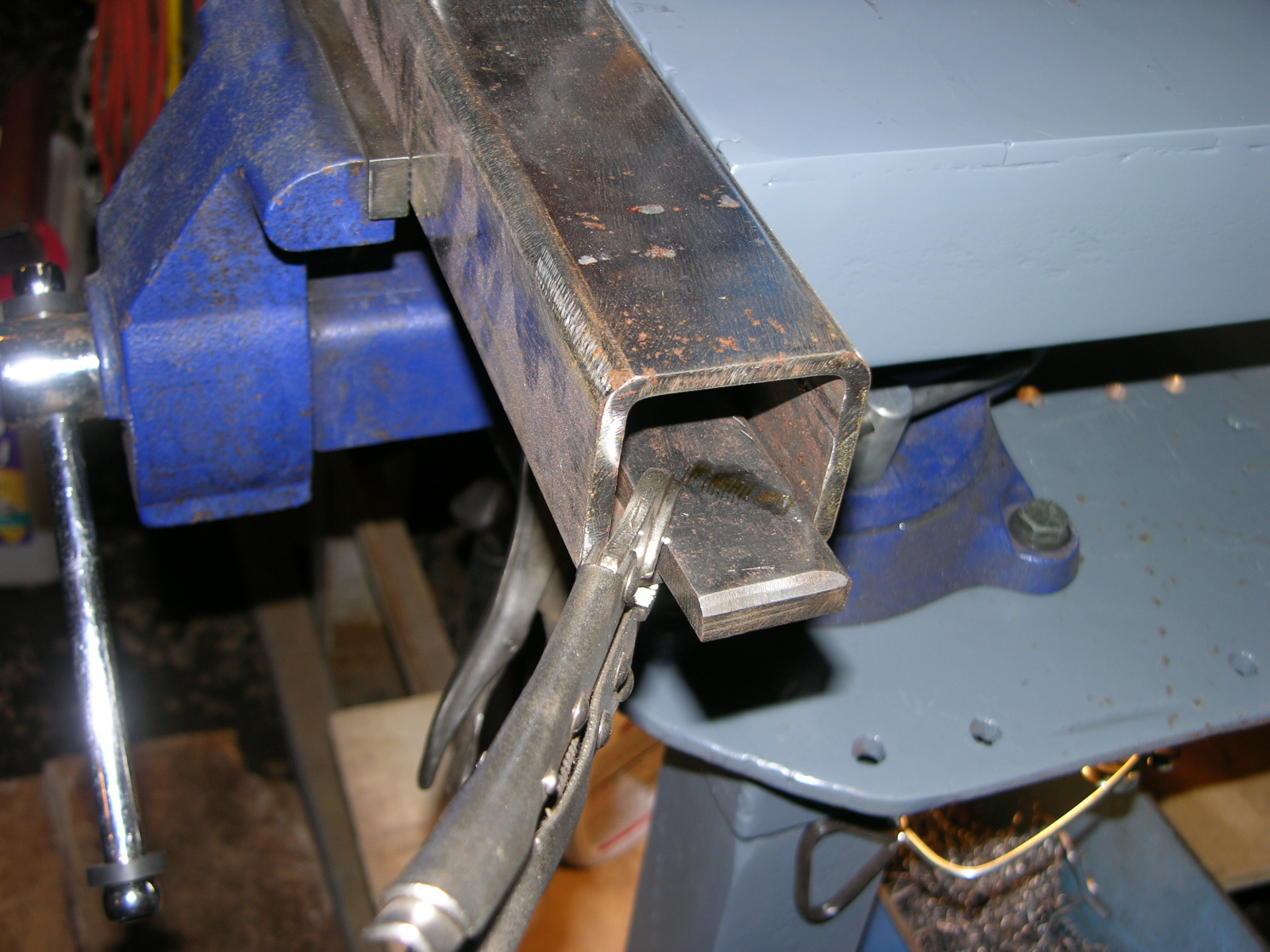

BTW, the ones with the partial hole in the red thingies was INTENTIONAL - necessary to defeat the FLOAT setting on my 6' Caroni flail. Also shows ways to drill multiple parts identically. The last TWO pics show using an internal stop for drilling multiple pieces of 2" tube EXACTLY the same distance from the end...

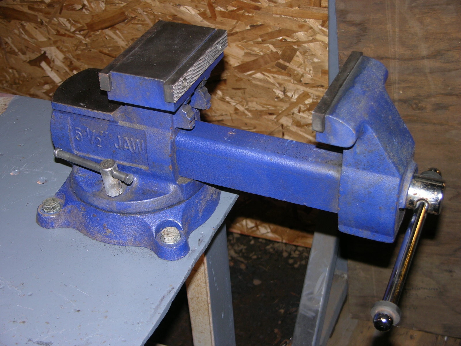

ANOTHER BTW - this is the vise I used
https://www.amazon.com/Wilton-14500...F8&qid=1545689289&sr=1-9&keywords=wilton+vise
NO particular reason other than I HAD it - also, you can get one for a few $ less if you're a previous ENCO customer registered at MSC.
Again, no reason any vise wouldn't work as long as you can remove the jaw insert... Steve

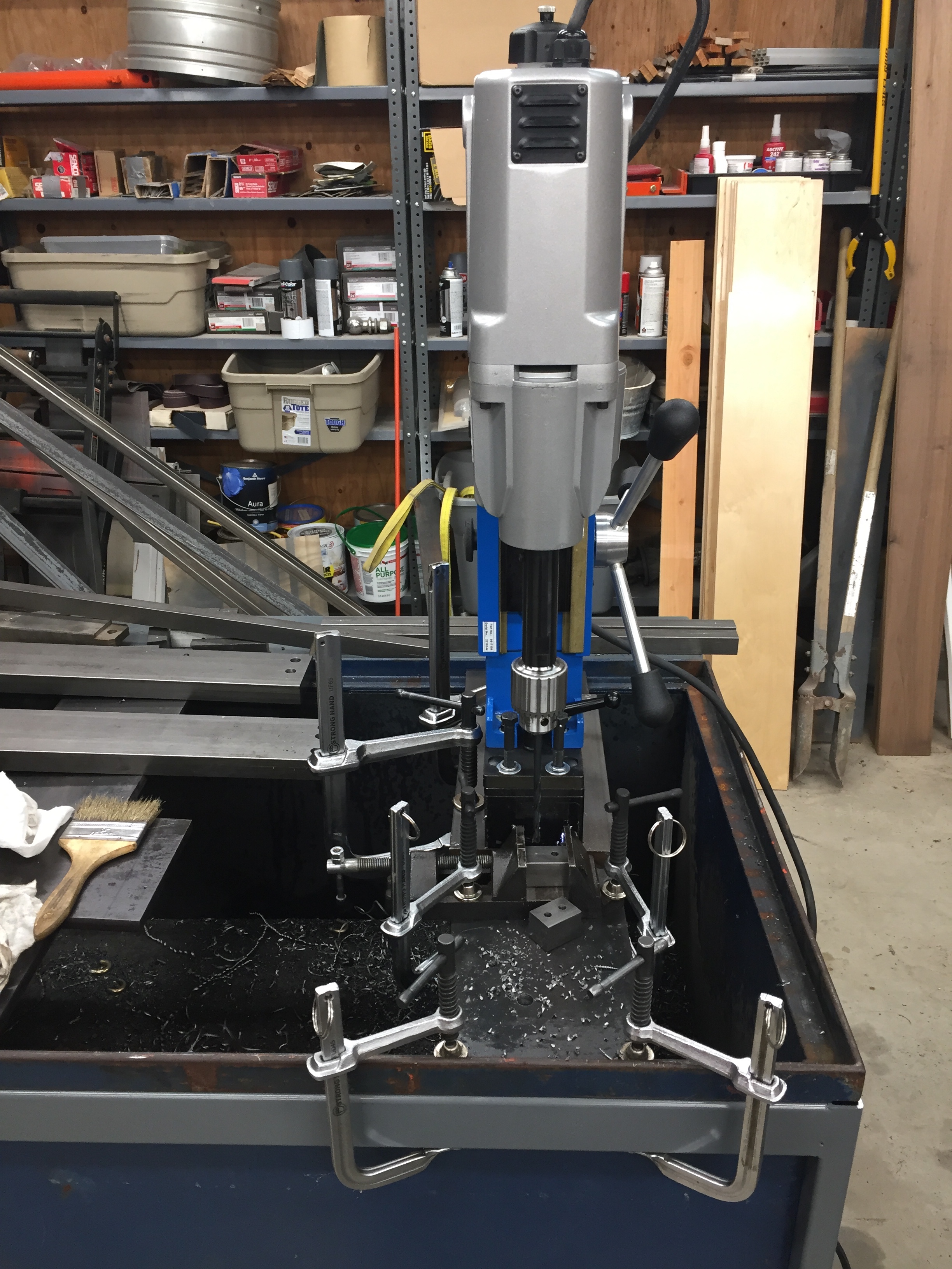

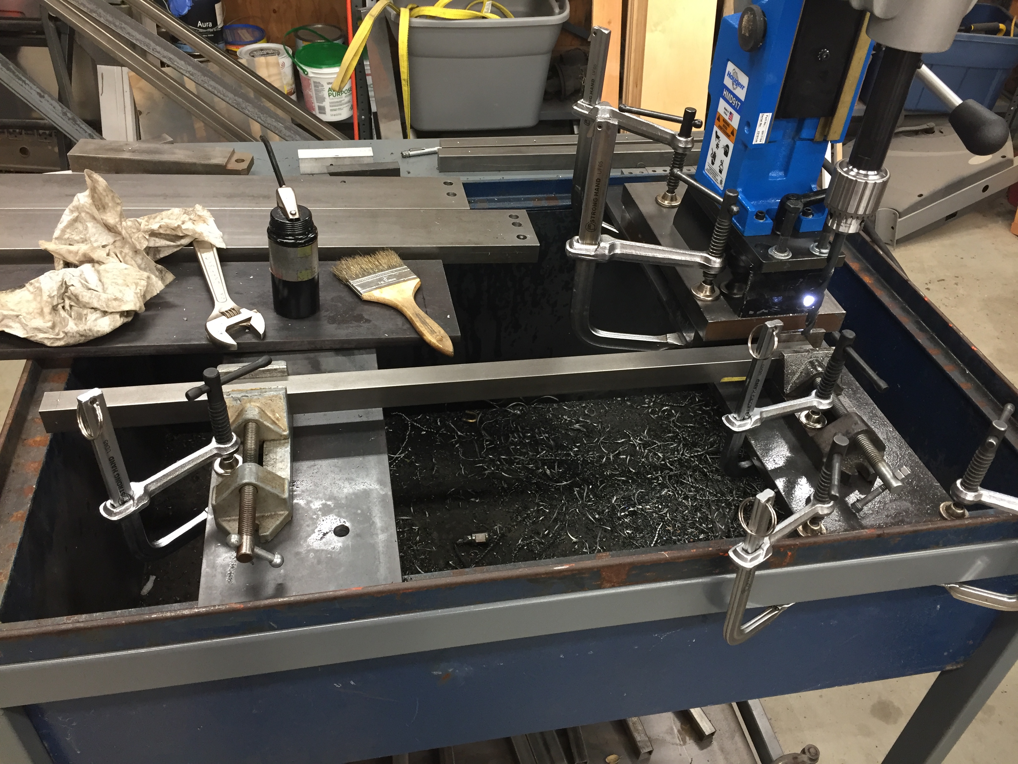

Got started making the drilling table for the mag drill. Immediately broke a cutter drilling a half inch hole through 1 inch bar. Expensive lesson. Drill lifted off the half inch plate it was magnet-ted to.
Photo 1, a thicket of clamps.
Photo 2, never thought of using parallel vises until I saw Steve's photo, works well.

Pat, if you have a decent drill press you should consider getting a 3/4” Weldon shank to further utilize your investment in annular cutters.
   / Convertible Cutting/Welding Table
#30
A very good question.
My two drill presses - a 70 year old Duro and a 70 year old Craftsman - do good work still, but are not up to annular cutters.
I got a Weldon adapter to fit my old Craftsman lathe, and have been using annular cutters with that, for which I have an original milling attachment to hold the work. That setup works pretty darn well. But.
I have been looking at drill press options. Here in northern California finding old American industrial iron is just about impossible. And I cannot bring myself to buy an expensive imported press. So I finally decided to spend the same money on the American-made Hougen mag drill, which has the power and sturdiness needed for annular cutters. This particular model also comes with a conversion to a standard chuck for twist drills, very handy.
I planned from the start to make a drilling table so it is as useful as a big old drill press. If I can make a table that is completely rigid and designed to minimize the hassle of positioning and clamping, I will be where I want to be.
