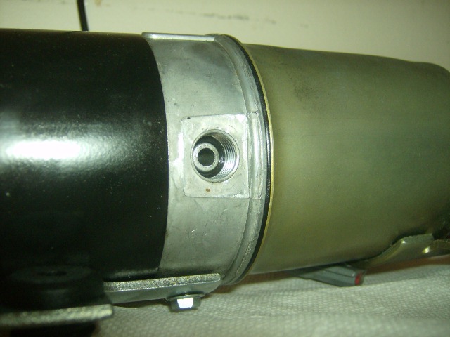

I just spend an hour searching the internet. What do they call those flared fittings that go on brake lines?
Here's a picture of the threads if it's helpful.
I've seen AN to NPT adapters, but the AN doesn't look right. I think it might be inverted flare, but there's very little out there about inverted flare fittings by that name.

Did the fitting look like these ?
If so, I've seen pre-made 4-5' straight ones at the auto parts store.

Just like that.
What I need is a way to get from that fitting to the 3/8" NPT on the cylinder cheaply enough that it can still classify as an experiment.
Surplus center has a bunch of SAE O-ring adapters. Does anyone know if these will work?
How would I determine the size I need?

Straight thread o-ring has an o-ring that goes over the threads, flat face o-ring has an o-ring that goes on the face of the fitting, between the flat faces of the male and female. O-ring adaptors will not work.
What you have is inverted flare. If you go to a Napa store, or search for Weatherhead distributors on the internet, go to the brass connector cabinet. Look for part # 252X..... This connects inverted flare to female pipe. You will need a short piece of brake line to go from your pump to this connector.

Thanks to the great advice from Wayne County Hose, I got the adapters I needed.
