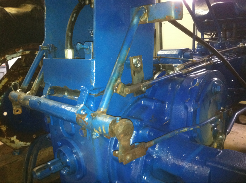

Well got another steering valve on ebay should be here anyday now. Still got to order relief valve and some misc. Fittings. In the mean time i been working welding some things up i just had tacked. I worked on my throttle had to change couple lil things on that. Orginal idea didnt have enough travel. I got the hand and foot throttle working. I also had to ditch my cable idea for clutch. I just built a linkage system. It also is now in working order. The brakes are also in working order now.

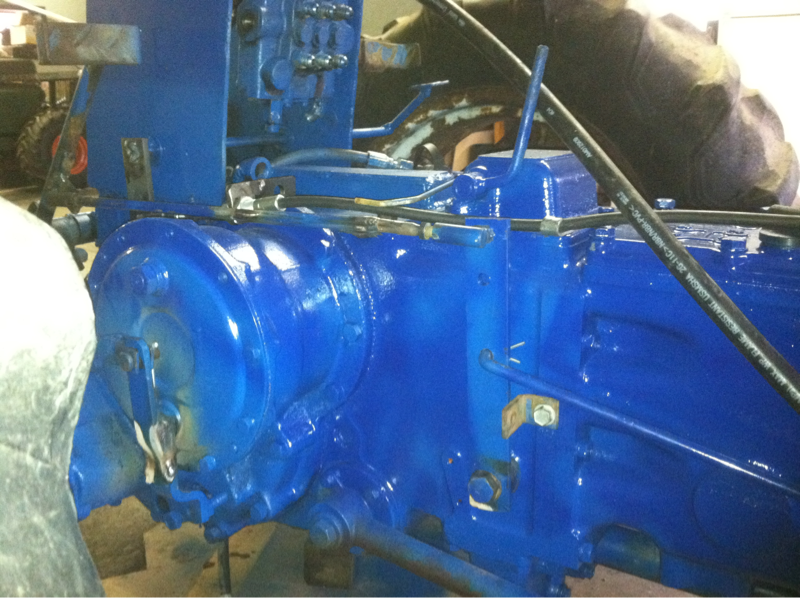

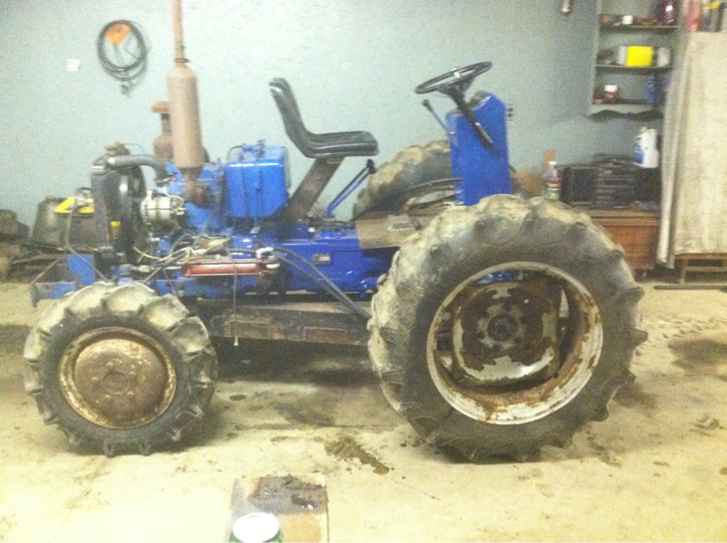

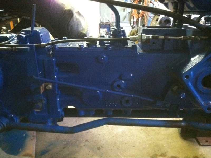

Ill get sum pics tonite i started paint some of it

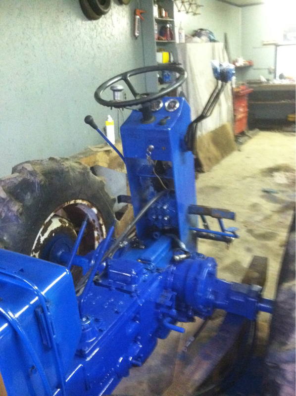

Well guys been busy with xmas and working on another tractor for a guy. But had some time tonight to mess around. I got the seat mounted up. I took quick route and made it simple and solid. Its non adjustable. I made it to fit me comfortable im bout 6' or tad under that. The seat is jus a little thing but i think it will work. I wasnt to concerned with suspension, dont plan riding it all day real fast.
   / Converting a ford 1700 into forklift #70
Wow! Its really coming along. Keep up the great work! :thumbsup:
