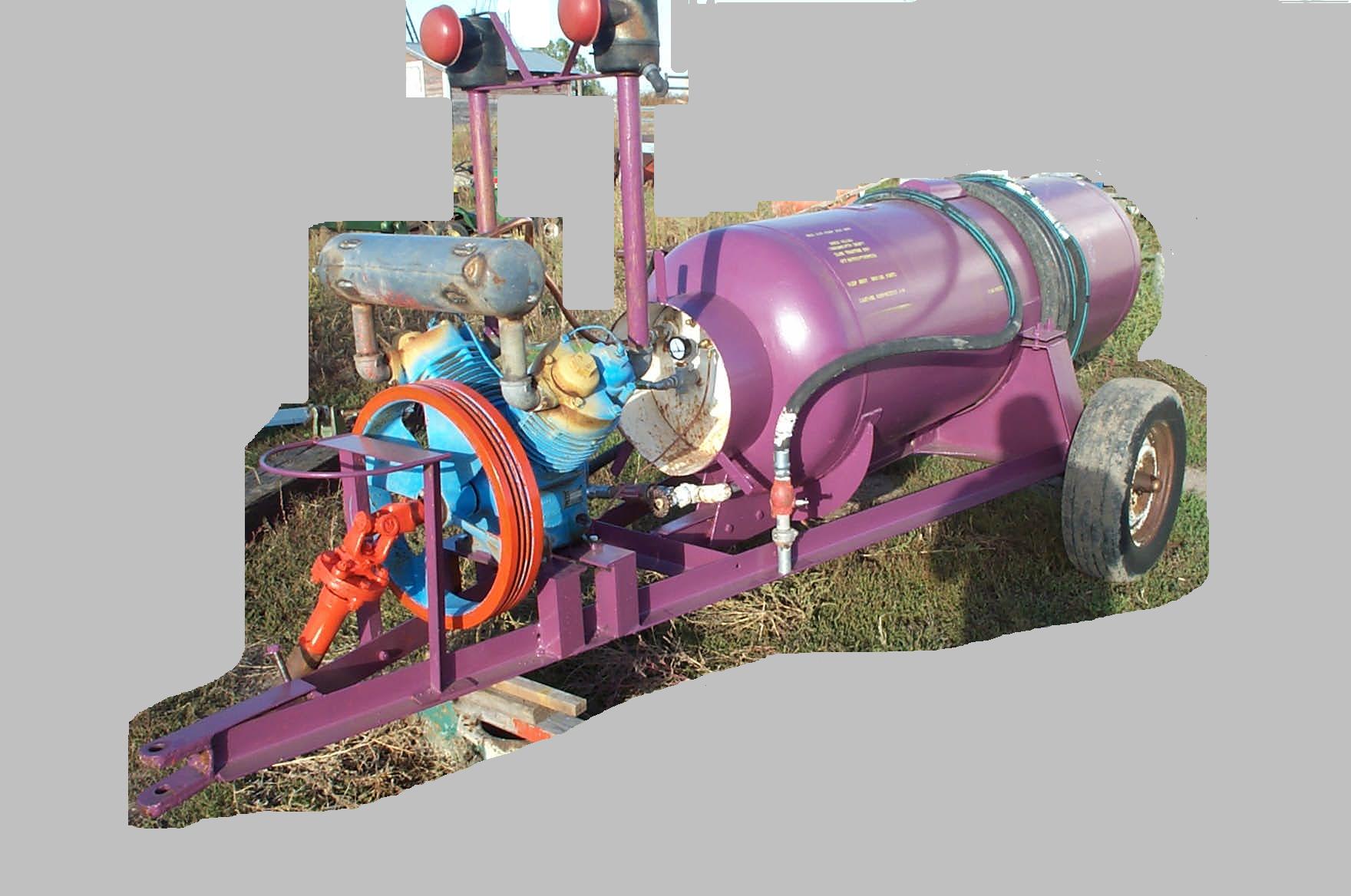

here is a picture of a little compressor I made, it uses a regular pump,
it uses what is called a unloader valve, (which is different than a pop off valve) the pop off will just dump air out of the tank down to a safe level, not nessarly at a minimal level it may be 100 or it could be 20 before it re seats,
the unloader is like a pressure switch but only dumps the air out of the compressor head, not the tank, there are number of different configurations for different valve types and so on, some work by holding a valve in the head open and some just dump the air coming out of the head, the second type is usually used on smaller pumps, if your compressor is stop starting very rapidly then a unloader is a good choice over a pressure switch or if you have a gas engine operating the pump,
