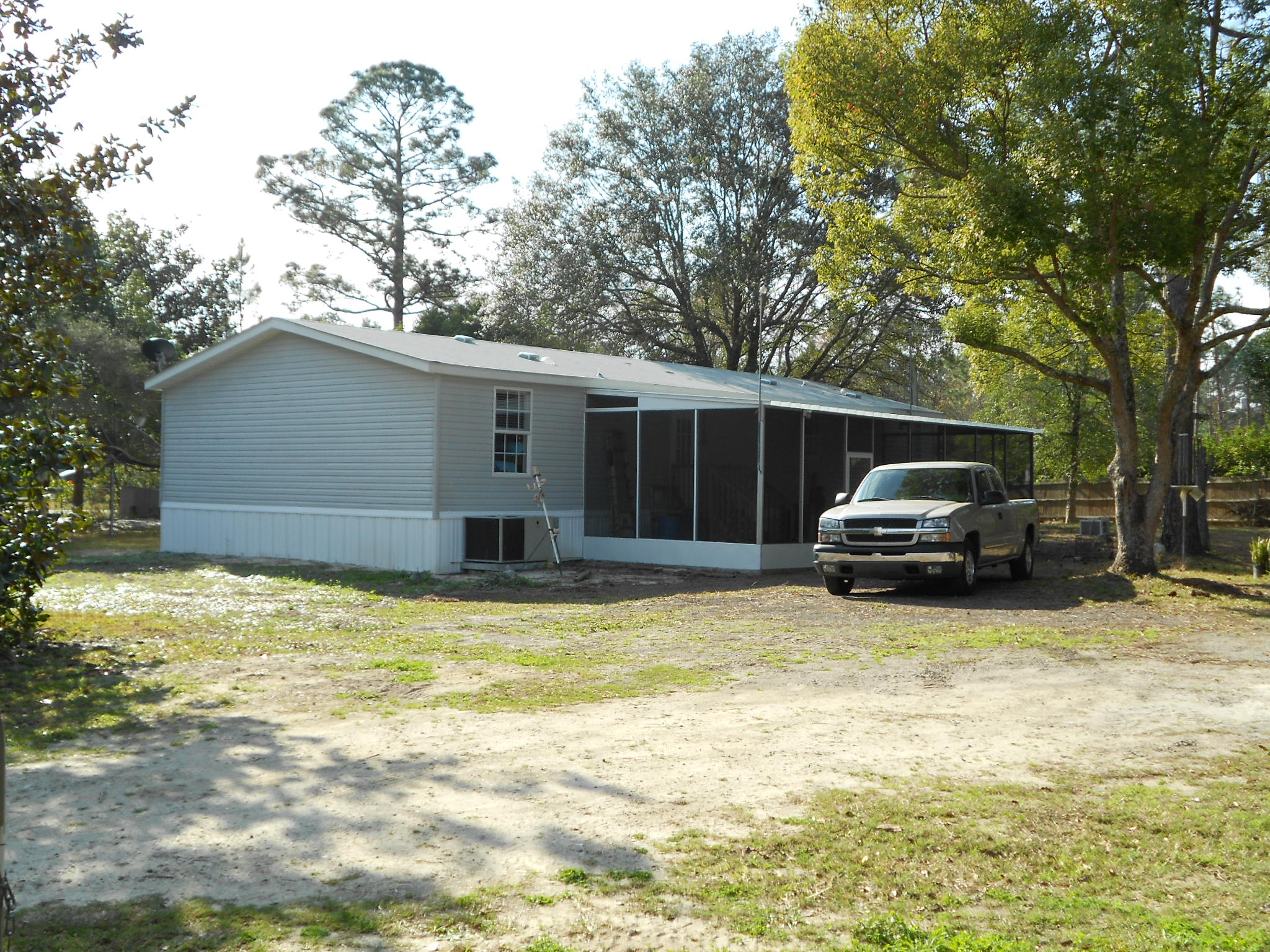

Stimw, not to hijack this thread but just curious as to what you are hauling on the trailer? Thanks, Stanley
Those are 1' X 14' aluminum roof panels ($2.35 a foot custom cut to order) for the 13' X 36' screen room I was installing. They interlock together when you install them.
Pic is finished screen room.
