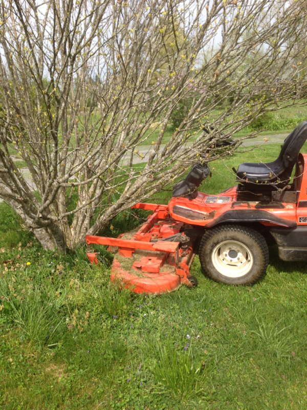

   / Converting belly mower to front mount? 72" on 4300 #7
The hookup is EXACTLY the same as the 72" deck running on the F-932 and F-935 front mount mowers. Two gauge wheels on the front of the mower set the front ride height and the tractor's front wheels set the rear ride height on the deck. Two extended arms push the mower deck along and can pick it up. You need to hang a front pto shaft and bearing (same setup as the front snowblower) because a shaft from the mid-pto to the deck is too long and will whip and self destruct at 2100 rpm and could also have some interference problems depending on what tires you use.
You could (theoretically) run it from a mount on the loader arms, but then would need a telescoping front pto shaft. Run the loader in float on the valve.
Once you have/get a front mower, nothing else will do. Start with looking at pics from an F-935, Its just two control arms, some beefier front gauge wheels and the extended drive shaft. If you run it from your mid-pto, no change in gearbox is needed. Some guys have run a front mower off of the rear 540 gearbox using an underbelly shaft and belt drive. That takes a gear set change withinin the same gearbox casting.
I've seen the front pto mounts, bearings and shaft in kits sold periodically on eBay, usually before snow season. Cleaning the deck and sharpening blades on a deck you can lift up in your face is just like they say sliced bread became.
   / Converting belly mower to front mount? 72" on 4300 #8
Here's the copycat setup. The two Y-type control arms fit into some square tubing that can be hinged off of the frame mounts from your current MMM setup. Depending on your tractors size, you might just need aspecial lengthened 2100 rpm pto shaft to make it work. I bought two extra control arms (used) off of ebay a few years ago. They show up all the time, too. Same arms for the 60" deck, too.

   / Converting belly mower to front mount? 72" on 4300 #9
Here's my front mount mower. Upon further review you guys are right about the PTO shaft. No modifications needed assuming the front and mid PTO turn at the same RPM.
