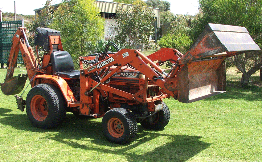

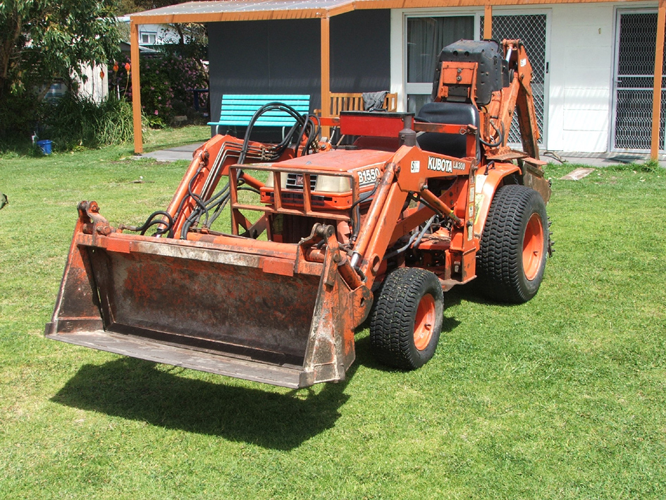

Would it be possible for you to post some closeup photos of your 4in1 on the B1550?

npalen.... The B1550 is 300 ks away at the moment so these old photos are the best I can do for now. The 4in1 is simply invaluable as far as I am concerned, but everyones circumstances are different. It is exceptionally heavy though, so a hefty weight on the back is essential. Fortunately the backhoe serves that purpose.

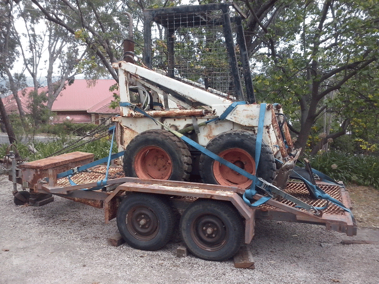

Start a thread about your Bobcat rebuild, especially the bucket portion. Thanks in advance!!!
ovrszd... The Bobcat is an old 610. I've described some of the project on 'skidsteerforum'. I got a bobcat+trailer package deal:laughing:. I did also get a bucket with it but thats not in the pic. The Bobcat is completely dismantled at the moment. I've repaired axles and seals, hydraulic control block, and I'm just reassembling the Wisconsin VH4D engine after having it rebored 40 thou oversize. Next big job is painting the frame so I can start putting it back together. The bucket conversion project is probably quite a few months away but I will give details if it happens.
