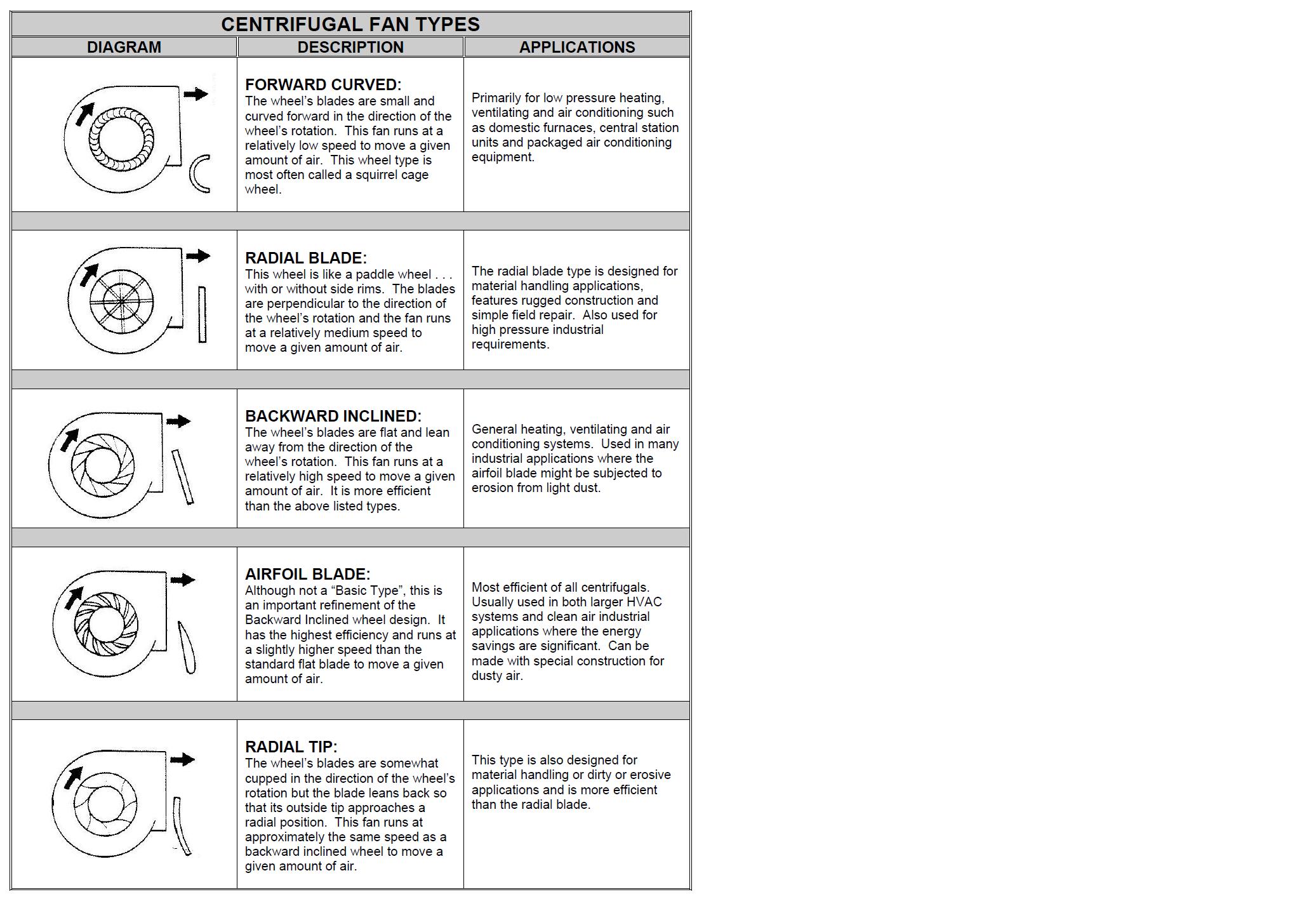

Well I would say the clue is in the casing. According to Merriam Webster, "In centrifugal or axial flow fans, air is led through an inlet port to the center, or eye, of the impeller, which forces it radially outward into the volute, or spiral, casing from which it flows to a discharge chute." If you can envision the air path making it's way through the spiral casing, it can only go one way to blow out the the discharge chute effectively. Maybe the pic will help.

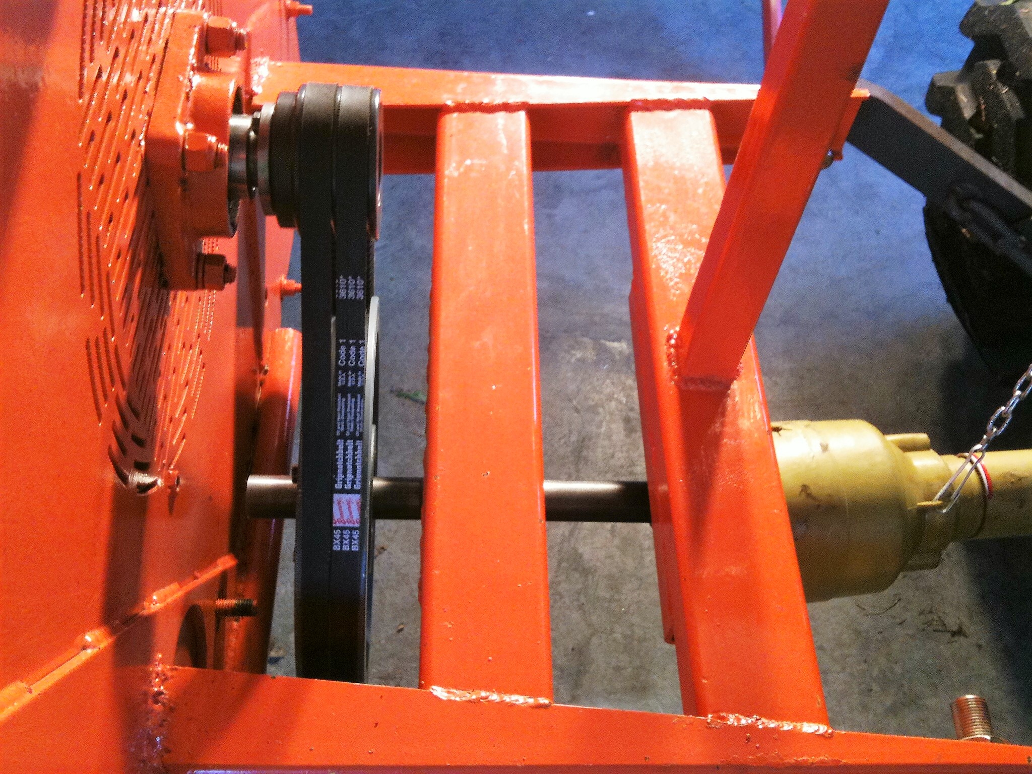

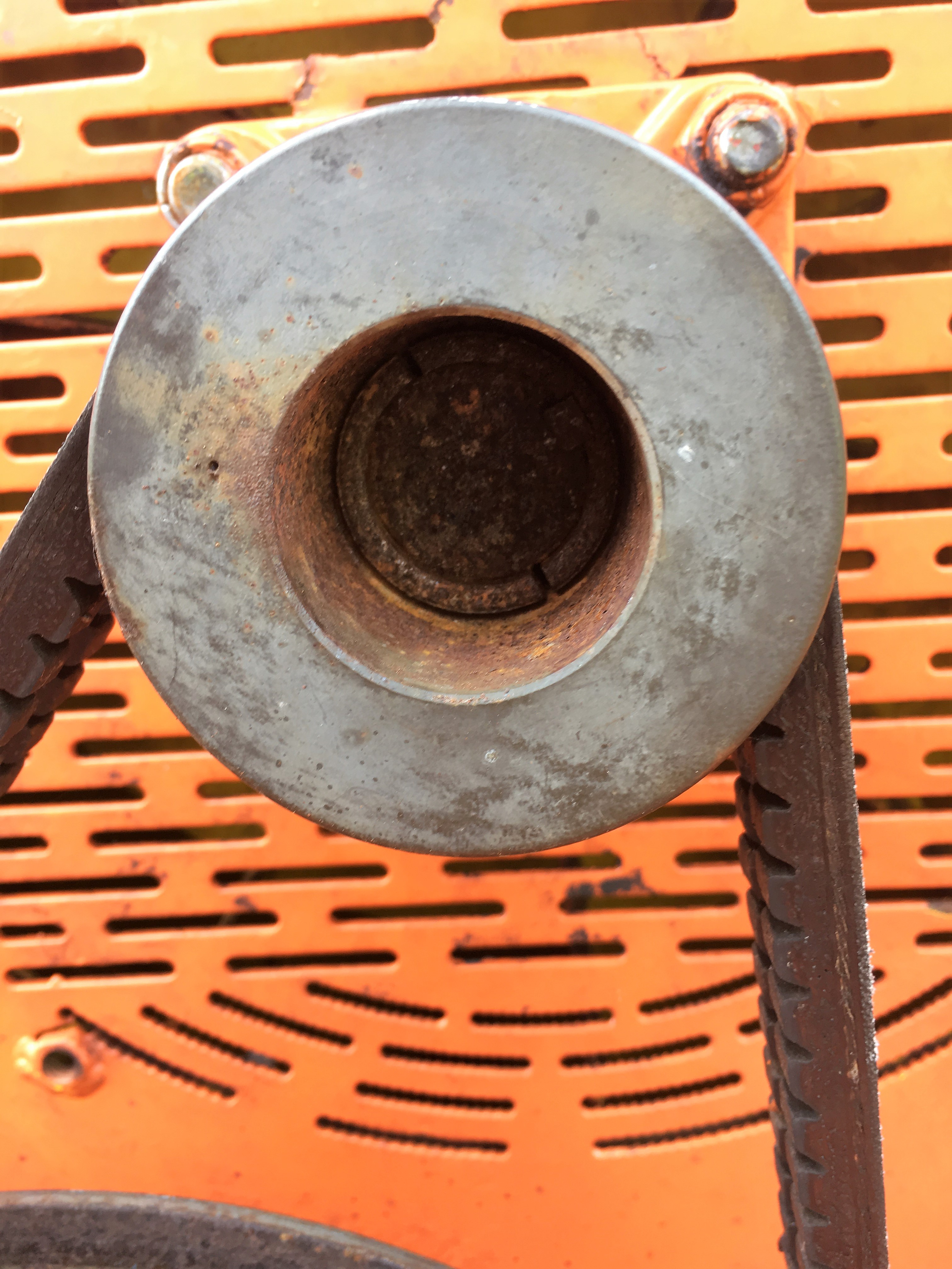

Great post! I am converting one now. I'm following your build. However I have a question. How did you attach the smaller pulley to the 1-3/8" shaft. The hub doesn't reach the shaft.
Thx John
@John - I just pulled the blower out of the woods and cleaned it up yesterday so your PM was timely. While it's been many years since the blower build, I can tell you that the small pulley I used on the fan shaft has worked perfectly in spite of what appears to be limited grip. I mounted the smaller pulley split hub in standard (rather than reverse) orientation with as much grip as possible and you can see in the one attached pic where the fan shaft is only very slightly shorter than the split hub. It was solid and has never wobbled under belt tension and years of use. After some under the tarp 'seasoning', that sucker looks to be rusted on pretty solid now lol.
To all folks who found inspiration in this thread and converted a big blower, please post up a few words and pics showing your completed project. We all love pics!

Thx for the recent pics. I did the same thing today. I put it on in reverse. I was wondering if it will hold up.i guess it will tomorrow I hope to finish it up. I'll post some pics thank you for your reply.
