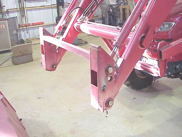

I converted my Mahindra bucket to a quick detach. Makes it a lot easier to change loader attachments. I also built a forklift attachment to use on the loader. Since converting mine I have had several request from neighbors to convert theres. Have converted one JD for a friend. I cut the mounting flanges off my bucket and used them for the loader mounts. I then fabed some hooks out of 1/4 inch x 3 inch plate for the top hooks and welded pins at the bottom to fasten the mounts to the bucket. I have some pics if your interested.

Here is the first pic. They are not the best. You can see that after cutting the mounts off the bucket, that I welded some plate between them and at the top I put a piece of one inch round stock.

Here is a pic of the front of the set up with out the bucket attached

Pic of bucket
