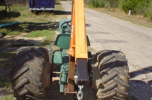

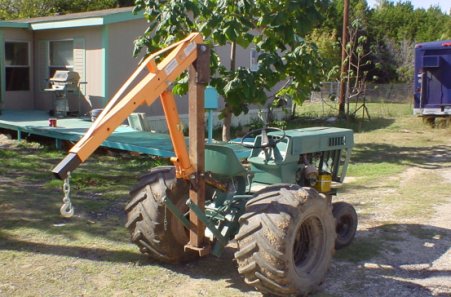

cleatus, i see the photo on you profile, the green tractor with the crane off the back. im guessing it us removable as you put over things on the tractor (i presume it is the same tractor /forums/images/graemlins/blush.gif)
i was wondering how the crane is attached at the bottom to the tractor, you have inspired me to make a thing to get my crane on the back of a tractor
thanks
   / Converting manual 3ph to hydraulic
#14
Mirth, the bottom of 3ph has a piece of 6" channel 6" long sticking out like a trailer hitch. This has 2- 1/2" holes that the bolts welded into the bottom of the 3x3 riser. I then added an ear to riser to hook up top link.
HOpe this helps.
#15
Mith, Maby this will help.
#16
And this.
   / Converting manual 3ph to hydraulic #17
i think i got it
thats another project to add to the list
thanks
