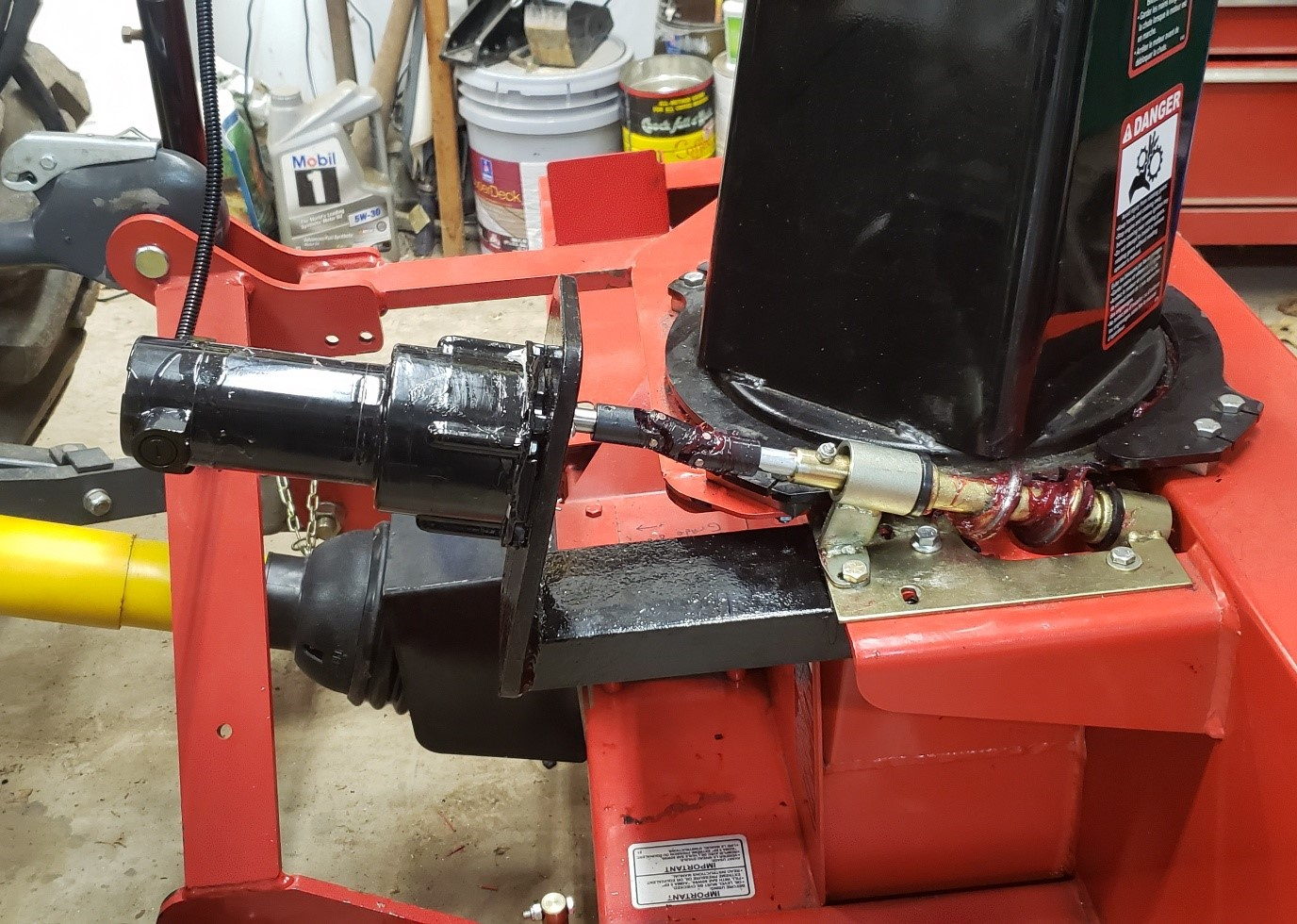

The chute: I simply disconnected the manual crank arm right at the worm gear connector and removed it. A friend of mine welded up a bracket for mounting the motor to. A double universal joint was used between the motor shaft and short piece of 1/2" steel rod connecting to the worm gear. The motor was found on Ebay, 1/17hp 45rpm at shaft. It takes about 9 seconds to rotate 180 degrees. In use I'm usually only rotating much less than that.

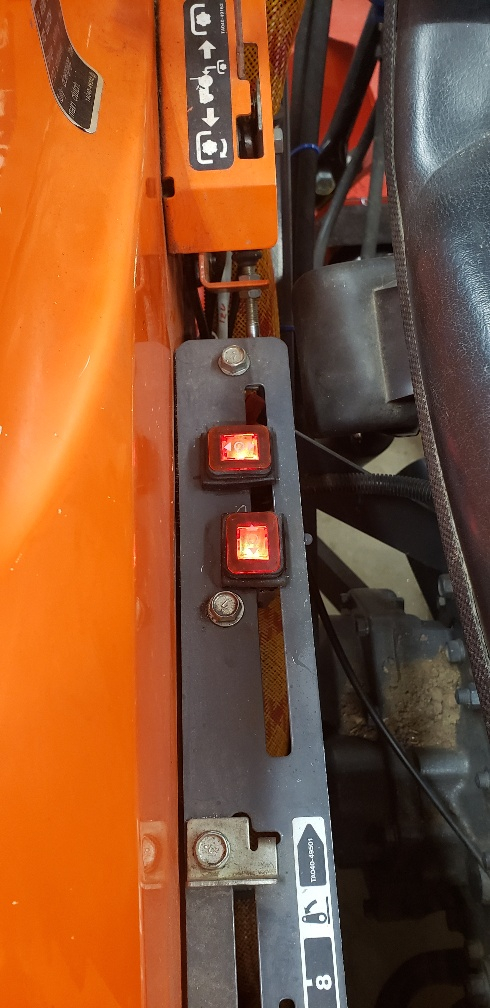

I used a weatherproof, dpdt, center off lighted switch mounted in the empty draft control slot. Later on for the deflector I added a second switch below it.

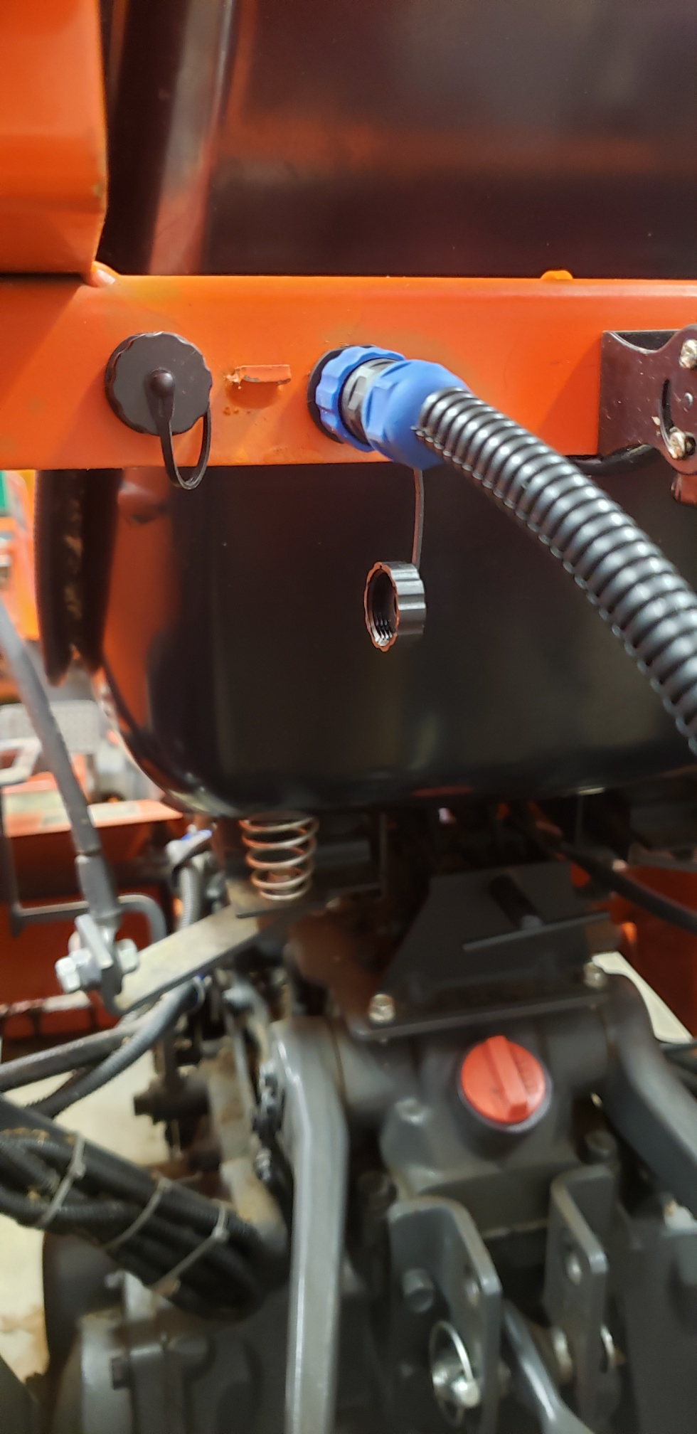

I had previously installed a small fuse block on the inside of the right fender so power was readily available. The angle bracket that goes between the ROPS and used to support the small toolbox was a convenient place to mount 2 waterproof connectors.
Split loom was used to protect the exposed wiring.

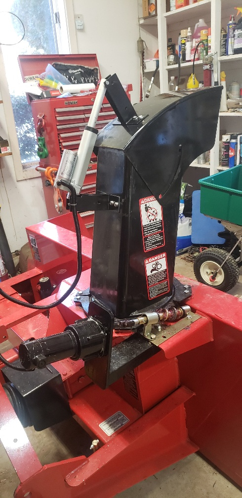

The deflector was really easy to convert. There are many Youtube videos showing electric linear actuators mounted on the side of the chute to push up the deflector. I just couldn't get comfortable with exerting the force just on one side. I'm sure it works based on the number of people doing it but I decided to go a different route.
The actuator is rated at 220lbs (more than needed), has a 4" stroke and has built in nonadjustable limit switches. It was perfect. There are 2 pairs of stainless steel 5" X 3" angles that were used - the 3" 'feet' were cut back to 2" and I had to grind an angle into the lower pair so the actuator could tilt forward.

Very nice setup. The only change I could suggest would be to turn the actuator upside down to lessen the chance of water getting past the shaft seals and causing future problems.

I have seen that recommendation before. The actuator is rated for wet operation, not immersion. To me that pretty much means keep it dry. That said I never blow snow in the rain :) However I have heard that snow can turn to water given the right conditions :)
Initially I thought I would have to make the mounting brackets longer if I reversed it. Looks like it will clear if I flip it but will have to lengthen the wire a few inches.
Since I'm on to another project (putting in a dedicated garage door rec/xmtr for the tractor) it will have to wait until the next storm. I'll see if it really gets wet and change it then.

No, I don't believe it is. On the topic of moisture contamination of the linear actuator, I do not blow snow when its raining either, but after finishing snow clearing, the ram was almost always wet. Now that it is inverted, the ram still gets wet, but not at the seal where the ram retracts into the actuator. You could be right that it would never be a problem, but why tempt fate.

I've used similar actuators for years. I take 07wingnut's advice and mount it with the cylinder down. They are not waterproof worth a hoot no matter what the ISP is.
