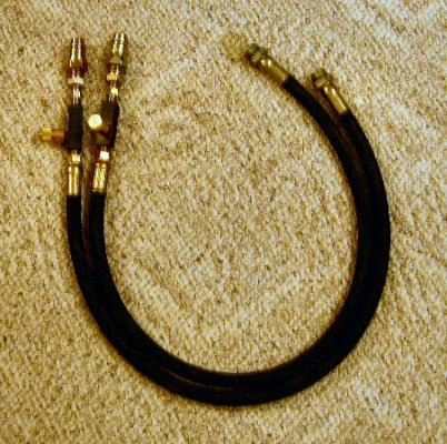

Today the hydraulic hoses and flow valves were delivered via UPS. First we took care of the important stuff (dinner) then we strolled on out to the pole barn after the chow. This is the way the hose/valve assemblies look loosely assembled.

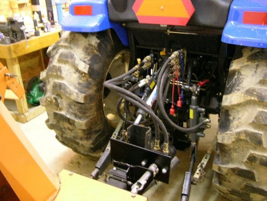

Shot of the attachment point, quick couplers and adjustable flow control valves.

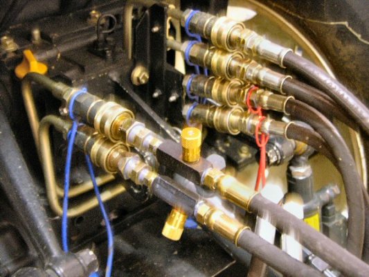

This is a better close-up shot of the two adjustable flow control valves.

   / Converting manual snowblower chute to hydraulic #24
Pineridge,
Nice project. Can't wait to hear how that motor works.
I must say I am a bit shocked at seeing all those quick disconnects where they are! Only because when I put mine in a similar position (well not all, but four of them) I discovered that when I tilted my 3PH, the top link cylinder, since it shifts left and right with tilt, wanted to push the disconnects out of the way. So I had to move them to a different location... /forums/images/graemlins/blush.gif
Your project looks great! Keep the progress reports coming!

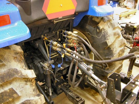

This shot is basically just from another angle showing the completed project.
Once we fired up the New Holland and bled the air from the hydraulic lines the chute started to move but it was way to fast to suit us. We started throttling the two flow control vales down and we are very pleased to report that we can make the chute travel at any speed that we need. From a crawl to flat out spinning. /forums/images/graemlins/grin.gif
We also deliberately ran the hydraulic motor past the travel of the snowblower chute rotation and our make shift clutch seemed to perform just as we expected. It is also very easy to tighten down on the stainless clamps to prevent any slipping but we think in this case a little is better in the extreme ends of the travel than none at all.
We really do not see any foreseeable problems since we have the rotation adjusted where it is easily controlled by one of our 3 rear remotes. We hope this project helps any of you that may be thinking of adding hydraulic assist to your own snowblower. We are also sure that you can pick up the majority of your materials from eBay and some of the other discount suppliers that we mentioned in our earlier posts and still save a few dollars in the process.

Henro thanks for the compliement. We were really expecting problems with the motor but that never materialized. the process was smooth from start to finish, I even surprized myself. /forums/images/graemlins/blush.gif
The arrangement of the quick connects is stock for New Holland's 35 through 45 HP ranges on the Class IIIs. The only time we experienced any problems was when our T&T hoses were 60" as they were always getting tangled in everything and anything. We have had no problems since we had them shortended to the proper lengths.
