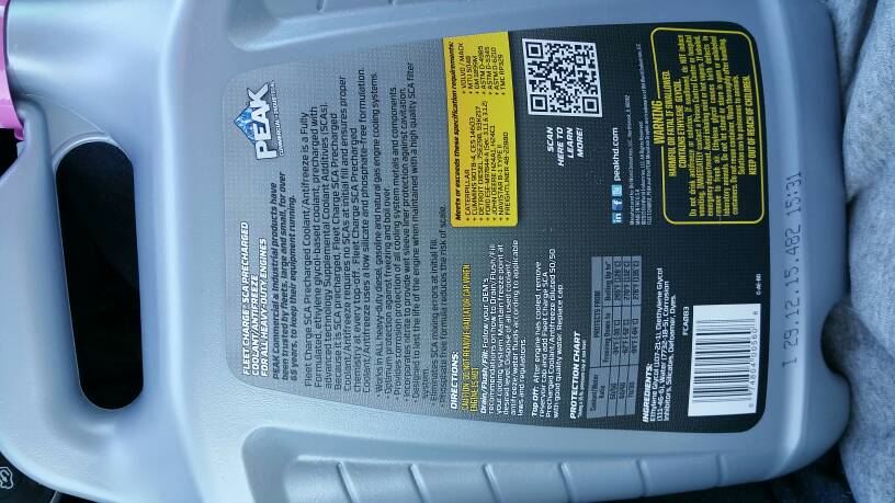

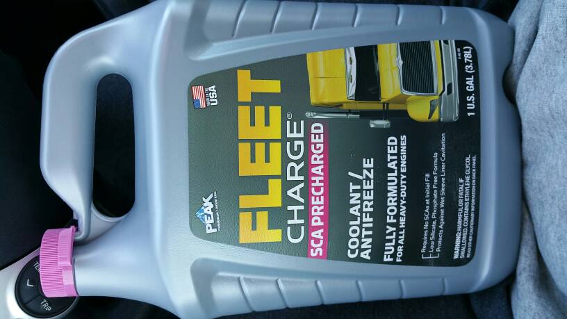

Will this work in my 4035? I don't want to use the wrong stuff... Thanks

Jan 30, 2016 / Coolant for 4035 #2 davesl708 Elite Member Joined Dec 13, 2014 Messages 3,500 Location Shawnee, KS, USA Tractor Kubota BX2200D, What color anti-freeze is in it now?
Jan 30, 2016 / Coolant for 4035 Thread Starter #3 OP justinramani Gold Member Joined Apr 4, 2015 Messages 442 Location North Carolina Tractor Mahindra 4035 The current anti-freeze looks blue
Jan 30, 2016 / Coolant for 4035 Thread Starter #4 OP justinramani Gold Member Joined Apr 4, 2015 Messages 442 Location North Carolina Tractor Mahindra 4035 Now that I think about it, it may be a green color. Hard for me to see some colors.
Jan 30, 2016 / Coolant for 4035 #5 davesl708 Elite Member Joined Dec 13, 2014 Messages 3,500 Location Shawnee, KS, USA Tractor Kubota BX2200D, Colors are for different metals and gaskets. The jug you show looks like it should be compatible with all engine types.

Jan 30, 2016 / Coolant for 4035 Thread Starter #6 OP justinramani Gold Member Joined Apr 4, 2015 Messages 442 Location North Carolina Tractor Mahindra 4035 Is it ok to mix different colors/brands?
Jan 30, 2016 / Coolant for 4035 #7 davesl708 Elite Member Joined Dec 13, 2014 Messages 3,500 Location Shawnee, KS, USA Tractor Kubota BX2200D, I would not mix. Some of the ingredients may not play well with others.
Feb 1, 2016 / Coolant for 4035 #8 N Navasot Veteran Member Joined Nov 7, 2014 Messages 1,498 Location Texas Tractor Mahindra No do not mix colors.
Feb 2, 2016 / Coolant for 4035 #9 K ktmhans Member Joined Aug 17, 2010 Messages 47 Tractor Mahindra 4035 pst If its green put in green nothing else. Be happy green is the cheapest
Feb 2, 2016 / Coolant for 4035 #10 J Jabonee Platinum Member Joined Sep 21, 2015 Messages 908 Location Pennsylvania Tractor Mahindra justinramani said: The current anti-freeze looks blue Click to expand... Might be "PG" it looks blue or purple. Definitely do not mix with "EG" (green):thumbsup:
