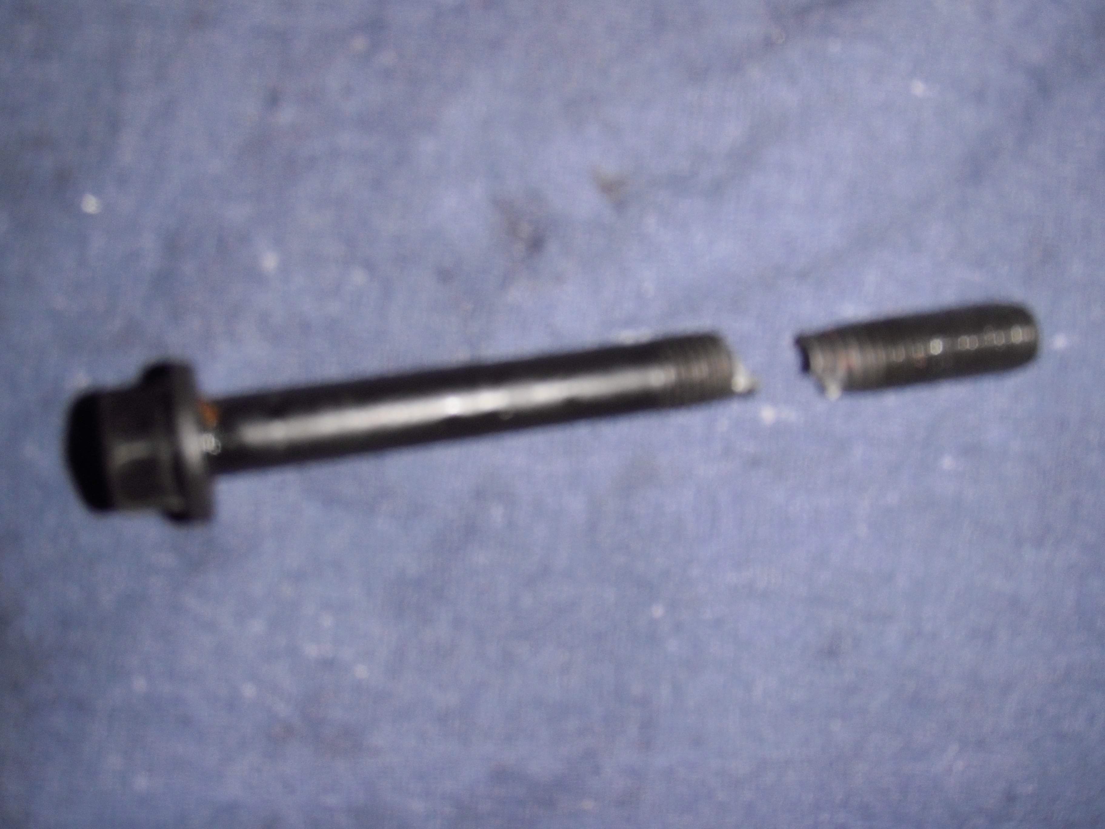

I put my new head gasket in today. I torqued it down to 60 ft/lb (spec is 57 - 61.5 ft/lb). I set the valve clearance and cranked it up for the 30 minute break in run. After 30 minutes as prescribed I retorqued. All 14 of the head bolts required a small amount of retightening. On bolt 14 it popped like a piece of glass. I had to diaasemble to remove the broken piece from the block.
My advice from here on...replace the head bolts when replacing the head gasket on the CK25.
I ordered a new gasket ($41) and 14 head bolts ($3.80/ea). Will try again soon.

If it popped at 61 lbs.. the bolt was already fatigued... By the pic, it looks as though it seperated just about where the parting line is between the block and head. Thats a common place for a bolt to give up. The threads may look fine where they are engaged into the mating threads of the block. Sometimes you can use a 0-1 inch micrometer and actually see the deformation of the bolt. I'm surprised that the repair manual didn't give a maximum tolerance for the length for the bolts. Usually if a bolt is at or near the overall length its junk and should be disposed of.
If it doesn't seal down and stay this time, I would consider calling an ARP dealer and getting a stud kit.

With a clear head, I would have seen that the bolt snapped in the head and not the block. I assumed it snapped in the block and would require a drill and easy-out. In hindsight I could have found a wooden dowel or tree branch the correct diameter and length. With this I could have tapped it with a hammer to imbed it onto the broken stud and unscrewed it. It was not tight in the block, it easily unscrewed and it stuck up at least a 1/2" and the break was not flush and smooth but very jagged. I could have saved a head gasket and some time. I would have replaced just this bolt. But in hindsight this bolt didn't feel like the other 13 during torqueing and I should have removed it to inspect it before it broke. After it broke I was trying to think of someone I new who was mechanically inclined to call and just think through with my thoughts and I couldn't think of anyone I wouldn't be imposing on. So I went with my gut to rip it all apart and start over. My advice to you is be more patient than me and let the helpful folks on this site help you think it through.
