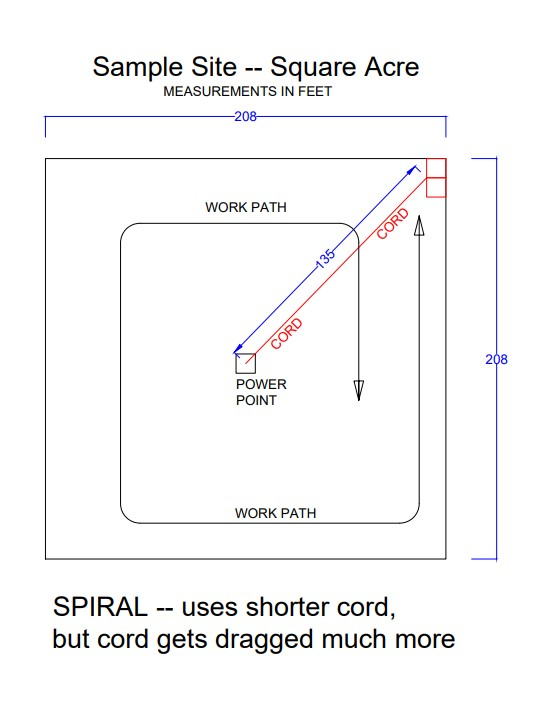

I suppose most here are familiar with various designs using batteries. However, these have some limitations of expense, weight, limited service life, and run and charge times.
A way to avoid the battery issues is to use Grid-Connected designs. This allows the Grid-Connected equipment unlimited run time, longer service life, as well as no battery related expense.
Have worked out some Center-Pivot style Electric Designs. Those are fairly easy, as the Center of the Pivot has an Electric Supply, and electric drive wheels all the way down the towers -- so this provides Grid-Connected electricity to the entire field.
But when you get into irregular field shapes, things can get a bit more complex. Looking at using Cord Connections for these, and looking at the Cord Management involved.
John Deere has their approach shown here >>>
However, their approach -- with a kilometer of cord, and the complex reel system adds about as much expense as batteries.
One approach is to use a side-of-the-field connection approach, and allow the cord to sweep along beside the equipment while you work your way across the field, and another approach is to use a center-of-the field connection approach and spiral in or out from this center.
Attached are a couple of very simplified sketches on a sample one acre square. Of course, practical irregular field sites would have more complex geometry than this. Major goals are to NEVER run over the cord, prevent damage from objects to the cord, and how to cover the field space (the pattern) to function in a safe and efficient manner.
Was wondering what anyone might have as far as clever ideas, insights etc. Maybe other than OMG! Do Not Do This! :D Joking -- if you do see cause for OMG-Do-Not-Do-This -- chime in, too.
Expected Voltages will likely be US 480V 3 Phase -- with about 10 to 100 HP at the mobile equipment end. Equipment will likely have SMALL batteries on board for transit between field sites and in-and-out of the barn without a cord connection. Cords I have used on test runs are TC - Tray Cable wiring, with and without PVC coated seal-tite to prevent damage. So far, this has worked well, but if anyone has other and/or hopefully better suggestions on cord, that is welcome, as well.
Thanks!

Dragging it will cause wear and the possibility of snags, whereas the real method avoids friction, dragging and snags. It just lays the cord down and picks the cord up. No wear, no tear, no kinks.
understood and agreed. What we are seeing on the (much) shorter cable tests 100 to 200 feet -- the cable does not have much issues with snags or wear, but we do have put some planning in the route to not cross the cord. Maybe think of this like a vacuum cleaner in a REALLY big theater or auditorium? With a 200 foot extension cord.

Good ideas -- on the first -- overhead, or at least partial overhead is a good idea. Have even pondered "floating" (lift balloons) for some of it. Agree on the high(er) voltages making the long runs practical. By keeping voltages down to 480V, we can reliably use Ground Fault Detection on the cord and equipment, along with using common industrial surplus equipment and materials.
You might have noticed that JD is using 2400V. For our designs, we are trying to keep a limit of 600V, (what we -- Power Folks -- strangely call "Low Voltage"). 2400V gets into "Medium Voltage" and takes more specialized (expensive) components, along with creating "step potentials" (dangerous voltage gradient across the ground) anywhere something did create a fault condition.
And yeah, the overall system is intended for everything -- Weed, Plow/Rototiller, Plant, Harvest. And yeah, the Pivot method was much easier, but this aspect -- Cords -- are for areas where we not looking at using Pivot systems. Here is the backgrounder that got this started -- goes into pivots, equipment, and methods >>> VIII.3. The Electric Farm Pt. 3 – Exchange with Phil Timmons
