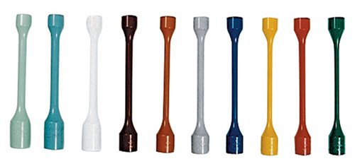

I have 4 Milwaukees.
1/4" Hex & square grive
3/8" square drive
1/2" Square drive.
All are the newer 18 volt Lithium Ion
The 1/2" is 450 ft/lbs.
I think that is under rated / what a work horse.
I too have been using it more than my composite 1/2" IR2131
Just wish it had a variable torque setting.
It is so darn easy to over torque bolt with it at first.
I am going to invest in some pre-set torque sockets.
Accutorq (ACC10-0322) 10 Piece Lug Nut Torque Socket Set - Amazon.com
Check CPO milwaukee for great deals
http://www.cpomilwaukee.com/milwauk...e-m18-impact-drivers-wrenches,default,sc.html
CPO has other web sites like Metabo, Skill, Bosch, Dewalt
http://www.cpooutlets.com/
I have bought mfg refurbished and they work and look like new.

I recommend buying a quality torque wrench (snap on) instead of torque sticks, they are not that accurate.

I have always wondered how these work, it is usually not very clear. Are they simply made to different "springyness" and absorb impacts past a certain point, or what? Also, how inaccurate are they? For things like wheels, wouldn't +/- 10% be acceptable, or are they worse than that?

I have 2 snap-on torque wrenchs 1/2"
Also a 3/8"
OTC 1/4"
I just like to spin bolts/nuts up quick close to torque with a gun and final hand torque always.
The Milwaukee is so darn fast and powerful I have shot past the spec. needed.
I have learned to be quicker with the trigger and short bursts.
With the air gun I would just turn the regulator down
There is no adjustment with the milwaukee, but the portability is great.

They are supposed to kick back at a specified amount of torque. The problem is if you have a good strong impact it can over come the torque stick and over torque. I have seen some wheels torqued in excess of 180ftlb and it was supossed to be 100. With a torque stick there are too many varibles like the operator, impact, air pressure(or I guess now days battery charge), and the torque stick itself. Yeah +/- 10% would be acceptable for a wheel, it is not like it is a internal engine part but at the same time a wheel is a safety matter so I would not trust a torque stick. If a wheel falls off it could kill somebody. These tire shops and inspection stations that use torque sticks also warp alot of rotors. I always pull a torque wrench on a wheel.
