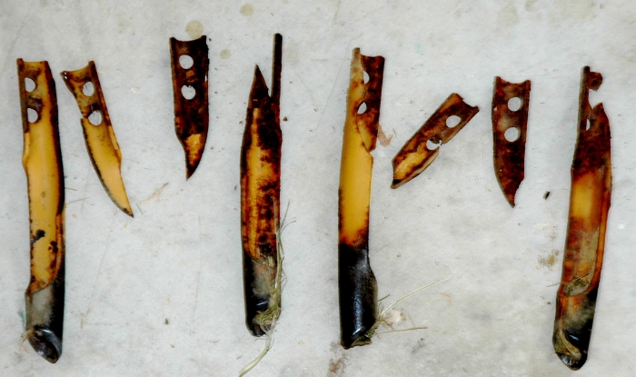

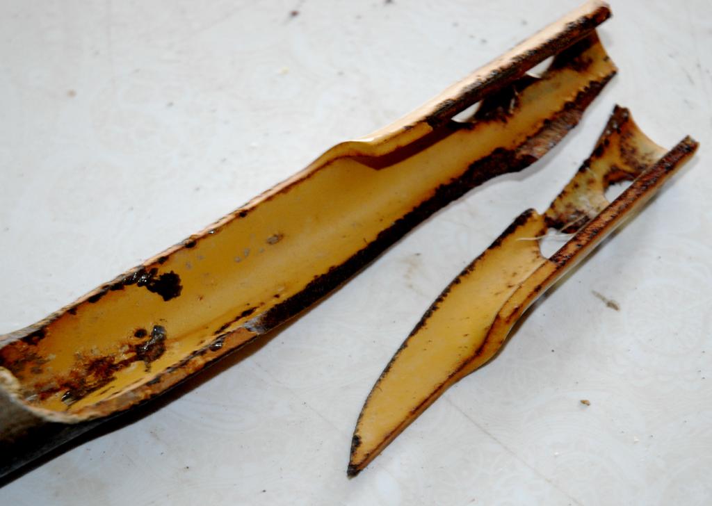

I just bought a used core aerator. It's a Bush Hog MPG 600, and I've replaced about 15 of the spoons because they were actually broke (I noticed this when I bought the aerator). This isn't a big deal, I found aftermarket replacements for $4 each (versus the BH price of about $28!) and they are fairly easy to install. But they way they break is always the same. The shank splits right were the spoon is bolted to the carrier, the split runs lengthwise right were the bolt holes are (I may tru to get some pics later). Anyway, I've noticed another 15 or so of the spoons are showing stress cracks just like this, I'm sure they'll break after another use or two and I'll replace them. But my question is how common is this? Do you guys with aerators see this type of breakage? I had ordered 25 spares, but I'm guessing I need to order another 25 (or more). This aerator is supposed to be about 4 years old, so I'm not too upset about any of this, just curious.

How about posting a photo or two with close-ups. There may be a way to weld up the broken ones or strengthen the existing ones so they can stand up better.
Breaking may also be a factor depending on the ground it is used on. Dry, hard, rocky ground is hard on spoons.

What you're describing is logical, since the spoons are folded, and the center of the fold would have the greatest stress. I haven't seen that in mine, but I only use it on my own lawn, and usually just once or twice a year. I try to do it just a couple days after an extended period of rain in the spring.

Here's a few pics, a close up and one of a handful of them. This aerator wasn't used commercially but the Doctor I bought it from probably did about 10-12 acres a year. I'll be using it on 4 acres twice/year. Like I said, I'm not overly concerned about them breaking, but our ground does resemble concrete when it's dry. I'll just have to choose when to use it carefully. They're cheap enough that it's hardly worth trying to re engineer.

Heck, yah. You could weld those back together in a jiffy. Since they all seem to break the same way the weld can be left built up (depending on the mount) and actually be stronger. But if you don't weld or don't have a neighbor that welds and owes you a favor then buying new might make sense.
That kind of breakage looks to be from excessive torque and/or bending. The two-bolt style tends to make the spoons rigid and burying them in hard ground will cause them to have to dig themselves out on rotation rather than swiveling to ease out of the soil.
Moist and/or soft ground would add a lot of time to the life of those spoons. As you stated, it would be wise to carefully choose when to use the implement. It rains plenty often in Ohio so there should be several windows of opportunity.
Hopefully, you are not located in one of those glacial plains that is mostly bedrock located shallow under the topsoil.
