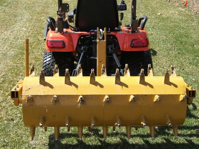

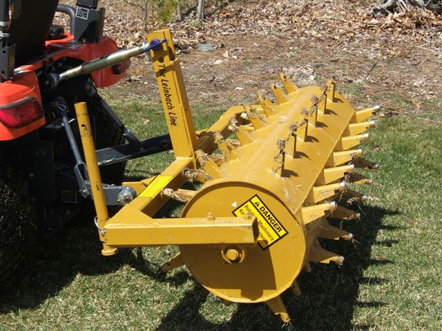

   / Core Aerator #5
I have a woods pl 60, its a tank! Im looking to move up to a 72" make me an offer for my pl 60?
