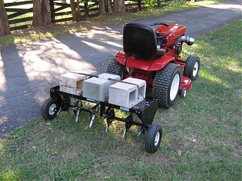

   / Core Aerator #24
This 40" el-cheapo did a pretty good job after I added a 4th cinderblock. I gives a pretty consistant 3" plug and doesn't seem to tear the turf up too bad in turns. I wouldn't recommend it for commercial but seems OK for residential use. And it gives my retired 856 something to do twice a yr too.
