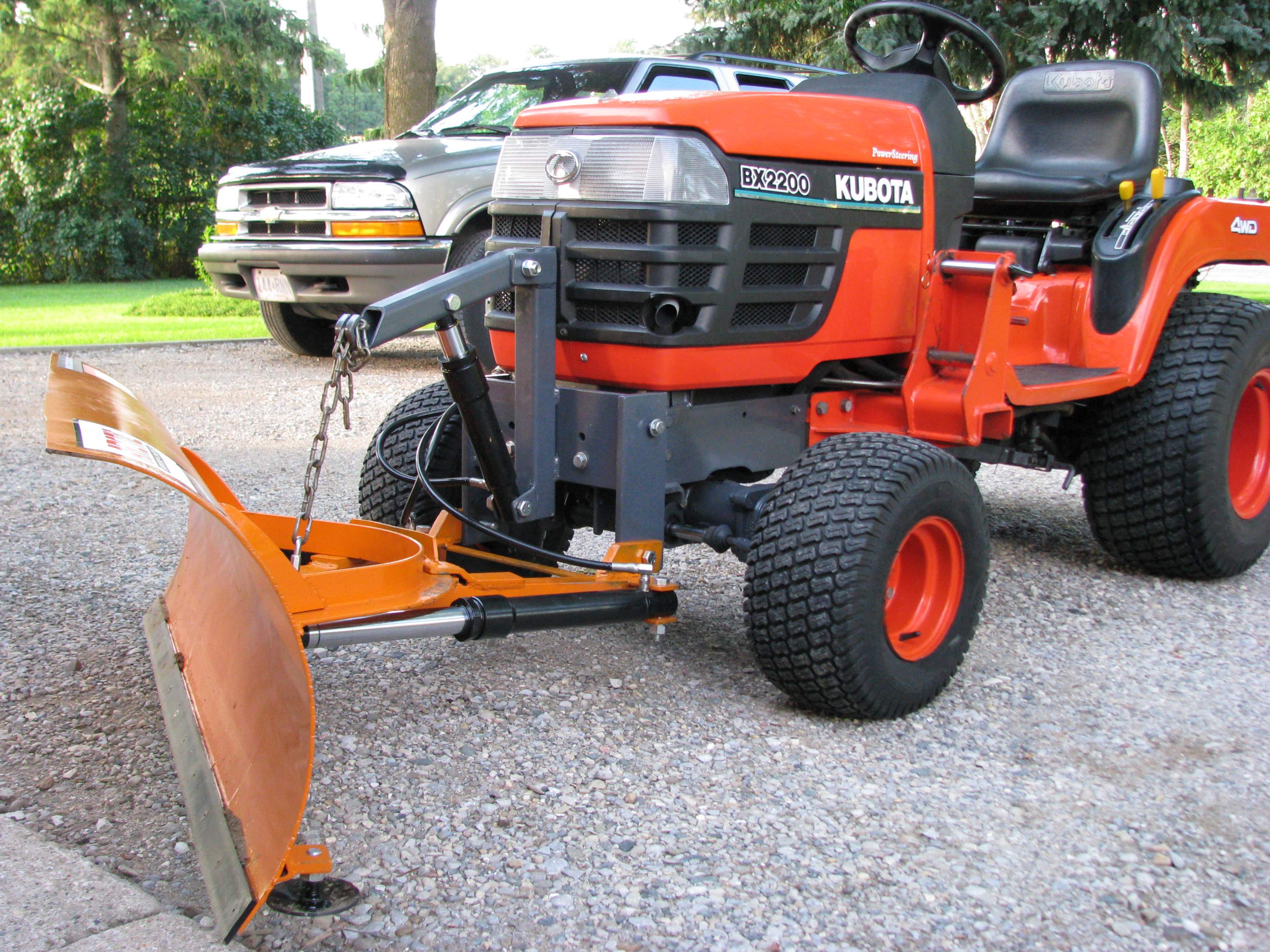

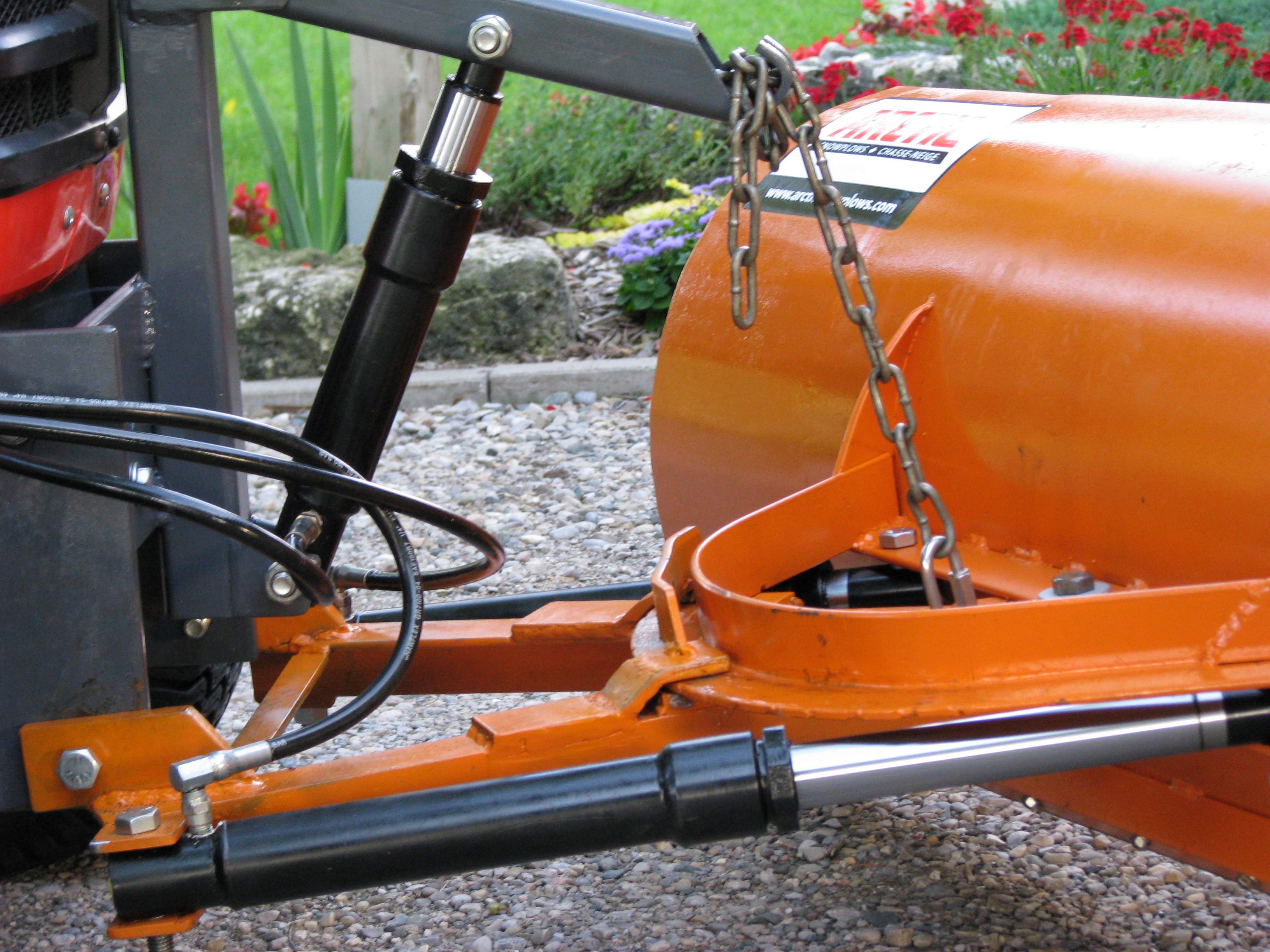

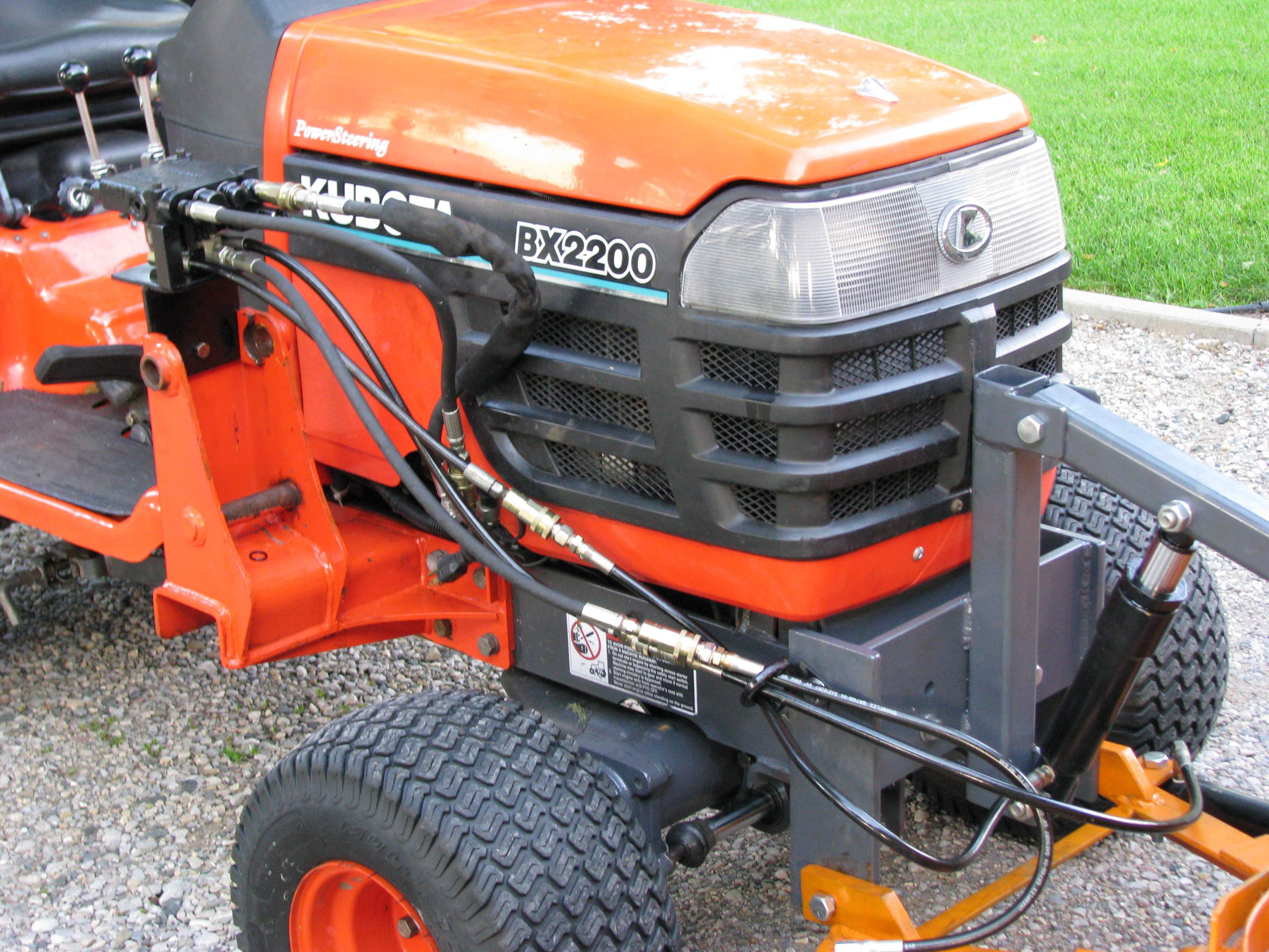

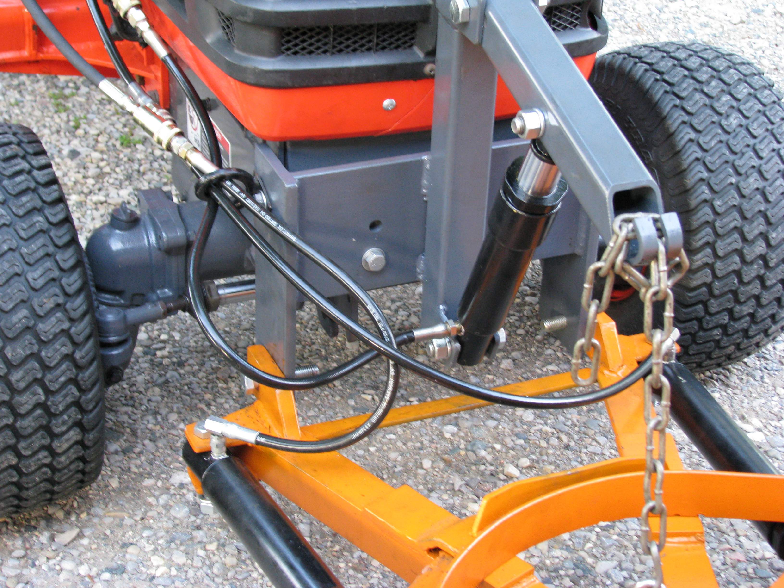

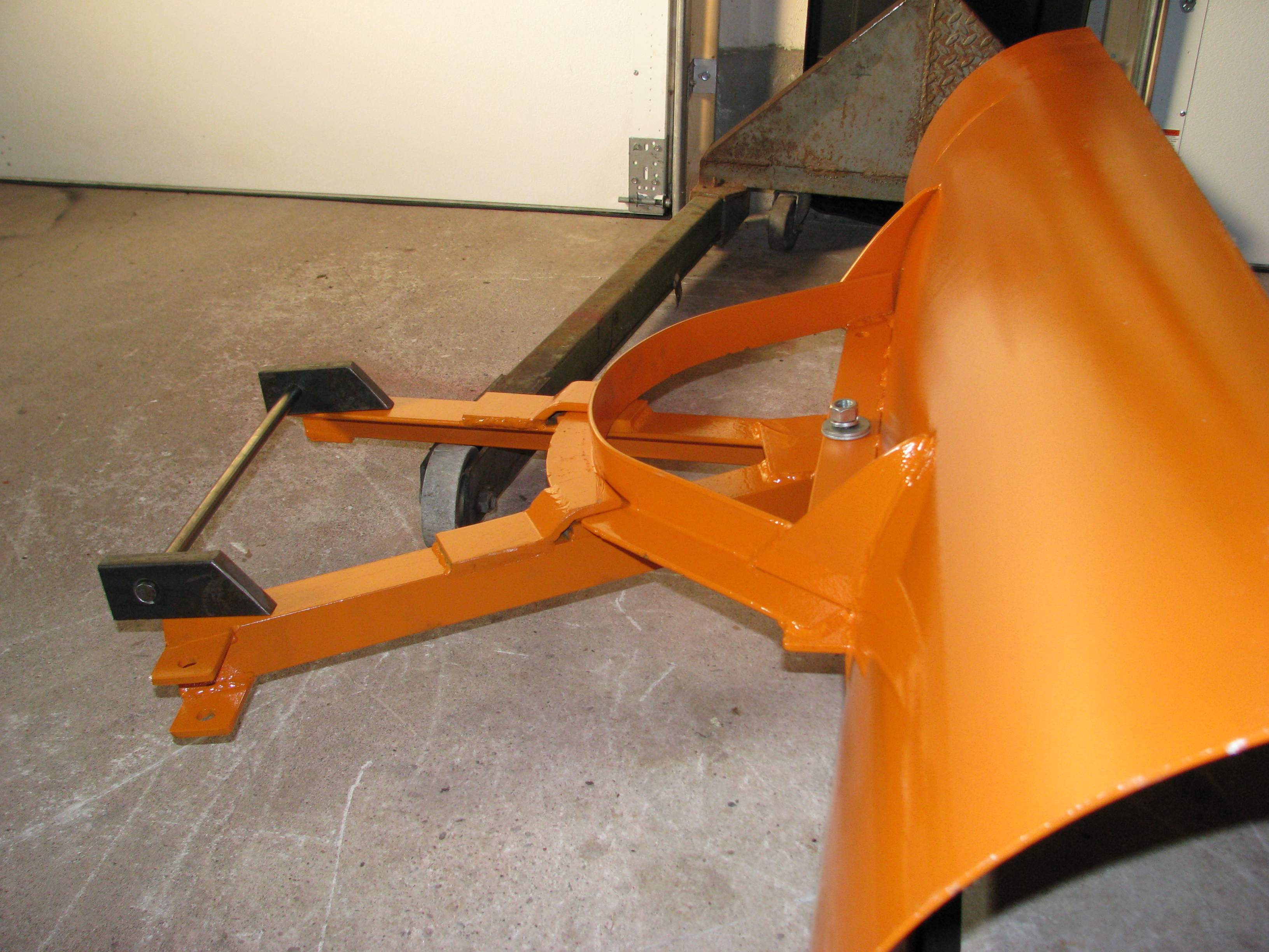

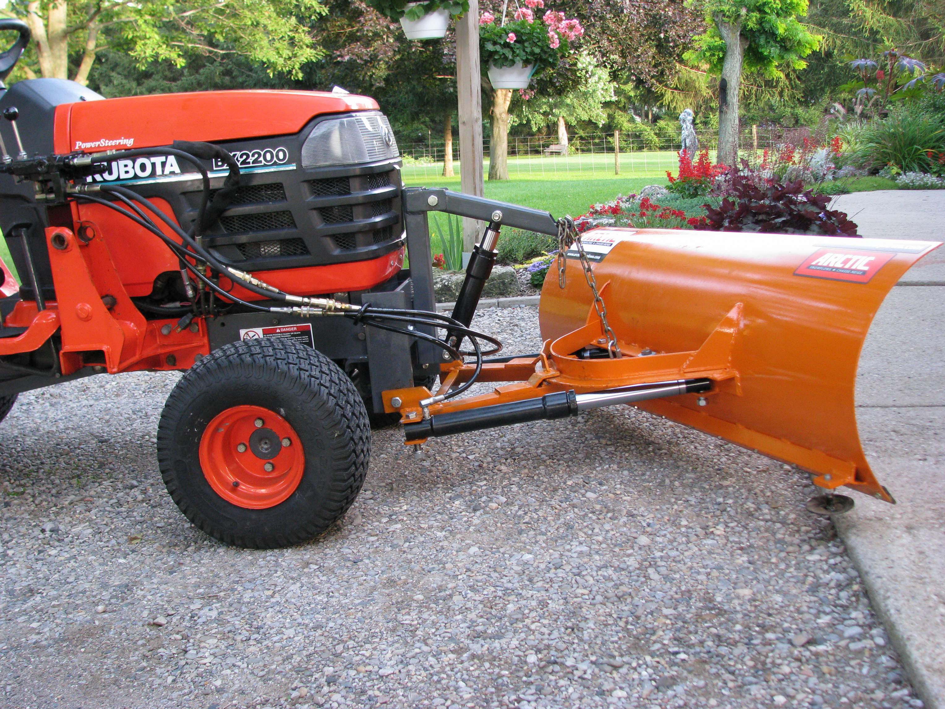

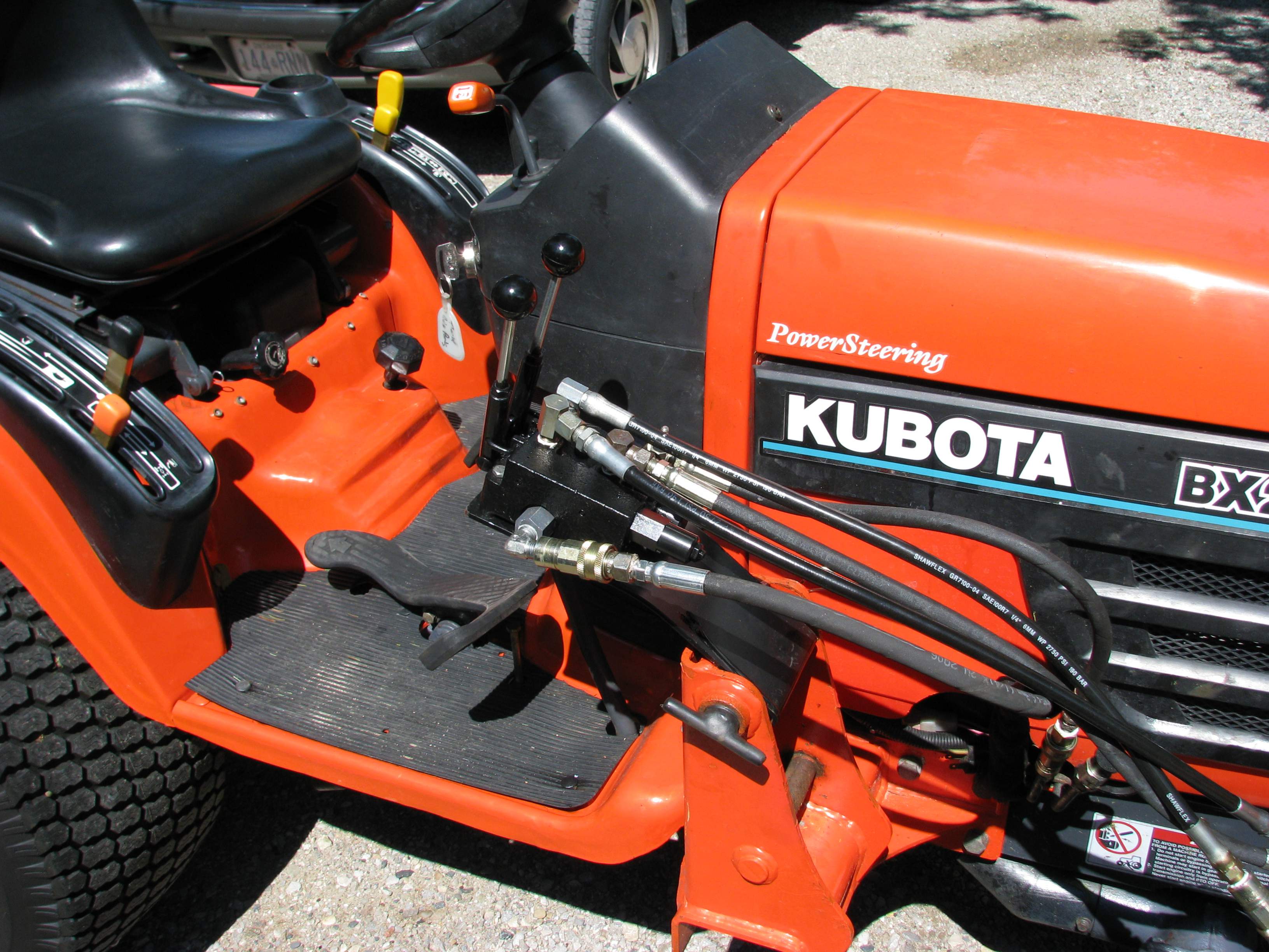

I have a Kubota BX2200D with a 58" wide blade that angles to about 28 deg. that I built about 6 years ago. See the attached pics. You may notice the blade is angled forward. Works great. The valve is from an Old Monarch belt drive snow plow pump set up. I picked up several of the valves at an auction for practically nothing. I don't think anyone knew what they were??

uncleaddy, it looks like you have no "cross over valve" for your cylinders,
how does that work out for you. Or am I missing something again...lol

Yup, your right. I don't have the cross over valve . Don't really need it. The tractor isn't stong enought to bend anything I have hit??
