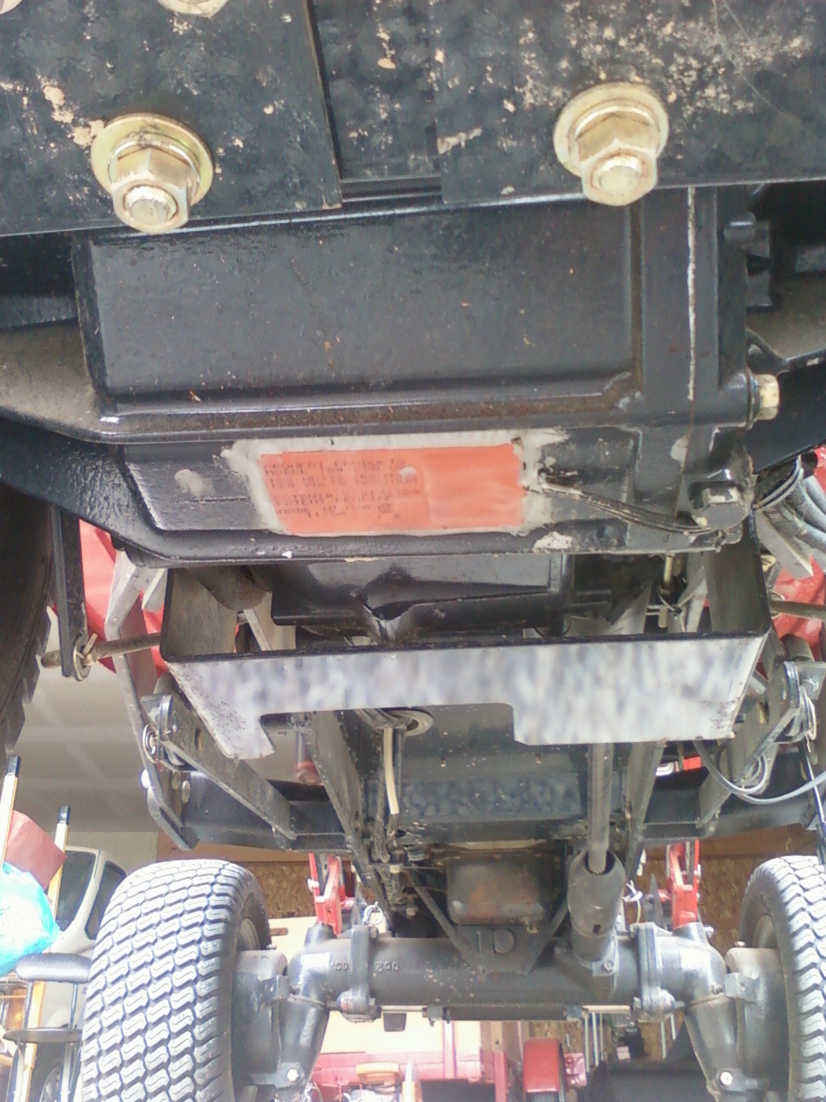

Myself, I added a silicone pad heater to the bottom of my transmission. It keeps the oil from getting cold, and reduces my concern about the warm up time. Overkill? Sure. And, I'm okay with that.
Kat's 150 Watt Silicone Pad Heater Model# 24150 | Engine Heaters Blankets| Northern Tool + Equipment
