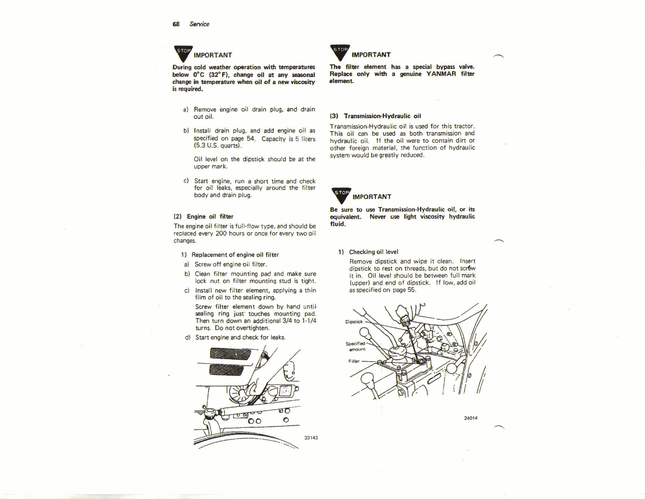

   / Correct hydraulic oil for Yanmar FX32? #12
Out of the 195/240 original operational manual.
   / Correct hydraulic oil for Yanmar FX32? #13
That's right. Measure without screwing the dipstick in or pushing it in. That is and always has been standard.
Mercon and other power steering fluids are hydraulic fluids. That's fine for purely hydraulic systems. But in your Yanmar you have a combination sump serving both the transmission and the hydraulics. One system in this combo has sliding friction and bronze parts, the other has bevel gears, rollers, and impactful straight cut bull gears since in most of them the same fluid also lubes the big rear end gears.
So use a fluid designed for both. J20C is a good place to start. Negative on power steering fluid.
rScotty
   / Correct hydraulic oil for Yanmar FX32? #14
Thanks Winston! That's the closest we'll ever see regarding the engine dipstick.
(For the transmission) "Insert dipstick to rest on threads, but do not screw it in."
For engine oil .... nothing declared.
