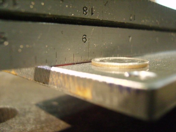

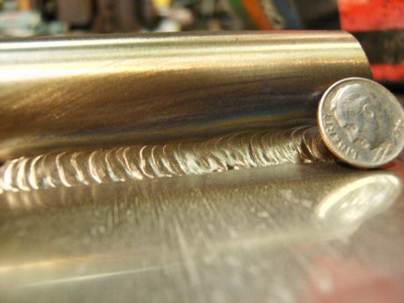

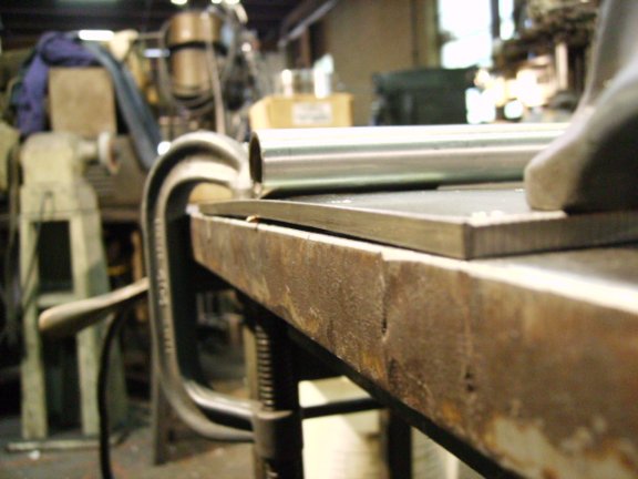

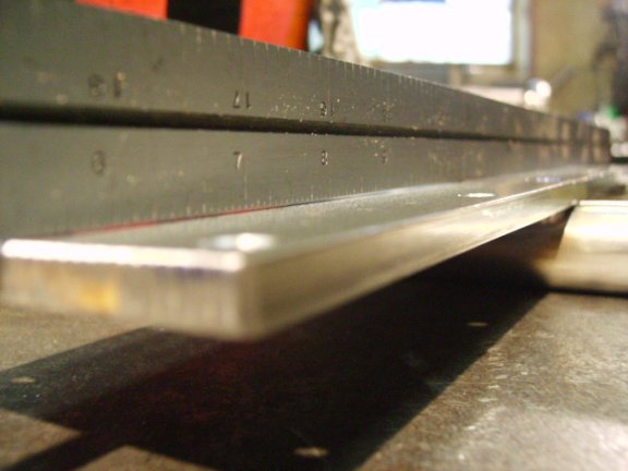

Some times pre bending a project is a big time saver.
I snagged these pictures off another site.

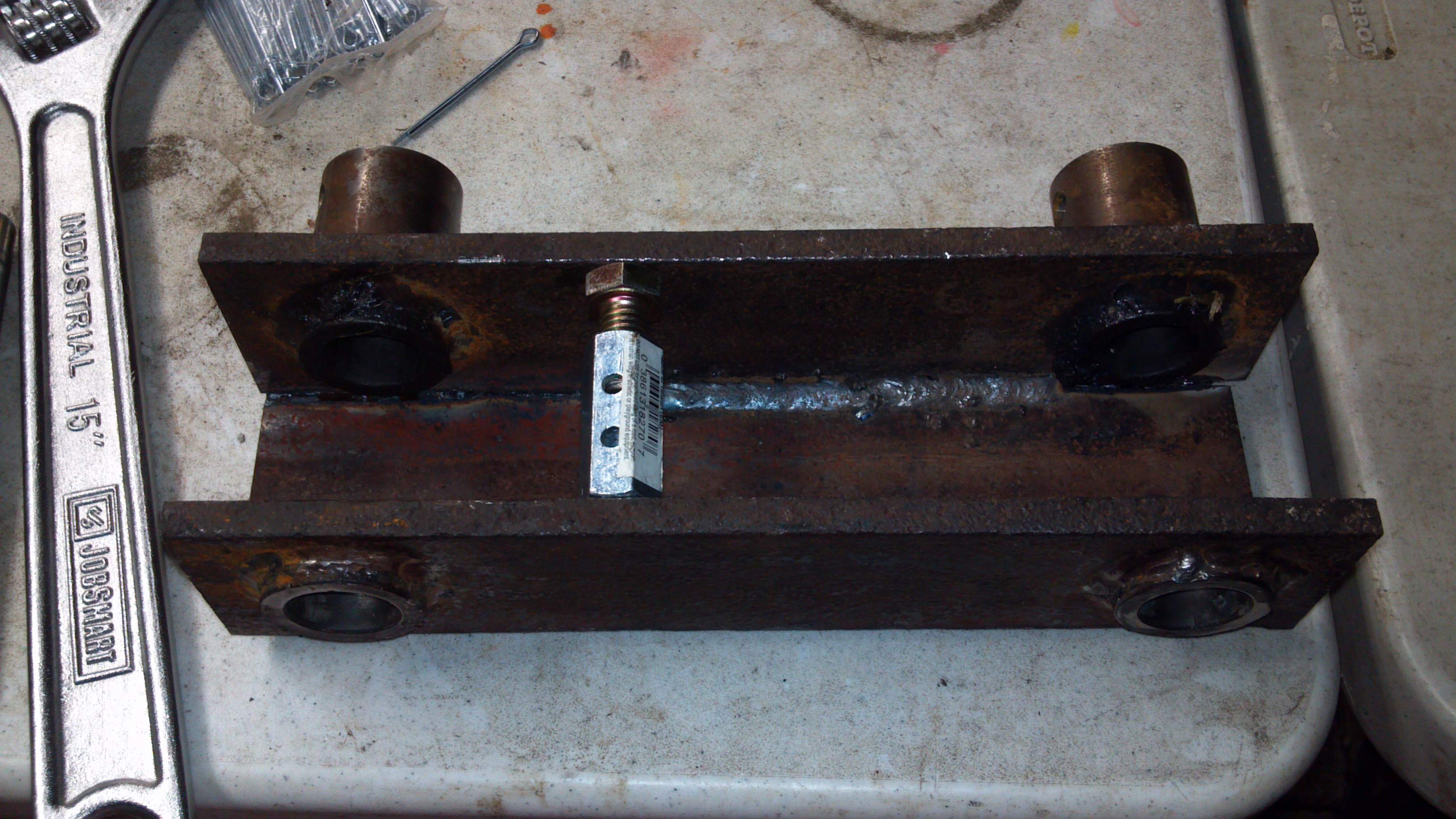

Shield Arc: Here are some pics.
The last pic shows the "spreader" that I improvised to try to get the thing back into alignment. I set the joint up as a totally non-overlapping corner and then welded the fillet on the outside. I also put a single bead down the inside fillet after welding up the outside, more on principle than anything else--it's not relevant to this discussion as the warpage happened before I did that. One thing that confused me was, I expected that the side-walls would pull outwards as the weld metal cooled and contracted, but they didn't at all. They pushed inwards. I can't for the life of me figure out how that physics worked out. What I did was I put pins through the bushings and then used a clamp to pull the side-walls in so that they bound against the bushings. I hoped that as the weld cooled it would pull the walls back out, but it did just the opposite.
Oh, and if you are thinking, "Gosh it's dumb that he put the bushings in first and then tried to weld up the walls. There's no way they'll stay in alignment." Yeah. I figured that out. The hard way. :laughing: Now I am thinking that the right thing to do would be to first weld up the channel and get it all square and true and then cut the holes and insert the bushings, and I'm thinking more generally about how one would get everything square and true in a case like this.
In your example of pre-bending, I'm surprised that would work, because you have stretched the metal, but you haven't made the bend "take". I would think that once you remove the clamps, the tension that's already in the metal would want to pull it back to flat PLUS the tension from the weld would pull it even further. Is that not how it works?
Thanks for the help.
PS: I think I recognize that dime. Is that a 1966?

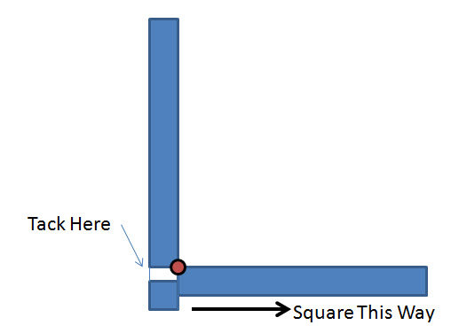

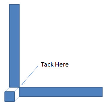

I've been doing some work on a small welding table, and had some ideas about how to help make sure it's square. The table is mostly made of 2" square tubing. For the top, to make sure it ended up square, I realized that I could easily put tacks as shown below, allowing them to act as a hinge and allowing me to make final adjustments to the angles before welding the legs into the corners.

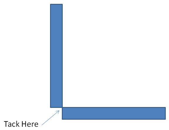

Getting the legs square in both directions was a little challenging. I came to see that the order the tacks were put in was critical. If the tack is put in on the inside of a joint, then the joint can hinge inwards on the tack without breaking the tack, but if you were to pull outwards, it would break the tack. The opposite would be true if the tack was put on the outside of the joint. What I finally ended up with was this.
If the vertical leg is perfectly square, then don't bother with this silliness, but since it probably isn't perfectly square, rotate it so that it angles outwards rather than angling inwards in any direction. Then tack the inside corner. This tack location allows the leg to hinge inward in both directions.

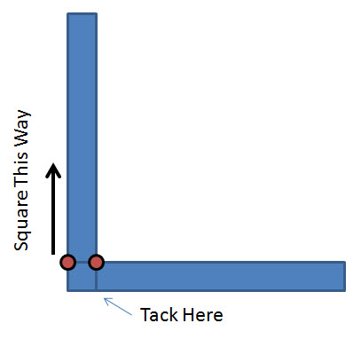

Next square up the leg in one direction and, holding it square, tack the opposing outside part of the joint. The two existing tacks now hold the leg square in the one direction, while creating a hinge that can be easily bent inwards in the remaining direction.
Finally, square up the leg in the remaining direction and tack the opposing outside part of the joint. These three tacks should now hold the leg square to the frame. If the leg is not square in any direction, simply grind out the opposing tack, leaving the remaining two tacks to act as hinges while you square it up.
Hope this made sense, and I'm definitely receptive to any feedback on alternative or improved methods of accomplishing the desired outcome. Obviously, this is a problem that has been well solved by fabricators through the years, and I'm certainly reinventing the wheel. This is the inevitable consequence of not getting formal training.

that weld in the middle is to long as some said stitch it work in short 1" beads
like this alternating sides slowly from the center out.
then fill in the spaces after it cools and is correctly alignment.
_ _ _ _ _ _ _ one side
. _ _ _ _ _ _ _ other side
Another trick for the bushings is to make them go all the way through piece ream or bore to size after welding is done then cut out the center for needed clearance.
