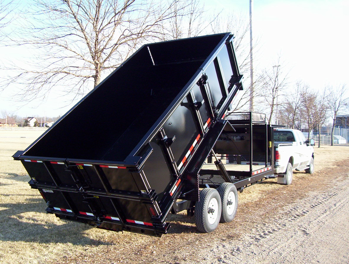

Here is a pic for and idea to build off of. Could make the "box" part removable or do a removable side rail set up. We use to that on old grain trucks.

Dump trailers don't usually don't extend much behind the rear tires, even the flatbed dumping trailers really don't allow you to position equipment or cars as needed. I'm thinking it wouldn't be too hard to make a removable rear extension for use as a car trailer.

Think I have figured out what I am going to do. I am either going to buy or build a car hauler that can be tilted and then fashion some walls for it so that I can also use it as a dump trailer to a degree. I'll just have to make sure the load is in the right place on the trailer. Figure I will make the side walls such that they go right into the stake pockets on the trailer and then fashion the front and back walls so they attach to the side walls.
Essentially, looking at something like this HYDRAULIC TILT CAR HAULER TRAILER PLANS 82" X 19'

I'm all for you building your own trailer but I don't think you'll have much luck dumping anything other than rolling stock (cars, tractors, etc) off a tilt trailer. Look at the dump angles on dump trailers. As steep as they dump sometimes they could stand a few more degrees. A rig like in the last link BCP posted with removable sides would make a much better dump trailer. Problem is you'd need very long ramps to use it as a car hauler.
