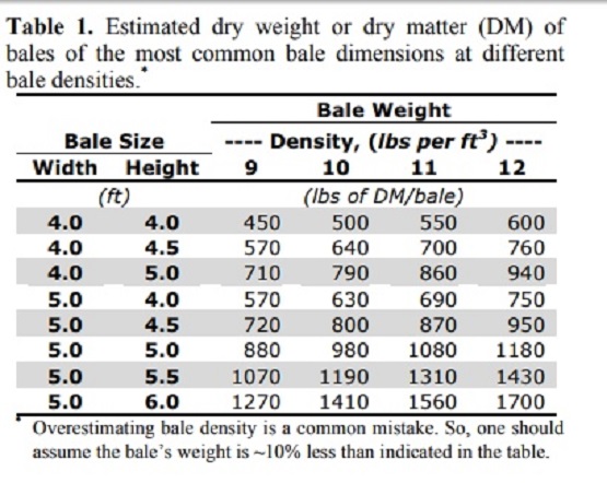

   / Could I transport hay on the arm of a backhoe? #12
For reference a 4x5 round bale can weigh over 900 pounds:
