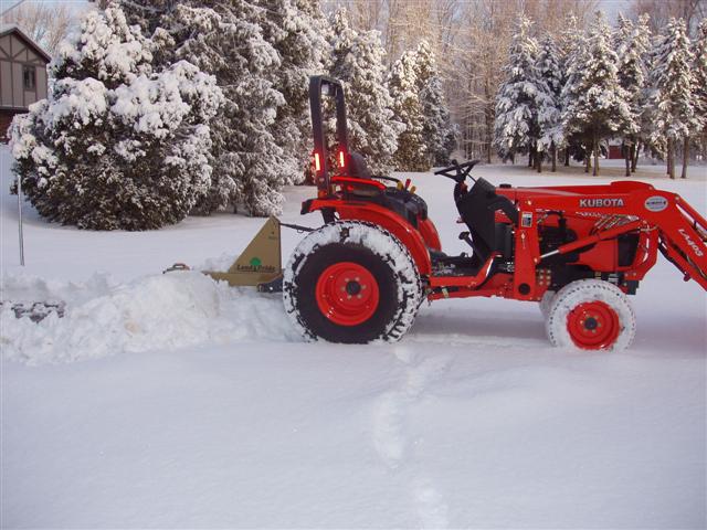

I replaced the folding ROPS on my B3030 just so I didn't have to hassle with folding and unfolding it all the time. Unless you also have a BH the non-folding ROPS is a better option IMHO. It gets under the trees a lot better, too.
If you keep the folding ROPS and use pins to secure it up or down I think you will find at certain RPMs that it will vibrate if not bolted tightly together. While my B3030 is fairly smooth running, at times it develops a harmonic that causes some things to buzz a little. An example is WOT. If I back it down just a hair it smoothes right out. The only time I run at WOT is mowing so the vibes can be quite annoying when running for any length of time.
